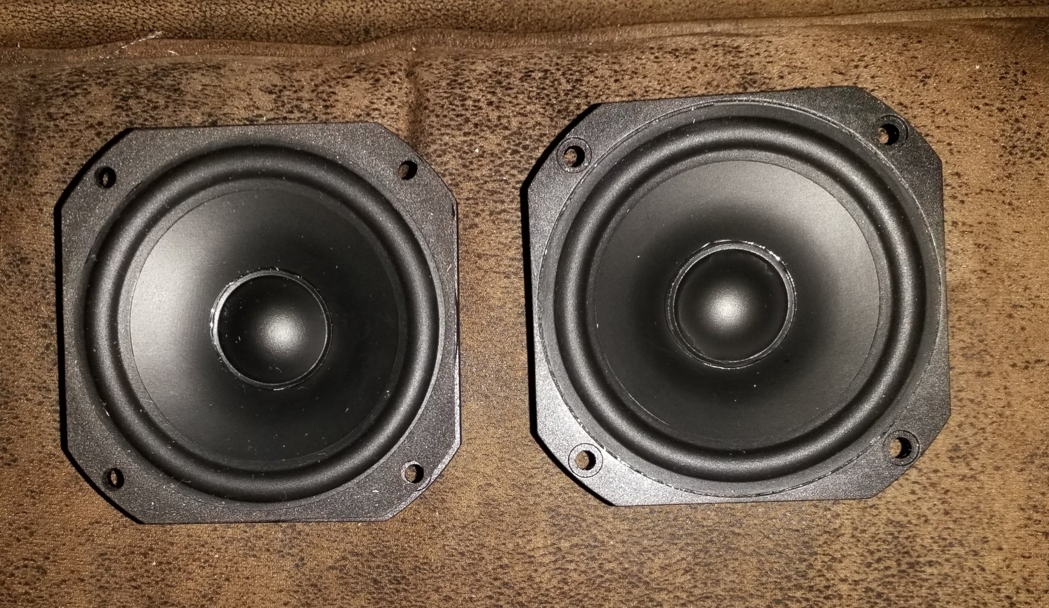

I'm getting a little flustered with removing the thin front foam gasket on my Peerless TC9 fullrange drivers. They don't want to peel off cleanly and the residue is hard to remove from the front flange, plus some of the gaskets are attached unevenly. Many of the gaskets are stuck to the thin fragile surrounds, so using chemicals is likely out of the question to avoid damage ie. isopropyl alcohol is definitely not an option as it harms rubber. These drivers are clearly made for rear mounting based on the presence of a gasket. It looks ugly when front mounting them.
Does anyone have an effective method for removing these things without harming the rubber surrounds? The first one took me almost 20 minutes to completely get off. There are over 50 drivers to do and I'm going to grow a beard faster than I can get the job done. Any good suggestions?

Here's a before and after picture. Its a thin closed cell foam gasket that isn't bonded evenly and tears easily, so its almost impossible to remove without dealing with a million tiny pieces. It almost behaves like a failed crumbling foam surround. It wouldnt even be so bad to leave the gasket there, but some are installed sloppy so its not very presentable. Pretty stupid.
I wouldn't really be comfortable with WD40 being a mineral oil based substance, using it on rubber. Thats usually a no go mixing the two. I may try some ethanol ie high proof vodka or rum.

Acetone or brake cleaner are usually very good for dissolving these kinds of glue. If you are afraid of possible negative effects on the surrounds, maybe use a cotton tip to apply just where it's needed. Let it soak a moment and use a sharp razor blade to scrape it off. Steady hand required...
The picture proofs you can do a really great job! 😀 It just takes a bit longer...
I've removed the gaskets (but was less worried about a clean appearance) once and did it with a sharp razor blade, basically scraping it away.
Tedious job but I don't remember it taking a really long time. I could 'roll off' residu glue using my fingers.

I removed it without any solvent. As Wesayso said, it can be done but it is tedious. I just pealed it of with thin plastic spatula and cleaned the groove and parts of surround from glue residue with toothpick. On all 6 pieces of TC9 that i own. Put on some podcast and clean just one today. One by one, it has cumulative effect 🙂

Thanks for the input guys. The break cleaner and acetone are definitely a no go being incompatible with rubber. Vodka seems to be working decently enough without hurting anything. Isopropyl is also too agressive. Hexane would work but its really bad for you.

I was going to say "don't worry, butyl rubber is very resistive to solvents", but from your photo the surround looks not rubber, but foamed polyurethane. It's usually called "foam rubber", whuch is plainly wrong and confuses people, because suurounds are usually made either from "foam" or from "true" rubber, i.e. polyisobutylene-isoprene. It resembles polypropylene, which is known for it chemical resistance.
I would still use solvents. Soak gasket from outer edge with xylene, acetone or ethylacetate using syringe. The surround will probably absorb some ethylacetate too, will slightly sag and wrinkle on the outside, but it will return to original properties once dried. I regulary glue foam surrounds using polychloroprene adhesive, which is synthetic rubber dissolved is ethylacetate.

Can you post a close up picture with the section of adhesive / foam visible as in the 'O' part of an 'O' ring?
That may give a clue as to its composition, which will tell us about suitable adhesives used.

Proper solvent (although scary, be careful) is Toluene or Xylene.
Apply the least amount possible so it only wets the area you want to remove, rubber/foam will absorb it, swell, weaken, adhesive will soften too, and in that state you can remove it, bit by bit.
Somewhat slow but way faster than working "dry".
The beauty is that those solvents are very volatile (in fact you will have to keep applying it with a wet Q Tip) so evaporate quickly and fully.
Swollen rubber will return to normal.

While the exact type of rubber the surround is made from is unknown, I'd highly suspect its butyl based on the feel and appearance.
Nitrile and butyl are not compatible with isopropanol. I know this from working on open real tape machines. I was trained on the Revox A80 and others,, so there were strict guidelines for dealing with rubber components (I own an A80 myself). Hexane was the preferred solvent to clean pinch rollers and other rubber parts. If the PR was glazed, we'd use a short treatment of acetone to remove the glazing. Acetone is really strong stuff on rubber of all kinds. United Recorder made a specific solvent for cleaning the tape path and pinch rollers. The key ingredient in it is hexane.
The gasket foam.feels alot like foamed rubber and not urethane. That maybe wy its so stubborn. I may try the focused pinpoint heat method. Slight possibility I have to sacrifice one driver to speed the process up to a reasonable pace. If it doesn't speed the removal up, I might rear mount the drivers after all.
