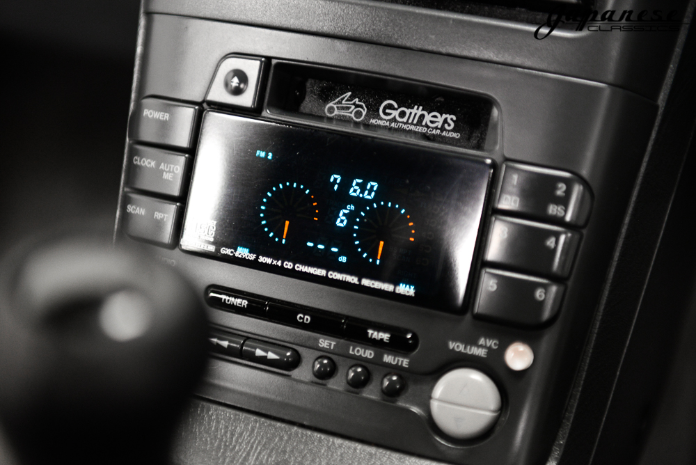

It's a very curious radio - car model specific actually so no '1 DIN' or '2 DIN' radio could ever fit without sawing an inch or two off each side. 🙁 Some owners in Japan have made consoles to house 1 & 2 DIN radios but they look...well, they look really hack.
This is stock and to note, the car was never designed to be anywhere in the world other than Japan:
Note the size of the cassette door vs. the whole width. I measured the actual radio chassis at 5 inches and the balance is just overhanging plastic to match the curve of the console.
Perry, excellent point regarding the display, thank you. I honestly don't know but I can check it out - and I guess that would be a bit of a deciding factor for sure.
It is completely electronic - the tuning that is. There's no knobs even though in the picture there appears to be a knob (there are two), they're actually just push-button toggle switches.

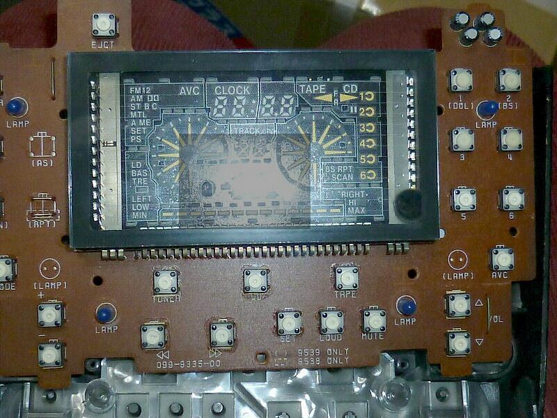

Hi everyone,
Here's a picture of the display board and as they are using the clock display to handle the frequency too, well, at least there are enough segments to handle the task.
I wouldn't know how to make the thing go but maybe it would just go on its own if and when it hit 100.1+ ? So first to solve the range!
