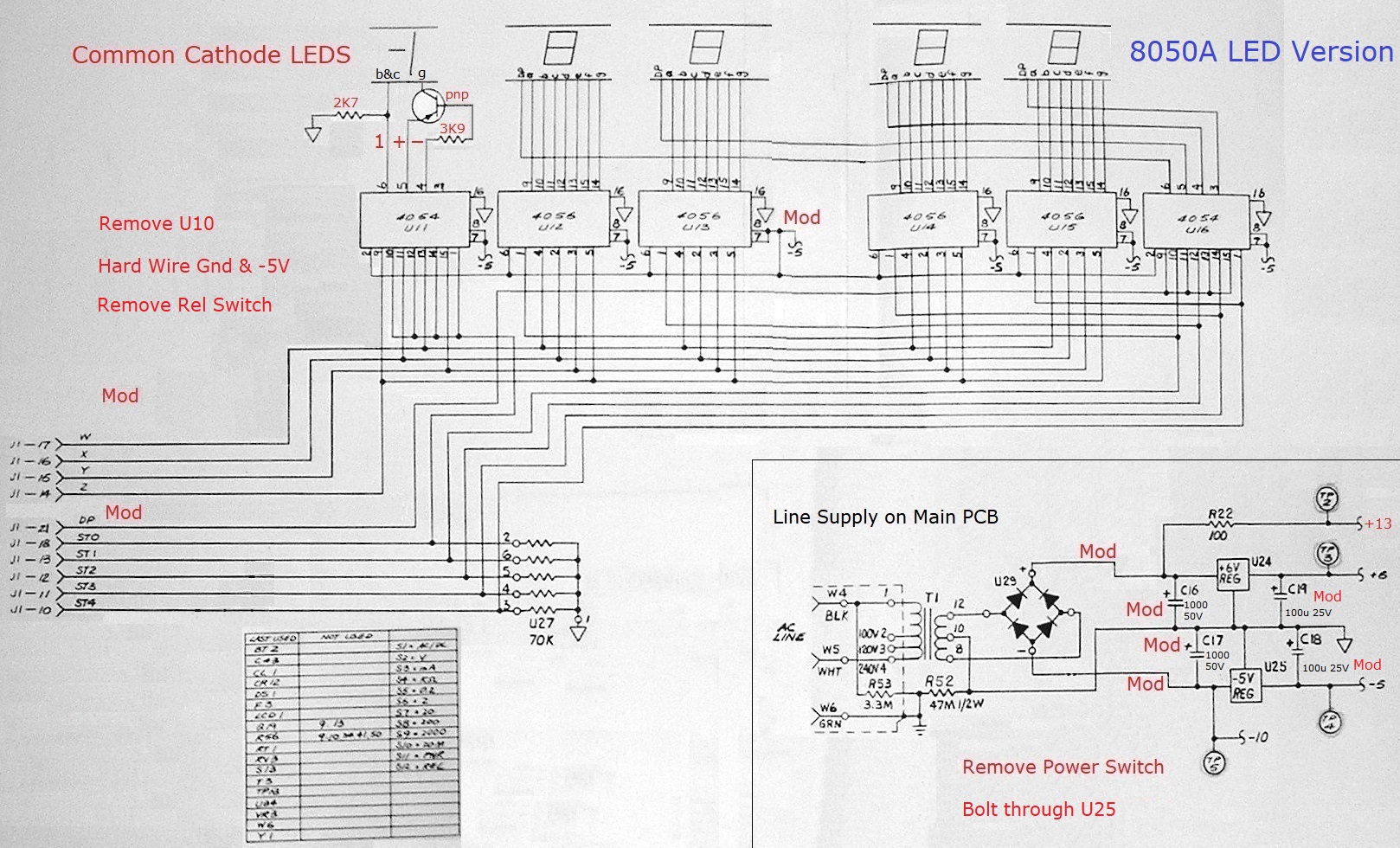

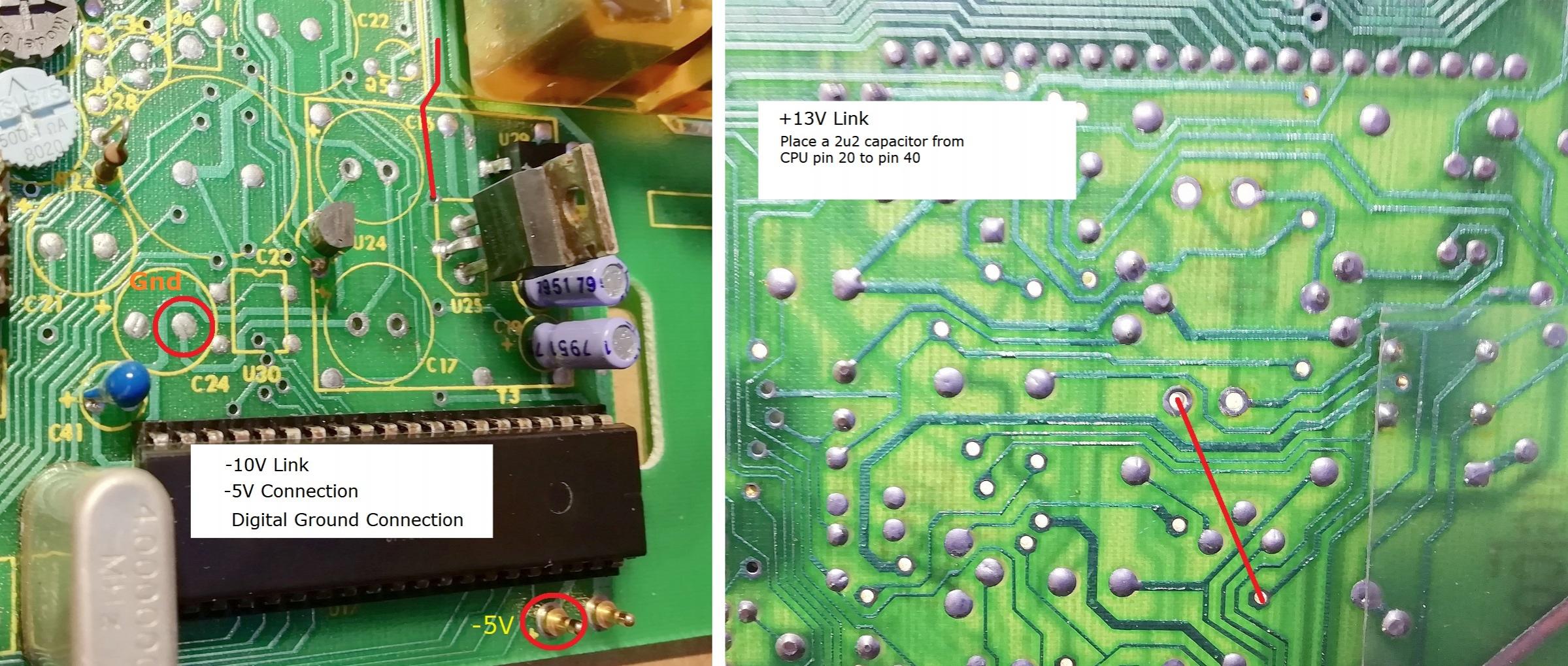

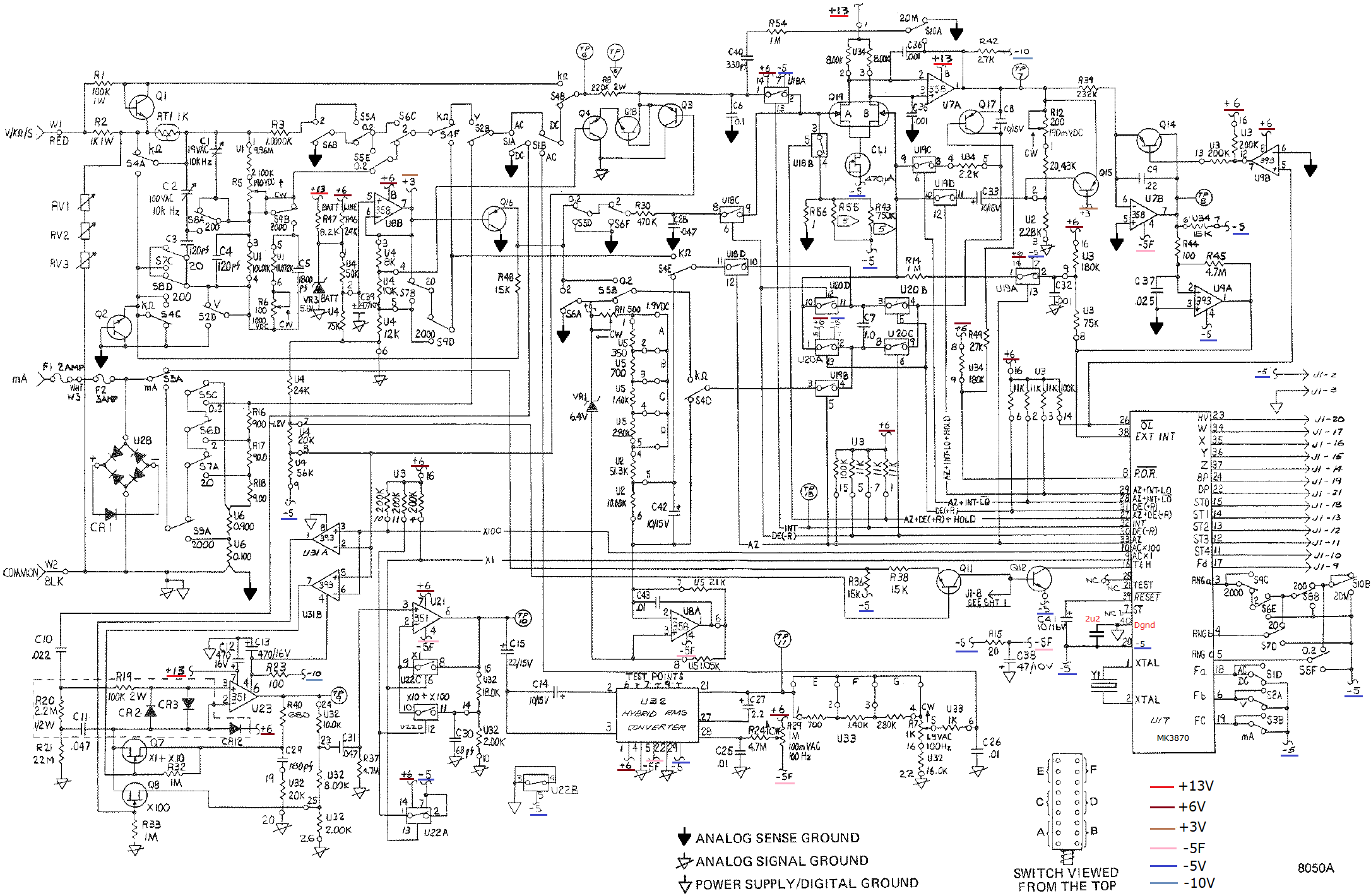

photo of a Fluke 8050A I converted to LED's
forty wires! the 7805 regulator gets a bit warmer so put a small heatsink on that (20mm bolt), increase size of unregulated supplies capacitors to 1000uF (reduce ripple),
the DP's and the -ve sign work, didn't bother with the other indicators,
didn't like the power on/off switch because it runs the unregulated supplies right through the main PCB and the display PCB to get to the switch and the line transformer is always left on, wasn't bothered about relative measurement so the Power and Relative switches have gone,
I used common Cathode LED's and no series resistors! the leading "1" needs a little help from a pull up resistor to get the brightness right, the -ve sign needs a PNP transistor to work properly,
be careful working near the CPU chip, its very close to the unregulated supplies,

PS. the ten LED Common Cathode pins (two pins per LED) are wired to the -5V line,
wire count:-
segment wires 4x7 + 1x3
decimal point wires 4
Common Cathode wires 5
hard wire -5V and DGnd lines from main PCB to display PCB, wires 2
wires between main PCB and display PCB, W,X,Y,Z,DP,ST0,ST1,ST2,ST3,ST4, wires 10
break the unregulated lines to prevent them leaving the main PCB, break the BP wire connect it to the -5V line on the display PCB,

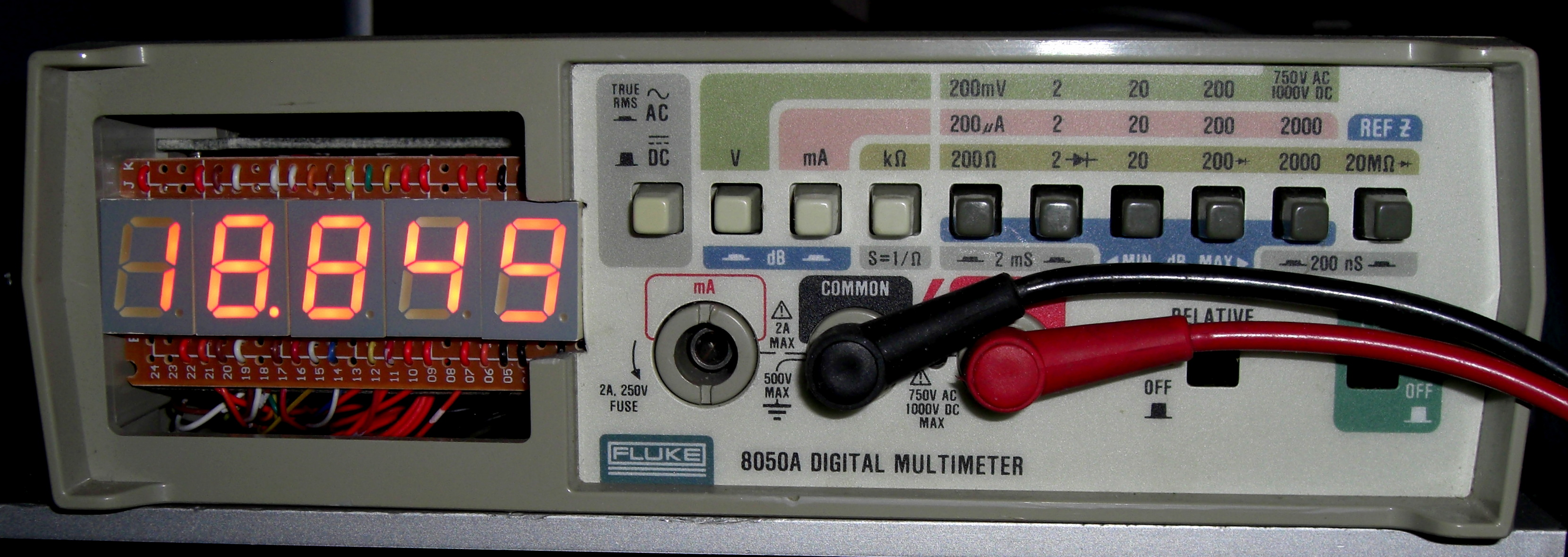

Thanks very much Rich for your very helpful 8050A LED mod info. After inheriting an 8050A with a faulty display I found several LED mods online but yours appealed with common cathode LEDs and absence of series resistors.
Following your notes I successfully modded my 8050A so thanks! If you happen to see this post could you assist with an issue I had with the PNP "minus" driver. I was unable to get this to work and wondered if you could provide any assistance?
Here is my completed 8050A:

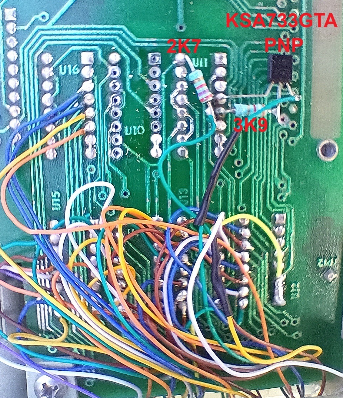

Thanks for your kind comments. I will explain referring to the mod circuit attached and the photo attached in case there's a misunderstanding somewhere.
-U10 is removed
-all 7seg common cathodes are connected to 0V, 7seg Anodes are pulled down towards -5V to turn them on, current limited by the CMOS IC's
-BP signal from J1 is cut/removed
-Pins 2, 7, 8 of U11 6, 7, 8 of U12 6, 7, 8 of U13 6, 7, 8 of U14 6, 7, 8 of U15 2, 7, 8 of U16 are all connected to the negative 5V (-5V) supply.
-Pin 6 U11 is connected to most significant 7seg segments b and c. The 2K7 resistor between pins 16 and 6 of U11 adjusts brightness (leading "1")
-The leading "1" lights up when pin 6 is low (-5V)
-Pin 5 of U11 I call + sign is connected to the PNP emitter that way the - sign can only display when pin 5 is low (-5V)
-the PNP collector is connected to seg g of the most significant 7seg (the middle "-" segment)
-the PNP base is connected to pin 4 of U11 via a 3K9 resistor
-the PNP transistor is a KSA733GTA (or just A733) its a low current high hfe PNP transistor
When the "+" pin 5 is high it keeps seg g off, current flows from emitter to base keeping base close to 0V and seg g off. When pin 5 is low seg g is directly controlled by the "-" on pin 4. When pin 4 pulls down to -5V current flows from seg g through the forward biased collector base, through the 3K9 resistor and into pin 4 which is at -5V so the - is directly controlled by pin 4 and its brightness is set by the 3K9 resistor.
If you want you can leave out the PNP but the - sign comes on when you don't want it to.
Hope that explanation is correct and it helps you get it working. The attached photo I took this morning confirms the circuit mods.
Good luck
Rich
