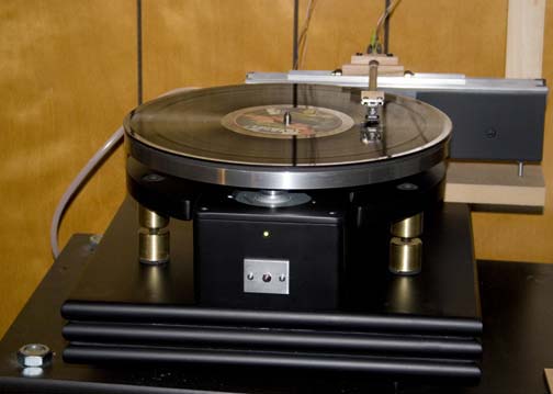

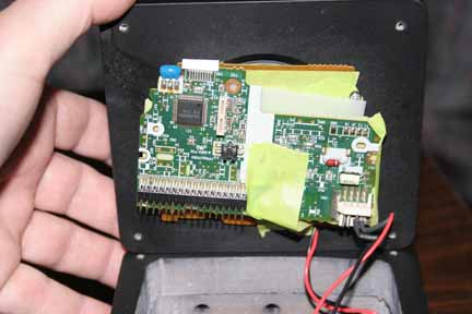

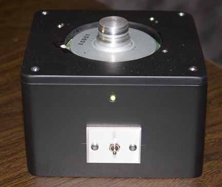

The floppy drive motor seems to work fine and has some decent power. I thought it would be easy to stop with my finger, not so. I’m using 4 AA Nimh.
My econo setup, pioneer platter, Grado.

Managed to get a floppy motor too spinning constant. But have to lathe a pulley with the right diameters, was'nt able to regulate the speed electronically. Took a motor with the least play of bearing, combined bronze/ball bearing btw.
The floppy drive is still working as it should and the pitch sounds correct to my ears. The record anvil weighs 445 grams, I’m thinking about changing to a lighter gripper type.

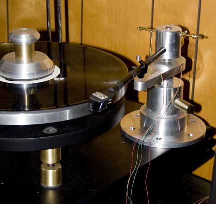

I’ve abandoned the Paul Ladegaard air bearing tonearm in favor of the unipivot. My thoughts on the Ladegarrd would be tonearm wires. The wires can be a real pain to deal with. I think the low compliance cart is the better choice for the Ladegaard arm.
The unipivot makes me smile, it’s so simplistic in design and plays superbly. I’m still in need of a cueing mechanism.

For now I’m satisfied with my econo tt, it is what it is……

BluesMagoos: do you know at what speed the floppy motor turns? I want to use my floppy motor and calculate a pully for it. Did you use 2 pulleys, or made a speed switch?
Floppy rpm is 300.
One speed pulley for now. Two-speed pulley is my plan. I ground the convex profile onto my cutting tool, a real time saver
I had planned on leaving my pulley diameter a few thousands over but when I finished it was only .0005 over. I wanted a little fudge margin but it didn’t matter, I believe the pitch is spot on. Two small drops of super glue and it’s locked on.

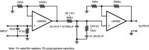

Yes modding never stops. I have build a tube phono and pre, but not perfect satisfied with the sound. To much 2nd harmonic to my taste, it covers up the real ground tones. Am thinking of a simple IC phono stage, balanced, like schematic on the datasheet of LM4562 opamp.
