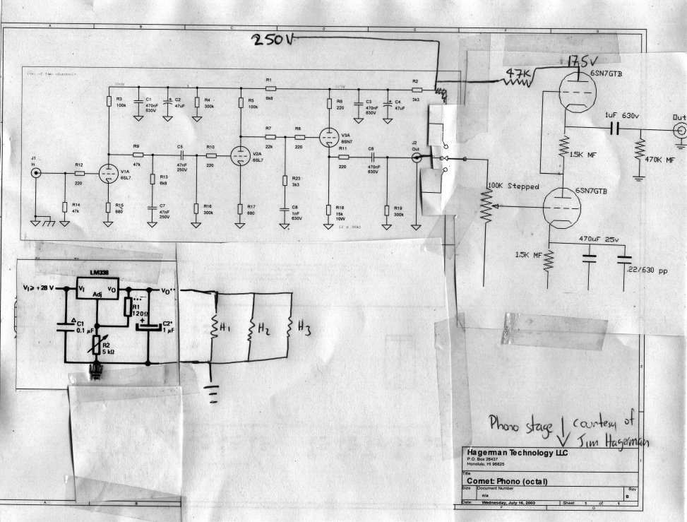

Take a look at the voltage divider circuit for the floating heaters on my latest contraption:
http://bb.sicomm.us/diyAudio/6SN7_SRSE_linestage/6SN7GT_Linestage_v1.gif
This will give the heaters about a +50V bias (around +30V with a 300V supply) above cathode potential and does two things; 1) satisfies manufacturer's ratings and 2) lower any hum you may have by at least 20dB by reverse-biasing the hum causing junction.
It's good for most totem poles, except the ECC88.
Cheers!

Re: heaters are grounded
Of course I am pleased that you have improved the amplifier, but I still think that you are approaching the problem from the wrong end!
The heater element, insulation and cathode form a "diode" which should be turned off. The way to turn this off is by making the heater positive with respect to the cathode. Even if my cathodes are at bias potential only, I generally run the heater supply at a minimum of +20V - RCA recommended +40V in their applications book.
So if I were running say a cathode follower, mu follower etc., with say the cathode at +150V, I would arrange to sit the heater supply on +190V or thereabouts.
7N7

ok what now
Hi Guys and thanks.
I wish I had of known re this before i built my pre amp!!!.
I am including schematics for the heater supply and the preamp.
B+ for the line stage is 165V (I will increase to 175V).
Now it seems that i need to rewire the preamp so that one tube is the lower half for each channel and one is the top anode. Otherwise we will have the same problem if the one dual tube is used for upper and lower halves of the preamp.
I can access 250V in the preamp( I have a seperate psu with umbilical chord).
The pramp I have also has the jim haggerman riaa phono stage (using 6sl7 and 6sn7) I assume i will have to provide an elevated voltage to the heaters there.
SO my question(s) are
1. Does using one tube for left and right channels of the top half of the srpp and the other tube for the bottom half affect seperation between channells
2.I will need a voltage divider for the phono stage heaters and then the srpp.. any hints there as to values
3.does the fact that a diode is created twixt the heater and cathode matter and if so how does it manifest?
4. is my setup with the reduced b+ to place the heater voltage pd to within specs going to work long term assuming i cant easily replumb the power supplies
I have attempted to include a hastily assembled schematic of my preamp depicting the 3 basic systems. The haggerman design is the property of Jim Hagerman. The srpp schematic is of unknown origin but i acknowledge it is someone elses work.

I have been using a preamp with 3 SRPP stages per channel for 10+ years. One half of each tube is for the bottom and the other half is for the top of the SRPP stage. The B+ voltage is 350V and one end of the filament is grounded. The filament voltage is LM317-stabilized DC. I haven't experienced any problem so far; it is dead quiet.
