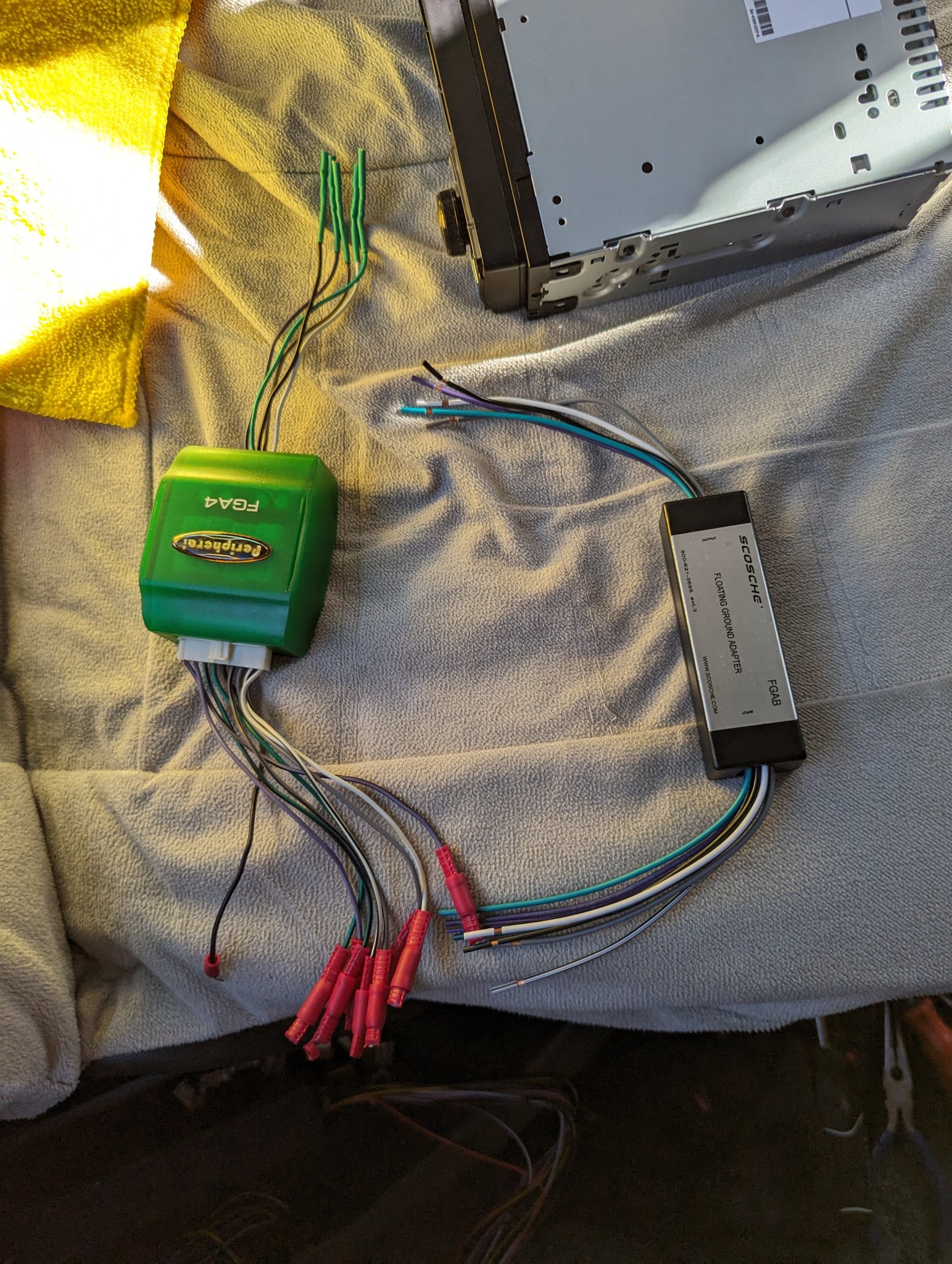

Side note: The Scosche FGA is very simple and only has some capacitors inside it. I initially had a different FGA: Peripheral FGA4. It had some extra parts in it (transformers?) and would actually produce heat! The Peripheral FGA worked just fine without the amp, but would not output sound at all with its input ground disconnected. With the amp, it would get quite hot with the input ground disconnected (and same non-working fader/balance), and with the input ground connected had the same problem with the sound going mainly to the FL and RR. I like the new Scosche one since it doesn't produce heat and waste energy. But I included this info as it could provide some clues.

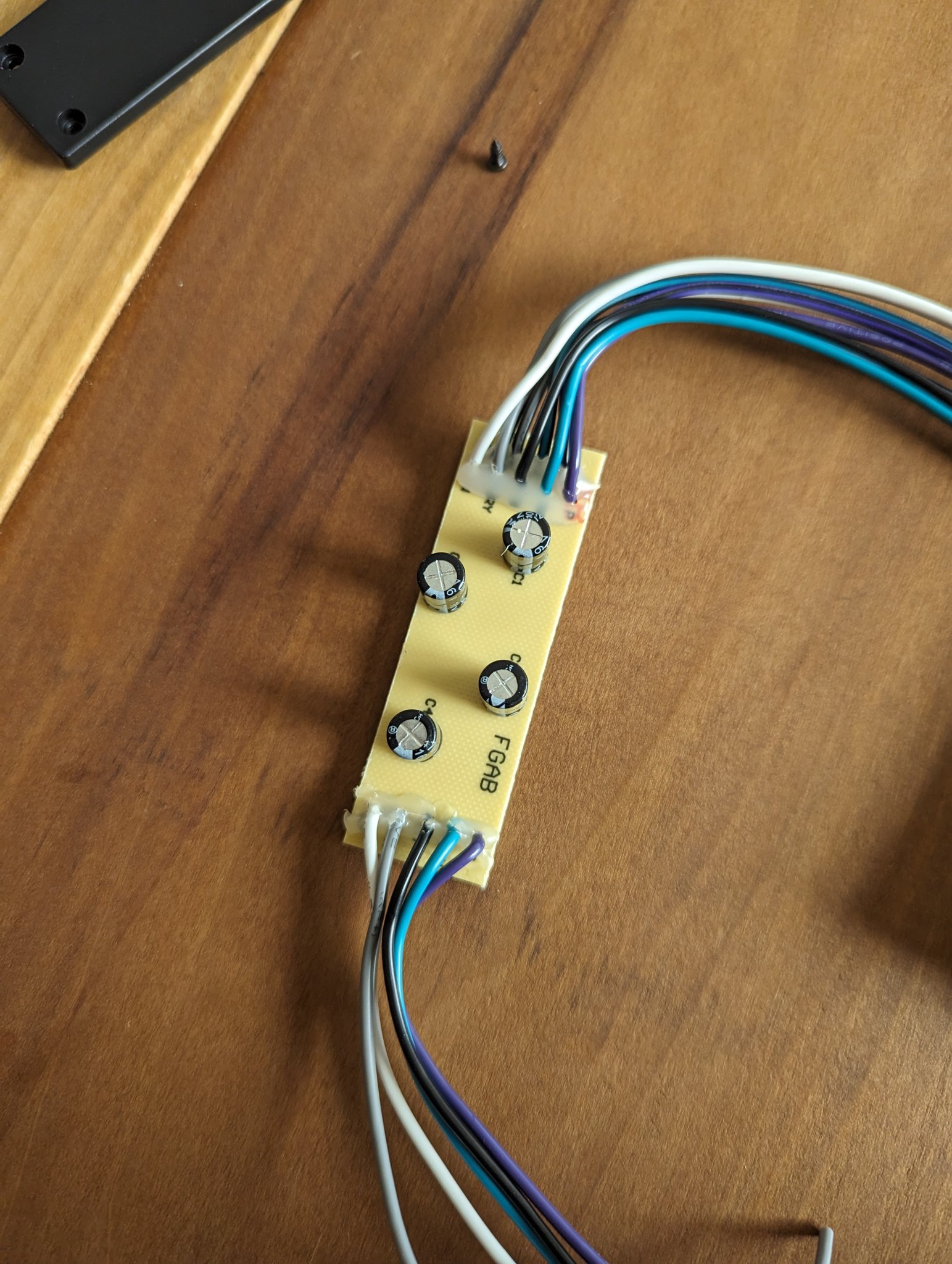

@Perry Babin , here you go!
Last pic is of both the new FGA and my old one (which was more complex). I have a multimeter but no scope.

What are the values of the capacitors in the FGA?

I will open up the FGA and let you know about the capacitors after I fuel up, I can barely think 🤔.
