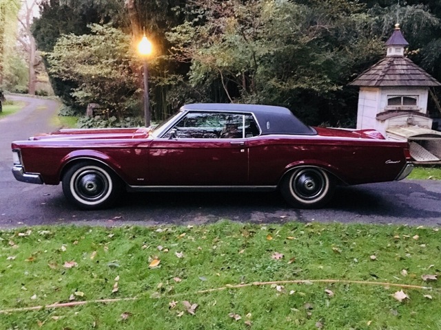

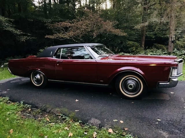

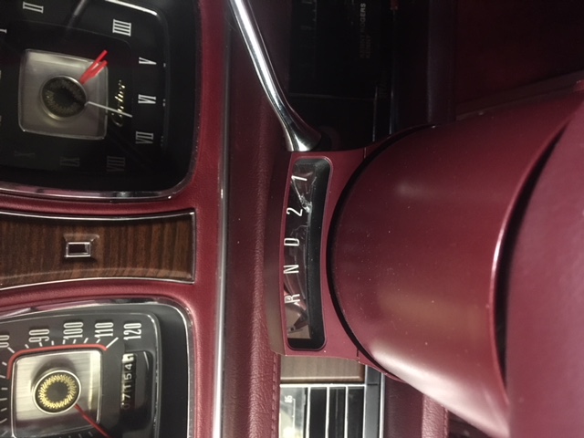

Here's a couple of photo's of the car. It's a time capsule. Still has the original tires.

That's it!!! Wow, brings back memories. That's a huge 2-door car!

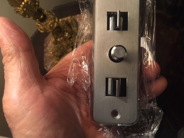

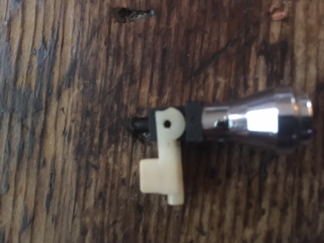

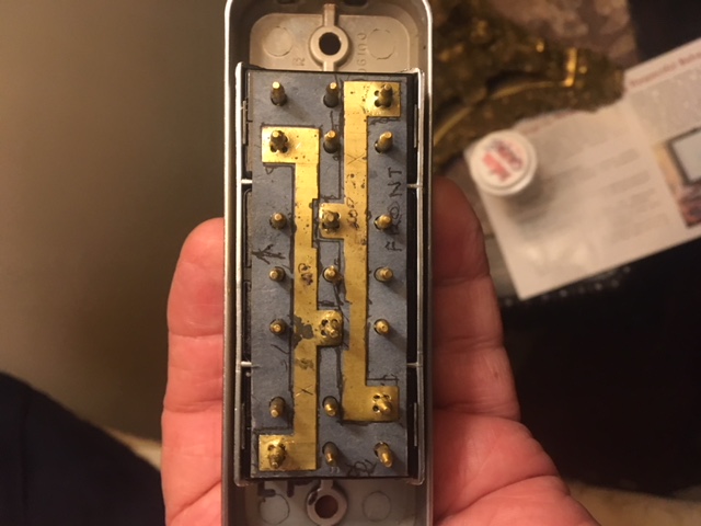

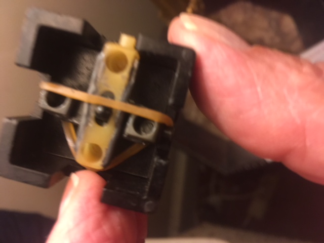

My mark doesn't have the auto dimming option. Everything functioned with the exception of the center toggle of the drivers side 6 way seat. The forward/aft function worked but the up and down didn't. The interior of that switch has 2 poly rockers that hold pins that depress the contacts to activate the motor functions. One of the rockers was broken.
Unable to find a replacement switch, I joined the two halves of the rocker together, reinforced the sides with flat metal splints using JB weld to join and encapsulate the repair. Works better than new! God bless JB weld. This is a common fail point on these switches. I posted some pic's of the process and finished product for anyone interested.
