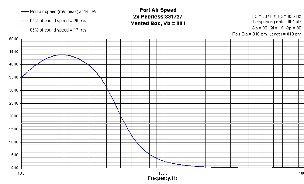

FYI
Port air speed with a single 10cm port in a 2x10" 80l vented design at 440W which is tuned higher than a single 15".
Conclusion I would use at least 2x10cm ports for this design
I won't argue with you regarding your calc of air speed 😉
However I know that this driver in a 125 liter (cf ???) cabinet with a single 10 cm flared port (correction from one of my first posts 10 cm = 3.9") plays down to 25 Hz at high power without any port noise...... The guy who calculated this for me has uses such speakers.

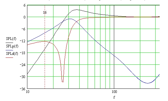

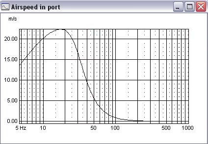

Hi ACD,
Although not your thread subject, i must agree that one 4" port is very little for your box size, tuning and power.
Simulation with one 15" JBL 2235H in 125L box, 25Hz tuning, one 4" port and 150W input.

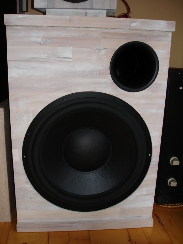

I promissed to return 😉
Got the complete speaker sets up and running (though at the moment using a passive crossover). So fare no problems with the ports using my AMCRON's DC300 Series II in bridge configuration, however I can imagine using higher power than 300W you just put your face in front of the ports and you don't have to shave 😀
More information on www.audio-circuit.dk under my projects
