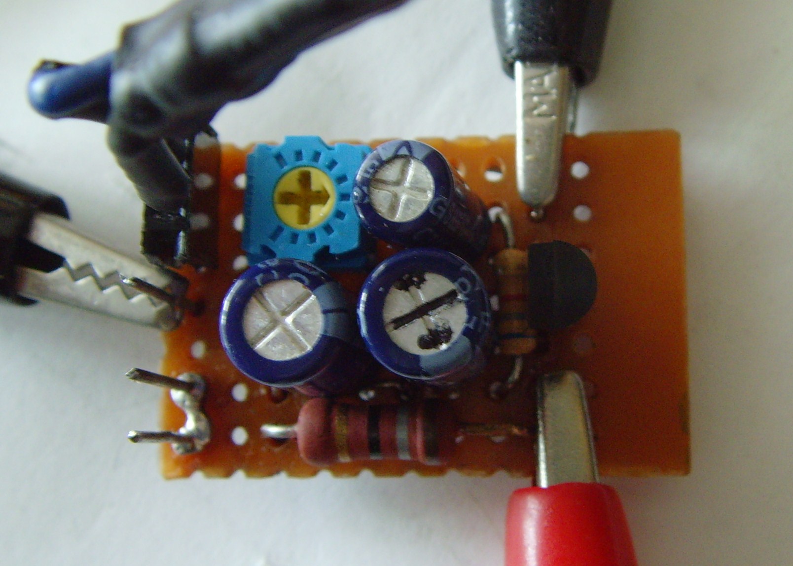

Flea Power Amplifier

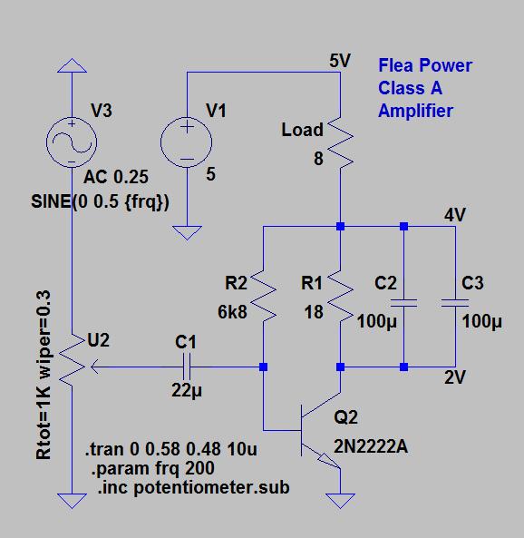

A tiny amplifier using one small signal transistor. It is capable of driving a speaker directly and fits on a 25x20mm protoboard.
The amplifier operates in class-A from a 5V supply at 110-120mA quiescent current. Input is at soundcard line level. Output power is estimated to max 150mW into 8 ohms. Power consumption 0,6W.
Component values are selected through simulation and experimentation. A voltage of around 2 volts at the collector and an output voltage of 4V works well.
R1 runs a bit hot and should be rated 1 W.
R2 may need to be adjusted for a collector voltage of around 2V and 110-120mA current.
C2 and C3 can be combined into a single larger capacitor.
Q1 is MPS2222A and not 2n2222A as on the diagram. Selected because gave the best result between the tested ones. I assume that BC337, 2N2222 and similar will work well too.
U2 is can be replaced by a fixed resistor divider or even omitted.

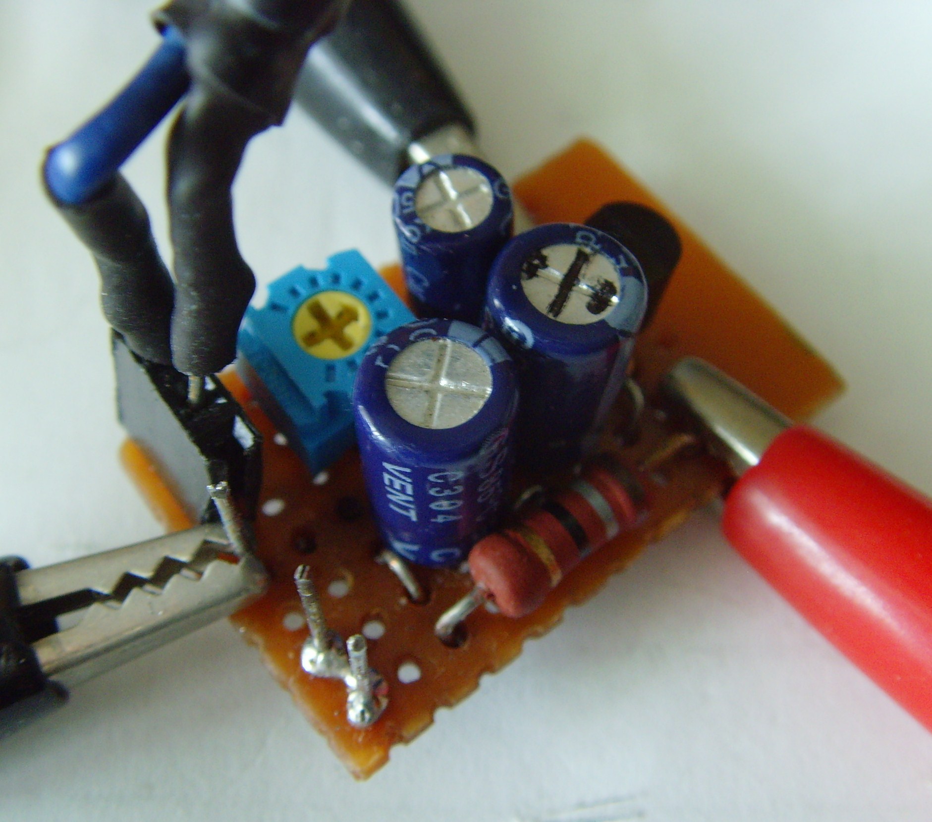

This is probably one of the simplest amps you can build, it works well enough for an internal PC speaker. It is not exactly HiFi, but makes a lot of noise when connected to a JBL mini monitor 🙂

You are not showing an Amplifier (which has gain and can be driven by a small signal, such as the typical 100mV RMS available from a phone) but a unity gain buffer, which needs in this case 3Vpp 😱 to be fully driven.
And in general about full rail to rail (or rail to ground) drive signal swing.
Don´t compare apples to oranges 🙄
@kokoriantz
Yes, there are many nice schematics out there. The one you refer to is a simple source follower circuit and has no voltage amplification. It works well if your input voltage is high enough. But is not suitable if you want to boost a weak line signal to power output level....
@JMFahey
I think we can agree on that.
Pulling DC power through a speaker is rude. It drives the voice-coil off the center of the magnetic gap, reducing useful excursion (though may still be ample for the power). It creates useless heat in the coil (here, not a lot).
Tying one side of the speaker to an off-ground power supply is rude. If it wasn't 5V it would be a shock hazard. As it is, a short to ground wants to burn-up the power supply (though assuming USB-wart, maybe no smoke).
The circuit is not unity gain, as someone asserted (look again). An optimistic analysis suggests gain of 36. The input impedance tends to be around 33 Ohms, so ANY parasitic resistance matters a lot. It may drive fine from an iPod etc.
R1 C23 simply waste-off 2V of the 5V supply, do no other good. A couple D-cells would power this a long time. Or it could be correctly re-designed to use all the 5V available, make 2.7 times the power.
The power output is easily estimated. The speaker idles with 1V across it. This can go to zero but no further. Assuming the transistor is happy passing 250mA (the parts mentioned are marginal), then we can pull another 1V peak. 2V peak-to-peak is 0.707V RMS. (0.7^2)/8 is 0.062 Watts.
THD at this level will be gross, >20%. It will be a third, 7% mostly 2nd, at 1/3rd the voltage, 1/10th the output, 6mW. Draw the line anywhere between 6mW and 60mW, depending on the THD you will tolerate. Several % THD at several milliWatts is not real offensive.
If you want more power with minimum parts, you can use a TO126 darlington (these usually come with integrated b-e resistors, so you can bias them with a single c-b resistor) like a BD675. That would make it a one trimpot, one cap, one resistor, one transistor rude-boy amp - "louder than yours", haha.

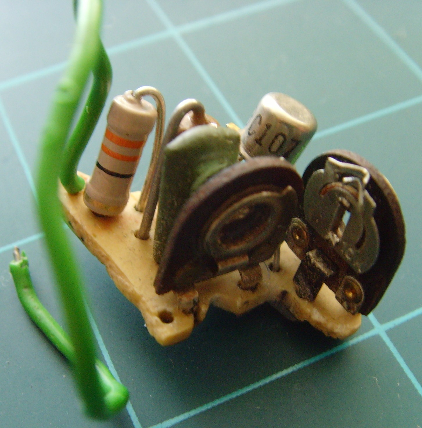

The original Earplug Amplifier
Thank you for comments!

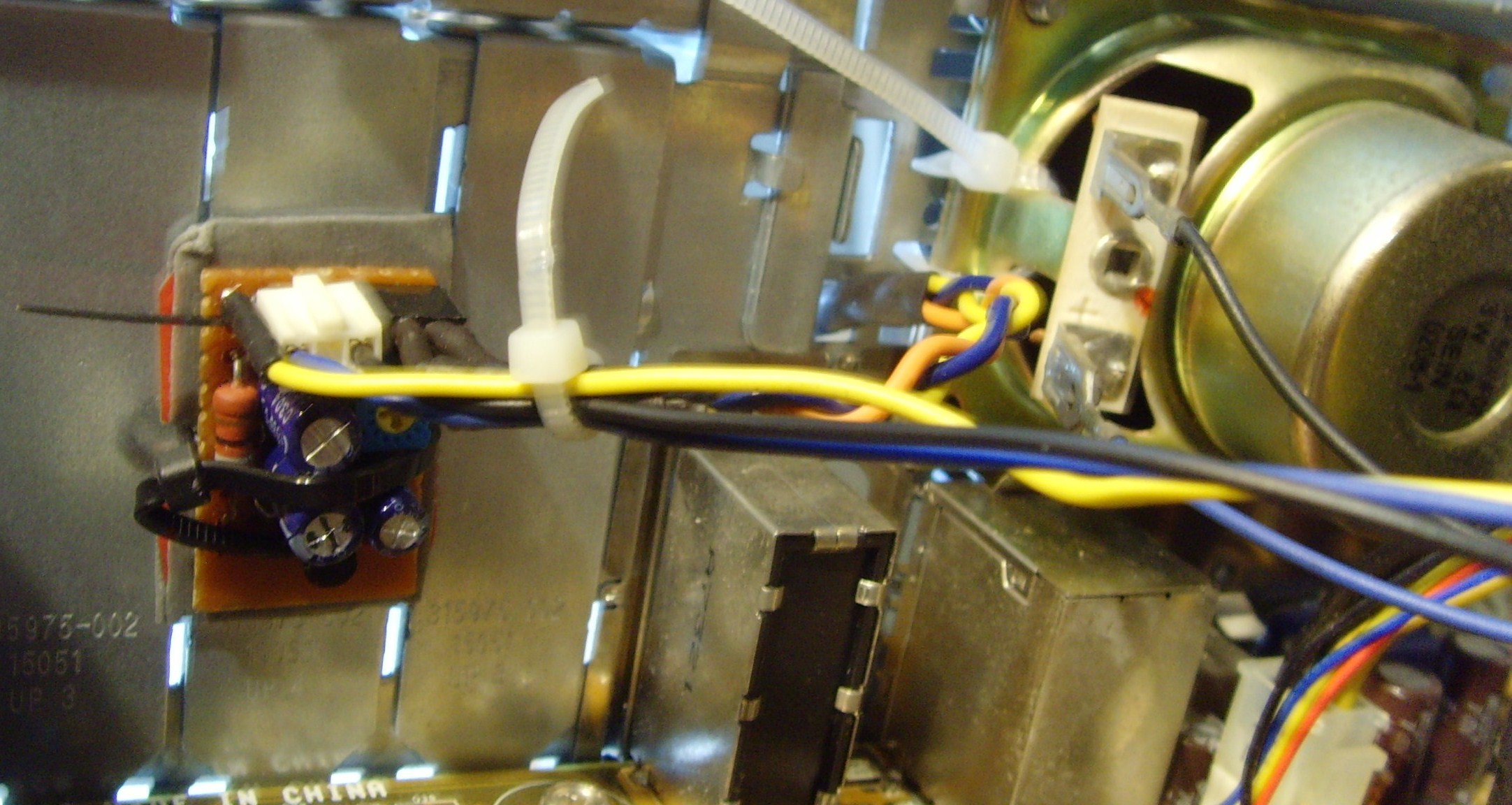

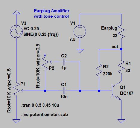

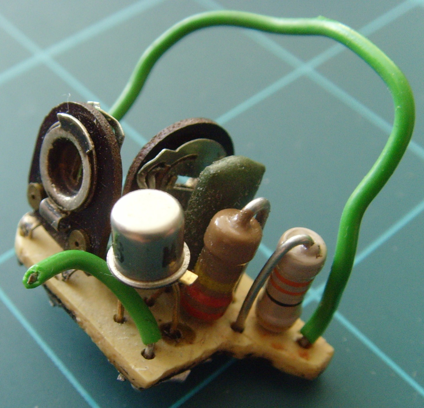

Here is the almost 40 years old earplug amplifier that inspired the current build. The design came from an electronics magazine and it was installed in a battery powered Philips cassette player which didn't come with an output jack. It was squeezed into an empty spot just above the main pcb. This design only draws power when the earplug is connected. P1 sets the level, P2 is the tone control.
It worked well for its purpose and when the cassette player was discarded I salvaged the amp since this is one of my earliest projects.

Now for the comments:
@PRR
Yes, it's rude to send DC through a speaker element and to pull the voice coil off center. But for some reason it actually sounds louder compared to a traditional setup with output capacitor. Also the speaker could have been connected to ground, this would be possible with mirrored setup and a PNP transistor instead of NPN.
The voltage gain is estimated to 15~20x and the harmonics are bad as you predict. Maybe an emitter resistor of 1-2 ohms would help?
From simulation it seems to be hard to squeeze more than 0.8V peak (1.6 Vpp) out of this contraption without lowering R1 and increasing the bias with the risk of frying the transistor and maybe the speaker too.
The capacitors across R1 pass the full voltage swing at the collector on to the speaker and actually increase power without increasing the quiescent current. Look at them as output capacitors.
@anti
You are right, a darlington would work much better, an output voltage swing of 2.2~2.4Vpp should be possible. But it will run much hotter and the idling current may become to much for the speaker. Then we actually have a 2-transistor amp including 2 more (built-in) resistors..... 🙂 It would be worth trying anyway.
I didn't bother to scope the circuit yet, but will do one day. It could be nice to see the waveforms and clippig voltage. But it is already built in, so I may need make a replica in order to do further analysis.
After all this is Flea Power for PC and similar use, but it may be scaled up to a couple of watts.
