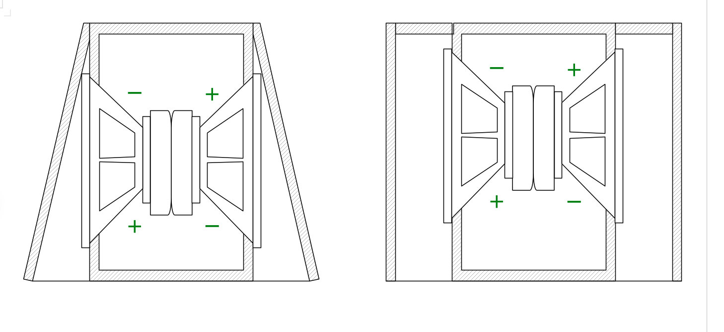

This sketch is based on above criteria:

The pattern would not be cardioid in your proposed array configuration.
There are multiple path lengths between the front and rear drivers direct and reflected output in any direction, which will cause a series of peaks and dips, known as comb filtering. The upper response will suffer the most, as a full wavelength of 150Hz is 7.5 feet long, ideally you would want no more than 1/4 wavelength (22.6 inch) path length difference at any given listening point to avoid peaky response.

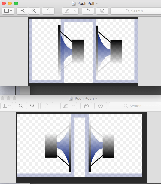

Push-pull or push-push designs largely eliminate the path length distance problem at sub frequencies, while still providing force cancelling, and some additional upper response gain:
Mounting the drivers opposite each other in a plenum (slot) in either push-push or push-pull (opposite direction with the polarity of the "backwards" driver reversed) would have much more consistent indoor or outdoor frequency response than your proposed driver configuration.

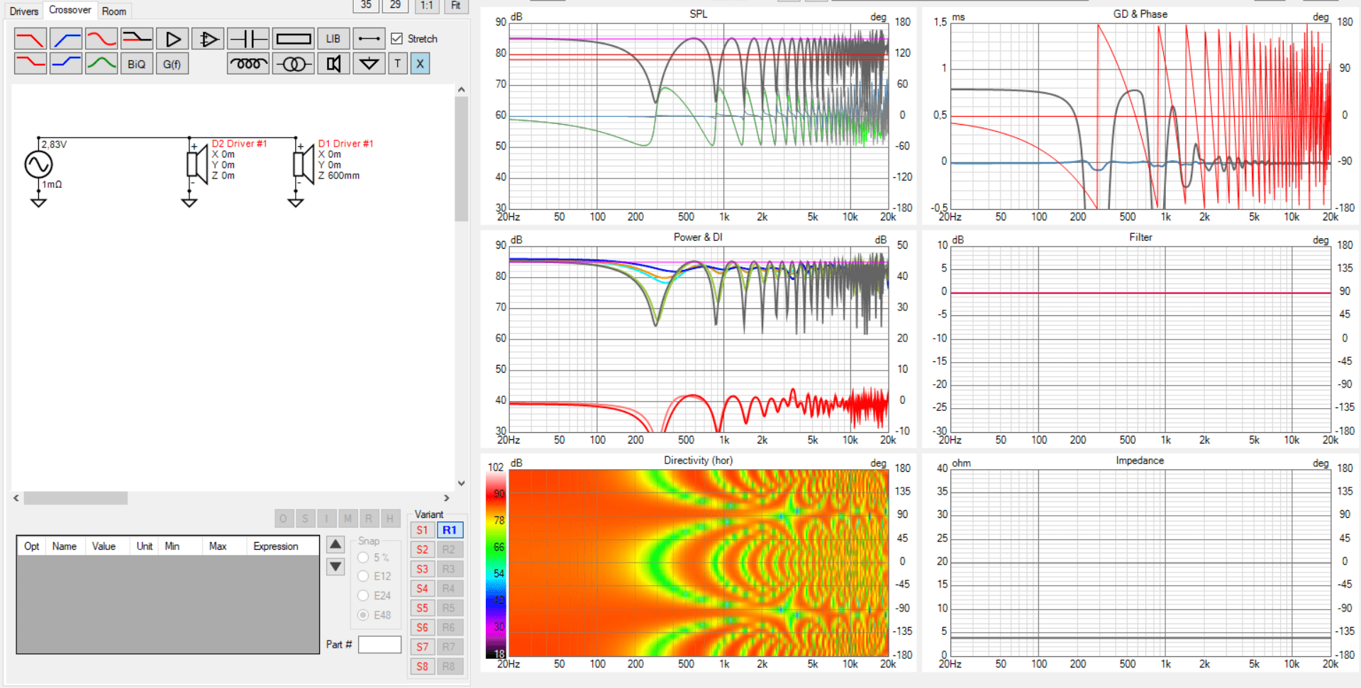

Most certainly there will be a NULL somewhere, tied to the offset of drivers, but where? Will it be audible in a room? Outside?
Hi, the configuration is bipole. Nulls would form where ever direction the sources are 1/2wl apart, or multiple of. The null forms not to side, because the drivers are always equidistant there, but to the main axis, "front off". First null would be when depth of the box is half wavelength. For 30" this would be about 280Hz and for 30" about 220Hz.
Very easy to play with in VituixCAD, open the program, copy the driver, hook it up, adjust Z offset of the other.

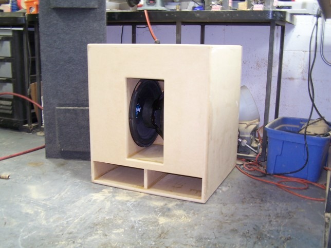

Lots of info on PPSL = Push Pull Slot Loaded in this old thread.
https://www.diyaudio.com/community/threads/a-thread-for-those-interested-in-ppsl-enclosures.177905/

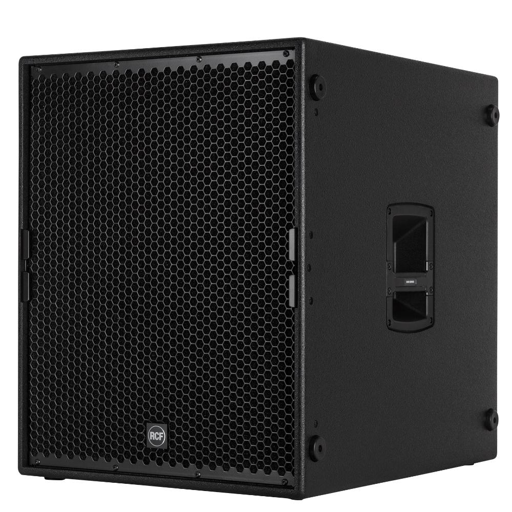

True.... using dedicated products ( read not cheap as dirt, can be cheaper if 'industrial' products rather than audio dedicated ones ).

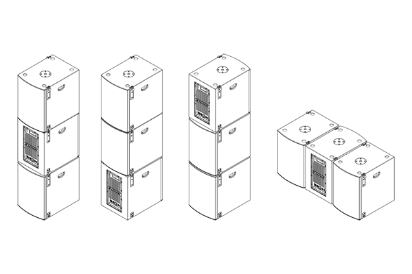

Then, RCF engineers (and all others) must be first-rate jokers!? Pay attention to the four small round rubber feet/discs at the corners (both at bottom and at side) of the RCF SUB 9004:The rubber feet comment strikes me as a joke.
Have you ever seen a professional sound reinforcement subwoofer before?
Or any Genelec monitors...
I have made them. Feet are needed to ensure they don’t slip around. Think about the size of the foor required to isolate a mass that large from what it sits on.
dave
I am making them too. Above 800 units to date.
For every feet there is a complementary round hole on the other side of the enclosure - to ensure subs don't slip around when stacked on a top of each other. So feet do not need to be made from rubber, to ensure non-slipping.
Feet are made from rubber - not from another material. Guess why.

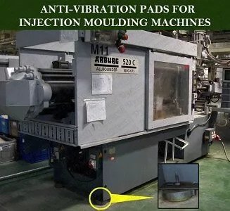

Rubber feet do suppress vibration - heavy industry machines make much more powerful vibrations than subwoofers. Here are some examples for vibration damping rubber feet:
https://www.vibrationmountsindia.com/compressor-machine-vibration-mounts/
https://www.vibrationmountsindia.com/injection-moulding-machine-vibration-mounts/
Are the ones on the speaker more than rubber bumps? Yje ones on the machines are purpose desogned shock absorbers, not rubber feet.
