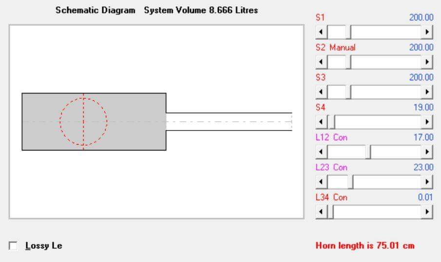

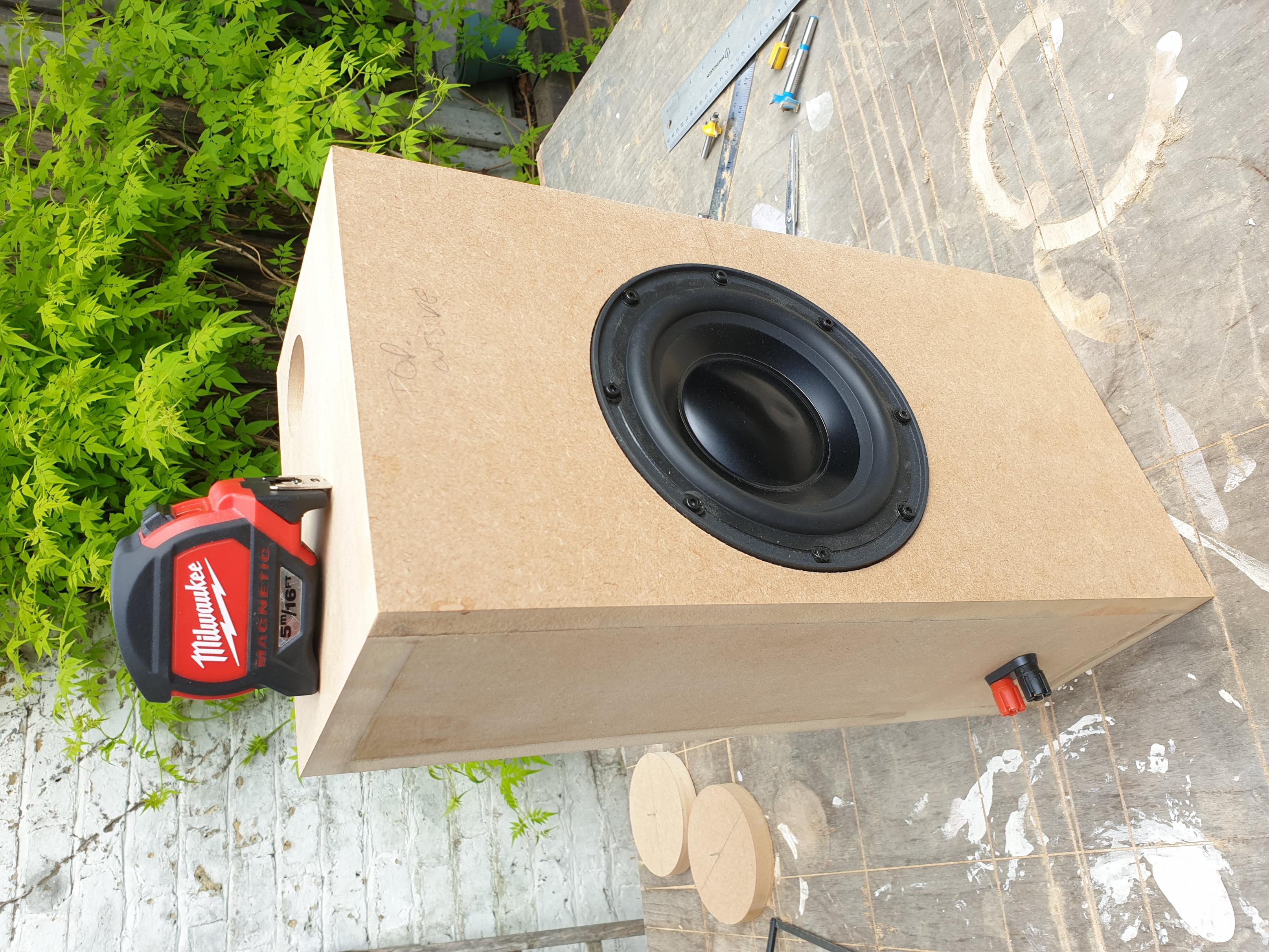

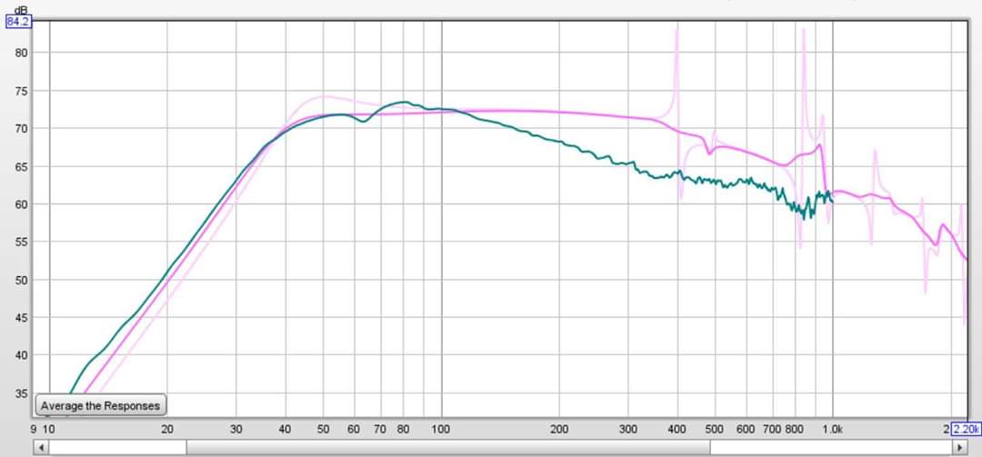

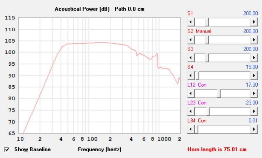

Personally, I don't think much of the Voxel design. It's pivoted around the availability of a particular (undersized) port available at parts express, I think.
What might be a good idea is to make longer, slimmer box with a long 50mm diameter port and model them it Hornresp. You will have the ability to play with driver offset and control where the port resonance falls.
This will address the issue of undersizing the port in order to shift the port resonance up. You can use quarter-wave phenomena to do it instead.
I did this with a Reckhorn D165 driver which would have a very similar alignment to the TB W5.
