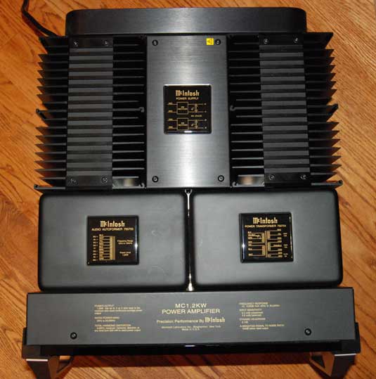

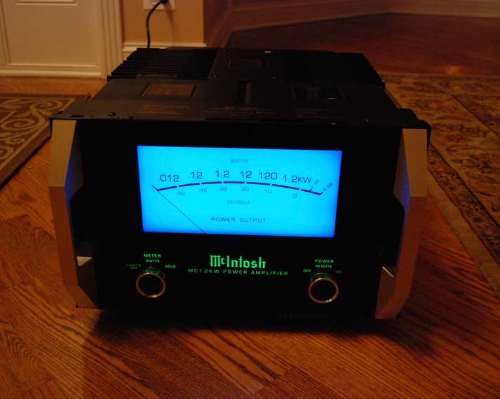

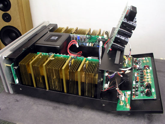

To help the discussion, I have attached pics of the Jungson, and McIntosh MC1 2000W monster amp which use a type of aluminum plate output transistor heat sink. You can estimate physical plate fin sizes from the pics.
There are a few heatsink simulation programs on the web. I have used R-Tools. There are also simple tables for heat spreading on the web which can give reasonable estimates for a single fin.

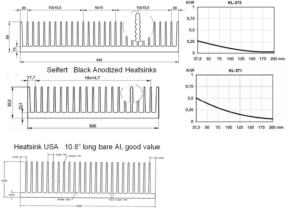

I have also attached a pic of highly regarded extruded aluminum heatsink profiles to aid in comparison. Heatsink USA is a DIYaudio vendor. It is sometimes valuable to have all transistor junctions operate near the same temperature. Bipolar Class A/B amps bias optimization often assumes a uniform temperature on all transistors. ThermalTrak bipolars include an on-header diode which provides fast time constant response, but still only averages thermal drops over several transistors.
