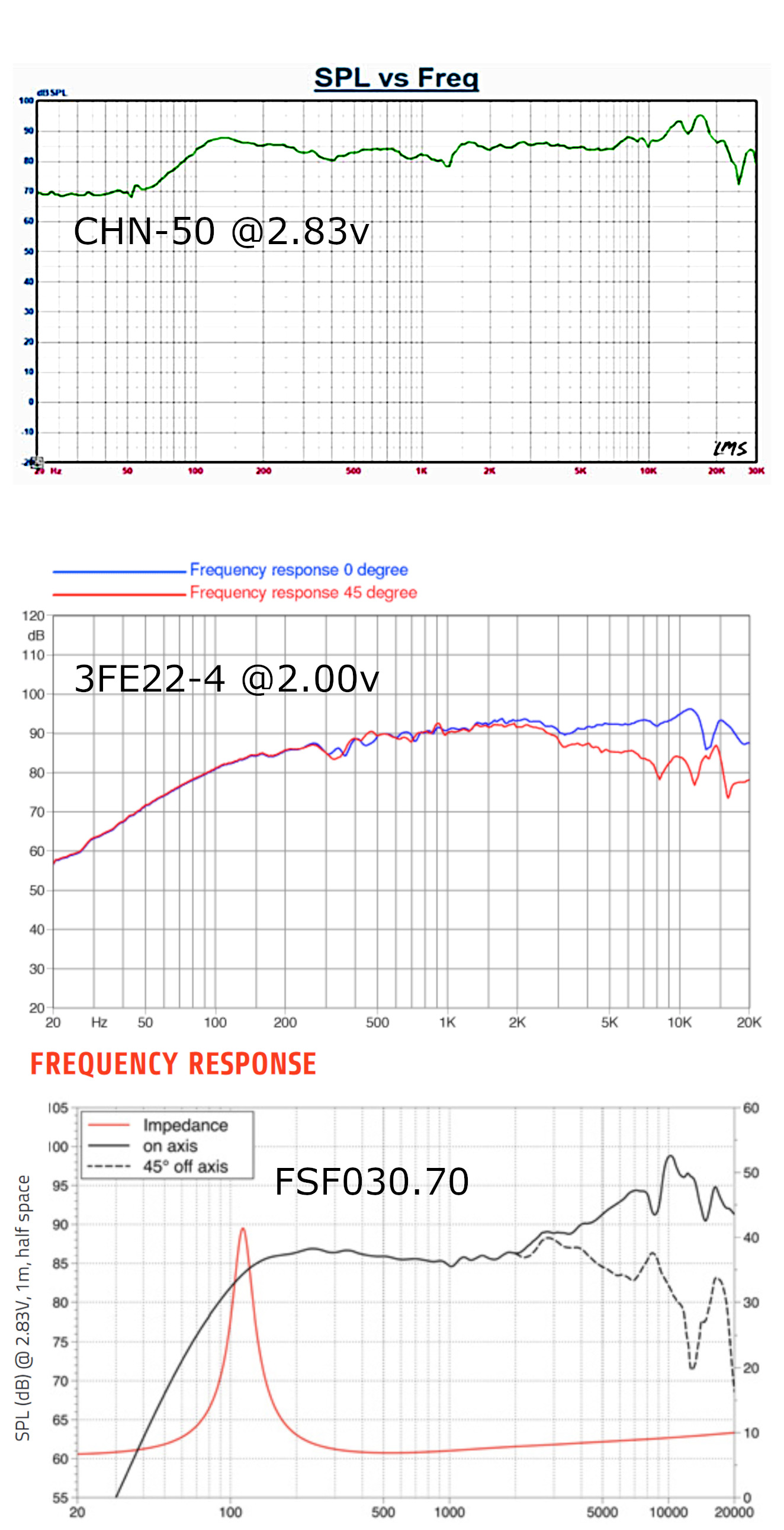

still looking for an appropriate 3" (or cone tweeter) and like for it to keep up with with Emiennce's B102 and Celestion's K12-200TC.
here are current prospects - other suggestions would be welcome.
Also input from XRK971 would be helpful with regards to selecting an aperture
to enhance horizontal polar response with 3 inch cone drivers.
btw -the cardboard lens I made for the LaVoce driver below had the cone fairly well "shaded" and sounded nearly holographic 45 degrees off axis (much wider than bare driver)

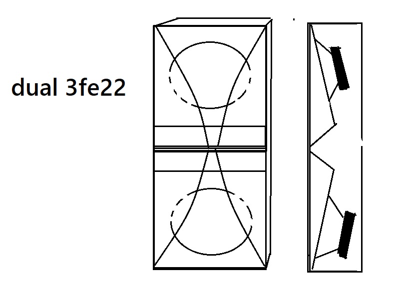

I would pick the 3FE22-8 if one needs the sensitivity. Alternatively, make a symmetric double aperture and use two 3FE22-16 in parallel.
Dual 4FE22-8 in parallel will be 4ohms but 97dB at 2.83v.
I would flip the angle of the drivers to be concave and have a center aperture that looks like a diamond with curved walls. Basically like my dual driver XKi but perhaps sealed in the back if you don’t need bass. I would open the aperture wider for more top end.
