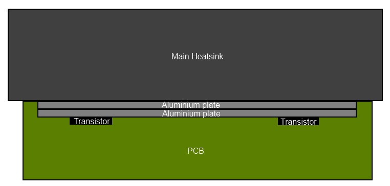

To fix my printed transistors on the heat sink power circuit I need to insert an aluminum plate 6 mm thick but I find only 3 mm plate.
My question is simple:
If I put two plates of thickness 3 minutes between my transistors and the heat sink, it will be effective equivalent to a single sheet of 6 mm.
I made a little drawing. 😀
Regards!

imho, you are better off with just a 3mm plate....any reason it had to be 6mm?
with just a 3mm plate you have 1 less thermal junction to worry about...you can always bend the trannie legs a bit....

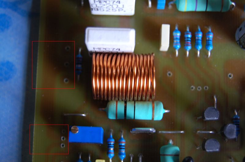

This is to avoid bending the legs of the transistors.

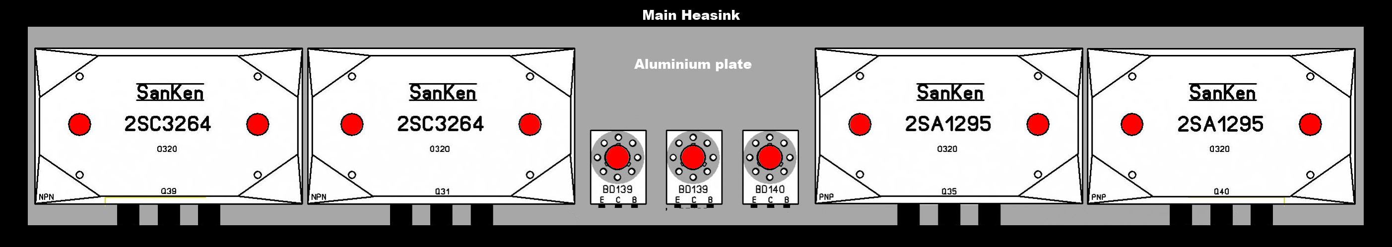

But I can (by bending the legs of Sanken) fix directemment on the main heatsink but I have to add an aluminum thickness for BD139 and 140 because the legs are too short.
Why 6 mm:
Is the distance between the base of one and the edge of Sanken PCB.

if you must, small plate spacers for the bd139/140 would be easier to do...

To summarize you have convinced me that it is best to directly heat sink for the power transistors.
I put a spacer under the BD because I do not have a choice or when connected to the plate by the very short thread.

1) sorry but the PCB design is not the best.
It should put transistor pads closer to an edge, so you can attach it easily to the heatsink or an aluminum backpanel
2) if you don't want to redo the PCB, you can (should) mount the transistors straight to the heatsink, and add small wire links so legs reach PCB holes.
