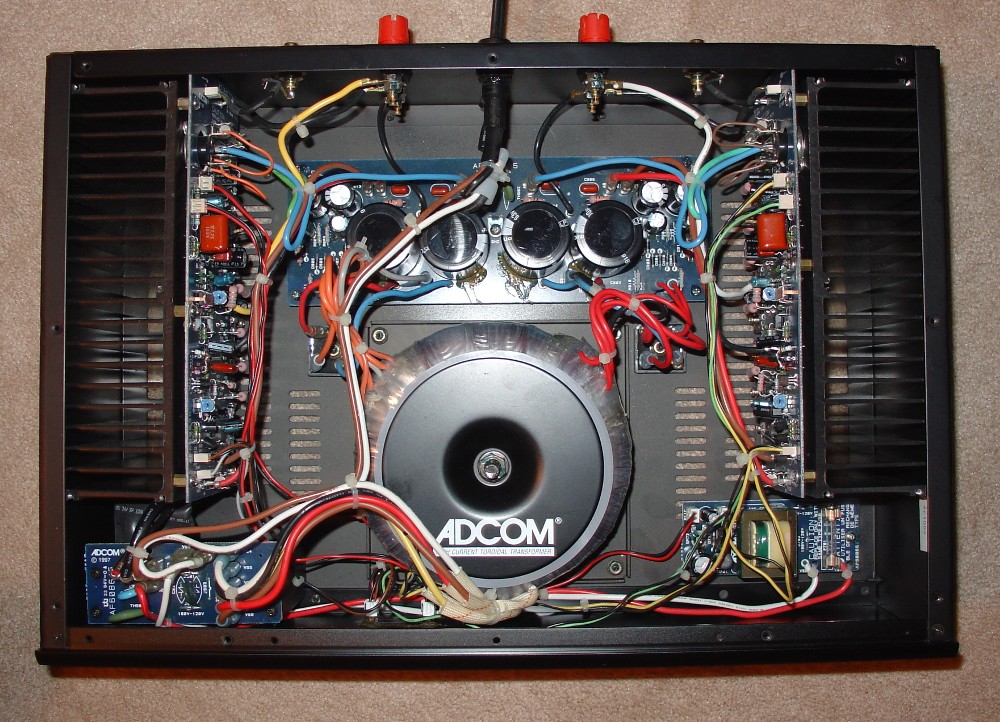

Here's an inside shot of a GFA 5500. This one is not my own, just taken off the net. On this shot, I can easily see something that bugs me on the output caps. The red silicone spots portrude from the can, which I believe is a sign they are beyond their life. Shouldn't a good capacitor show the little spots slightly lower than the surface? I will open my own amp and see if it suffers from the same condition.
