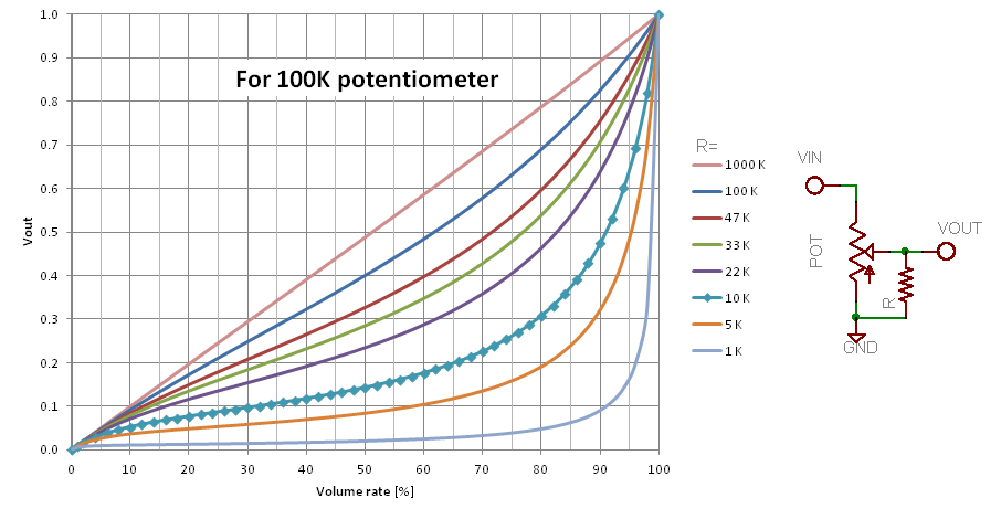

If you hang a 10k resistor between the slider and ground on each side of the pot, that will turn the pot into a more controllable range at the bottom end. You could use 5% 0.25W 10k with no issues. There is no point in lining the suppliers pocket at $## money prices!
The added "log faking" resistor has a much bigger effect during the upper 2/3rds of the wiper travel.
It has much less effect in the lower 1/3rd of wiper travle.
Look at the graph of output vs pot rotation for the log faked version.

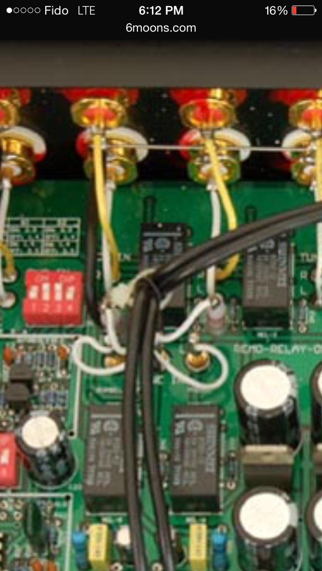

Hi guys
I was thinking of placing my resistors after the pot but at these posts which are at the back of the preamp so can place a toggle at the back of the chassis.
If would do it BEFORE the volume pot I would have to undo the whole PC board and it would make for longer wires to the toggle switch
I want the switch, so in the day time where volume is not an issue then there would be no extra resistors in the path..
See pics
See pics
If you place the resistor like in previous photo you do not need to place a switch because the maximum gain/power it is not afected and during the day time you only need to use a higher volume setting.
For example, if you use durring the day usualy 30% of volume now, with a 22k resistor you will need to use 63% of volume. But if you need during the day usualy 60%, with resistor the setting will be 88%, or for 90% with resistor it is need 97% but still possible.
