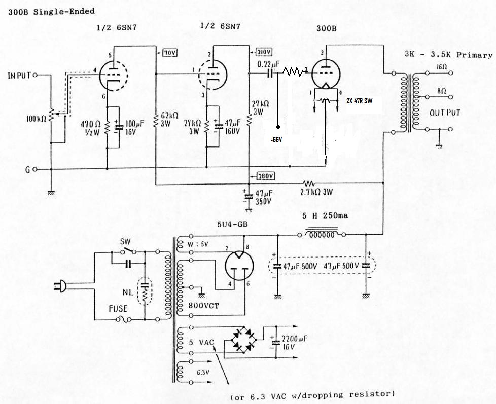

So taking the attached schematic by way of example, I have modified for fixed bias. Have I done this correctly? With respect to R1 in the modified schematic, how is the value calculated?
Once again, thanks in advance - these simple problems are slowly advancing my understanding...

Hi Rob,
you should insert a grid resistor between you bias supply and the gridstopper. The bias supply is ground for the audio ac, so the output from the driver will shorted to ground without a grid resistor. Keep the grid resistor asl low as possíble, refer to the tube data sheet. As Eli Duttman wrote , a too high grid resistor is a risk of a tube run away .
Here a simplified schematic of a bias supply. The bias voltage should be adjustable by a potmeter for proper settings.
I would leave the circuit as it is, because kathode bias preventing the tube under all circumstances from run away and comensate the aging until the end of its lifetime. Its worth to do so even that you need a higher supply voltage of the amount of the bias supply .

Funker, I hear what you are saying and I am sure that you are correct but I want to play around with fixed bias on this one, more as an experiment than anything else.
So it looks like I can connect the cap directly to the grid and only need one resistor between the bias and the grid. Is there a standard value or is there a rule for calculation?
Sheldon, I have seen some designs without the capacitor to ground. I think the simple SE is an example of this. Is it absolutely required?

Rob11966 said:Sheldon, I have seen some designs without the capacitor to ground. I think the simple SE is an example of this. Is it absolutely required?
It's there on the Simple SE. It's C7, the final cap in the bias supply. At 100uf it's plenty big and should give a quiet supply to less than a couple Hz.
Sheldon
BTW, the grid leak resistor in that design is 20k (R-22). It also illustrates the value of the source follower. You can load your driver lightly, use a small coupling cap, and use a low value grid leak (and push a little A2 for peaks). This costs you one FET, a couple of resistors, and a few milliamps current from your B+ supply.

Exactly as jmb indicated in his post above. The resistor between cap and grid is frequently referred to as a grid stopper resistor..
