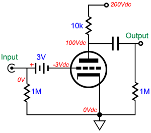

Personally, I bias using the battery in series with the grid - that's why you need one for each tube IMHO. Doing this means the batteries won't discharge and depending on chemistry will last for decades. I had a VTVM with a 50 year old Eveready carbon cell as bias cell, and it still measured 1.5V before I replaced it with an LM317 based voltage source.

A series battery from the signal source to the grid.
Typical circuit is RCA phono jack input; then either a resistor, rg, to ground, or a potentiometer to ground, then the battery + to rg or the pot wiper, battery - to the grid.
Worked well for many of my amplifiers. I used lithium and alkaline, depending on the voltage needed, and the space that was needed.
If you need a grid stopper, then battery -, to the grid stopper, to the grid.
Always measure the installed battery capacitance to ground, so you know what high frequency effects it might, or might not have, in your circuit.
There's also a special case for the first stage of a phono equalizer. A bias battery can sit between signal ground and the bottom of the phono input and its loading resistor, which then floats up from ground by the amount of bias. No coupling cap needed. First cathode is bolted to signal ground. Turntable chassis ground wire must be separate, and should be anyway.

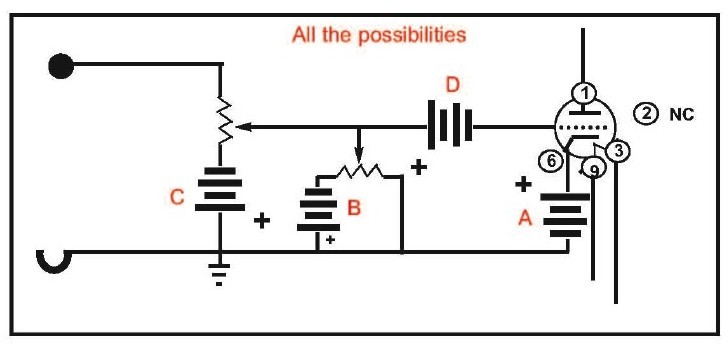

A. Doing it the following way, has a problem . . .
Connect a phono cartridge coil through the shielded wire, and connect it across the RCA phono input jack.
Then connect the center lead of the RCA jack to the top of a 47k ohm resistor, and the bottom of the resistor to the negative of a battery, and the positive of the battery to ground.
Connect the top of the 47k Ohm resistor to the tube grid, and the cathode to ground.
That will bias the tube, but . . .
The battery sees 47k Ohms, going to the cartridge coil DCR. There will always be DC current there, 24/7, until the battery is discharged.
Not a good idea.
B. Instead, connect the 47k Ohm resistor across the RCA phono jack, connect the center lead of the RCA phono jack to the positive battery lead, and the negative lead to the grid.
Then connect the shield lead of the RCA phono jack to the cathode.
This works, and does not discharge the battery, like the above circuit in #1 above does.
C. Post # 18 works, unless anybody shorts the RCA connection to ground, either at the turntable/tone arm, or at a grounded signal source selector switch (that has common ground connections to multiple turntables/tone arms, with one of them that grounds the shields).
But if nothing grounds out (across the battery) that is an elegant solution.
