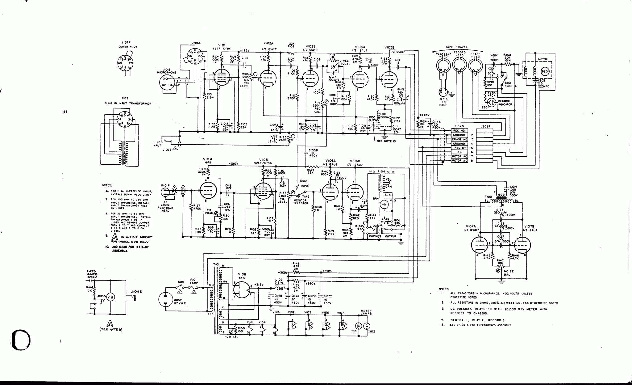

I have a problem with an Ampex 601 preamp, when I turn up the gain past about half way it starts oscillating (MIC. REC. LEVEL on the schematic, just after the first tube, which is a 5879).
I tried changing the 5879 tube, and cleaning the socket. I have already changed the two proceeding 10uF power supply filter caps. Using a cheap oscilloscope, after the input transformer it looks fine, but anywhere after the tube I get the bad signal. I plan to also change the 20uF filter capacitors as well.
I then changed the potentiometer itself and the .1uF capacitor before it, to no avail.
As it happens when I turn the gain pot up, what does this indicate? Does this necessarily mean it must be a problem before the potentiometer? I am quite a novice, but since the resistance increases, does this mean that more current is drawn, so it could be a power issue? The only thing I haven't changed now around that tube is the cathode bypass cap, and the resistors, but before I proceed what do you think is most likely to cause such a problem? I guess the second tube I tried could be wrong too, but it seems unlikely, and changing it produced no effect.
I have attached the schematic.
It's been like this since I got it (I just used it with the gain down low but it's not useful for quiet sources), and as far as I can tell it's mostly original. It did this before I changed anything. The values of the new parts are the same. Since it's from the 50s/60s I guess it's caused by an old part... but which one?

Thanks, yes I changed the final two 10uF filter capacitors, but it did not fix the problem. I can try decoupling the screen, although I am a little reluctant as I suppose there must be a defective component without changing the circuit from the original design?

That sure seems like oscillation through the power supply. Is this with the inputs shorted?
Will the position of the monitor selector switch change the behavior?
Does directly grounding the pentode's input grid change the behavior?

I grounded the pentode input grid (pin 1) as suggested, and no change. How do I short the inputs? I have nothing plugged in (do you mean connect 2 and 3 of XLR together? - when I do this it still oscillates after position 5)
Switching the monitor switch from input to tape position there is no oscillation. And removing the pentode tube completely there is also no oscillation. I am assuming this means the issue is early in the input preamp, but I'm a bit baffled, I don't know if there is much left to try.

If that doesn't work, connect the scope to pin #1 of the monitor selector switch.
Is the oscillation still visible on the scope when the switch is in the tape position?
If so, that would rule out the circuits after the switch.
Ok, then the problem must be in the first three stages of the mic amplifier.

Make sure C102 isn't leaky. There should be zero volts after it. I've been tripped up by leaky coupling caps because they shift the tube bias. A cap can pass every test, but the amount of leakage to create a significant voltage on a high impedance can be quite small. Usually it just causes excessive THD. Also, check the wire routing to be sure signal isn't being coupled back to the input. Oscillation with increasing gain suggests some feedback path.

I finally got around to taking some voltages of the coupling caps. I wanted to wait until I could borrow a better meter as mine is not the best. C102 I have already tried swapping as well, but I have taken a VDC reading after it anyway (the new cap is still in there). I took the VDC readings at a gain level before oscillation occurs, and at a gain level where oscillation is present.
C102 before oscillation 0 VDC, and at maximum gain (oscillation occurs) fluctuates from 3.2 to 4.2 VDC
C104 before oscillation 0.35 VDC, and at maximum gain (oscillation occurs) fluctuates from 13 to 19 VDC
C106 before oscillation 0.15 VDC, after oscillation this one is weird, I guess due to the oscillation - it seems to fluctuate (comparatively slowly) between -0.6 to +0.6 VDC at a gain setting just when the oscillation starts, but as the gain pot is increased the fluctuation is faster until after say 3 or 4 VDC (where it fluctuates between -3 to +3 VDC) and beyond that the voltmeter can't lock onto it as presumably it is fluctuating too fast or too widely.
I am not sure at all what these values indicate - how much above zero do you think suggests leakage? I did clip in a capacitor over C104 and then also (separately) over C106, to no avail, but I am not sure if that would actually work in preventing the oscillation if one of those capacitors is the cause?
