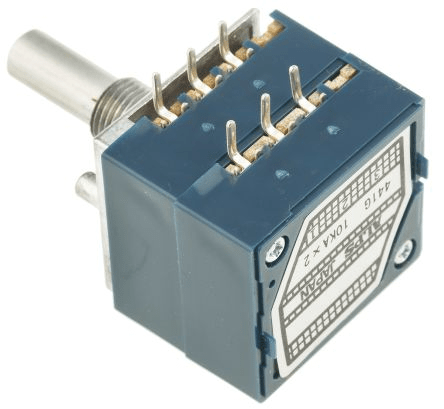

Dear all,
I own a Cyrus 2 with a slightly defective volume pot that at very low level plays only the left channel.
I know it is quite difficult to find the spare part so I would like to know if there is any compatible component that can replace the original potentiometer, even loosing the balance control, which I almost never use.
Thank you for your support
Gaetano
10K/10K? Audio taper? PC board mount?
Check out the Alps Blue Velvet:
