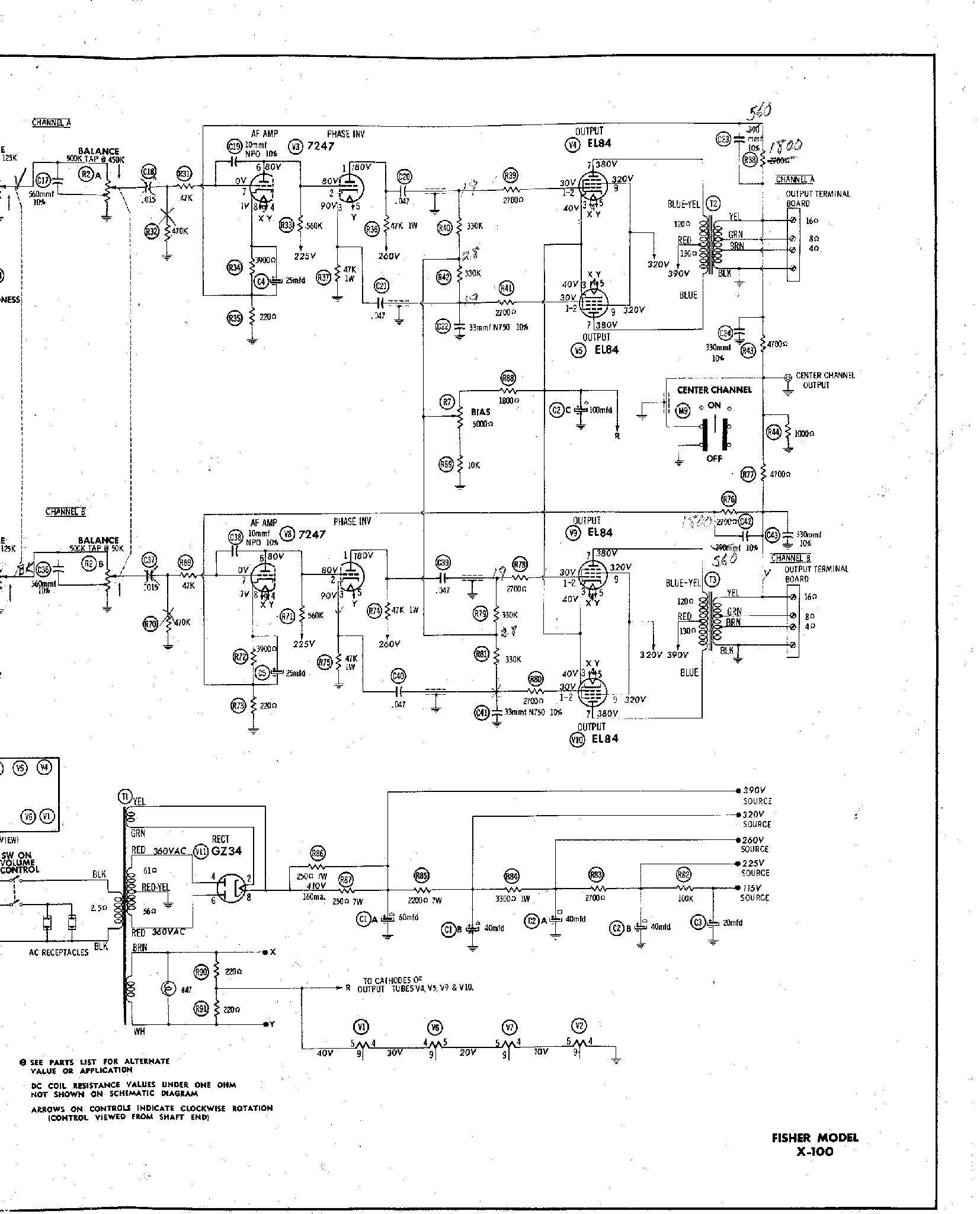

In the early X100 Fisher used the 7247/12DW7 (1/2 'X7 & 1/2 'U7), instead of the 12AX7 (which is a wimp). "Borrow" from the X100 and rest easy. While I'm among the 1st to castigate JJ about Octal production quality, credit where credit is due. JJ's 12DW7 has proven to be satisfactory.

My bone of contention with simply lowering the 7591 grid to ground resistance value is the wimpy (HIGH RP/LOW gm) nature of the 'X7 triode. While I lack rigorous proof, it seems pretty obvious that switching from the 7247/12DW7 was done as a cost cutting inventory control measure. Avery Fisher did not become extremely wealthy by accident.

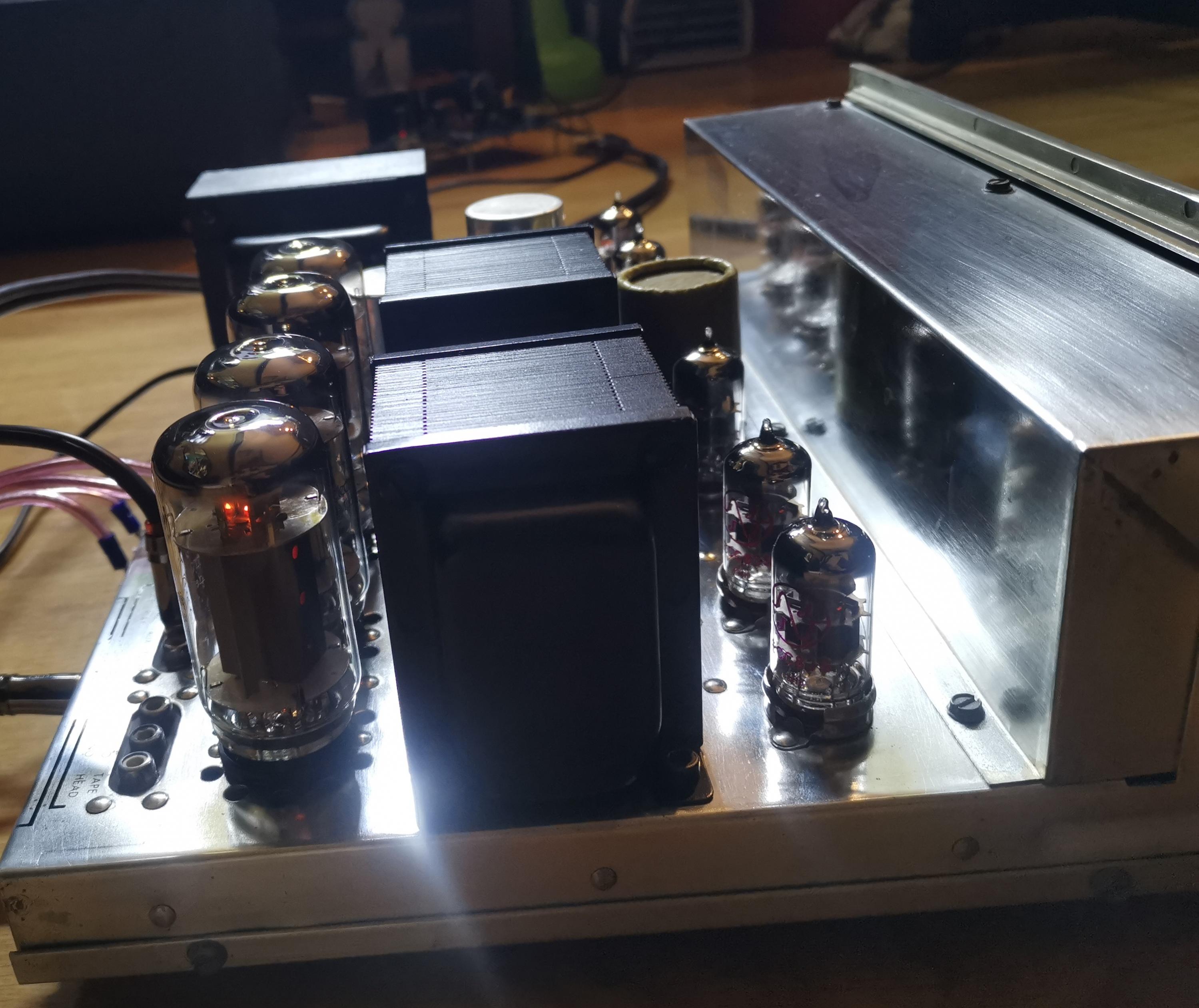

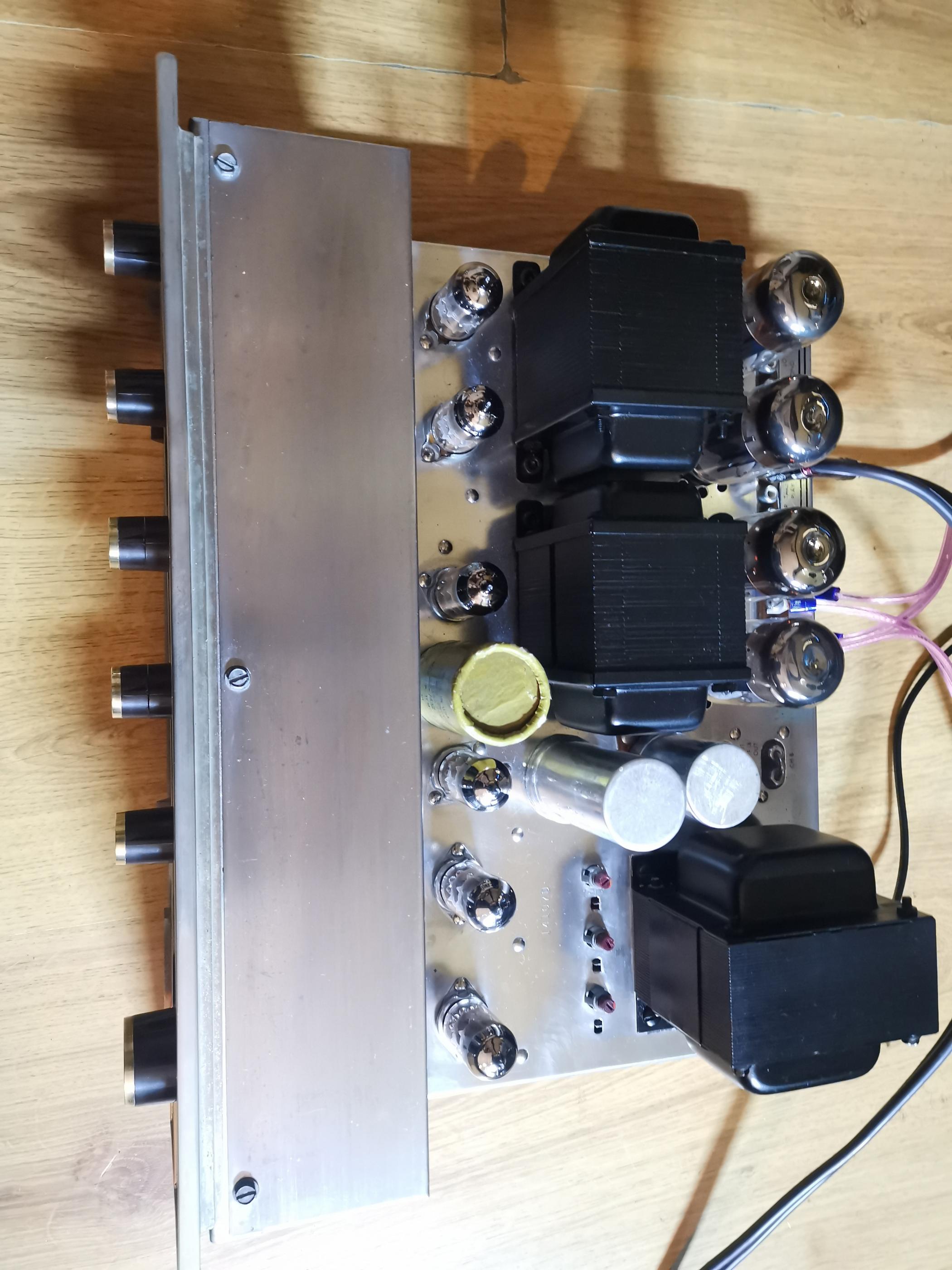

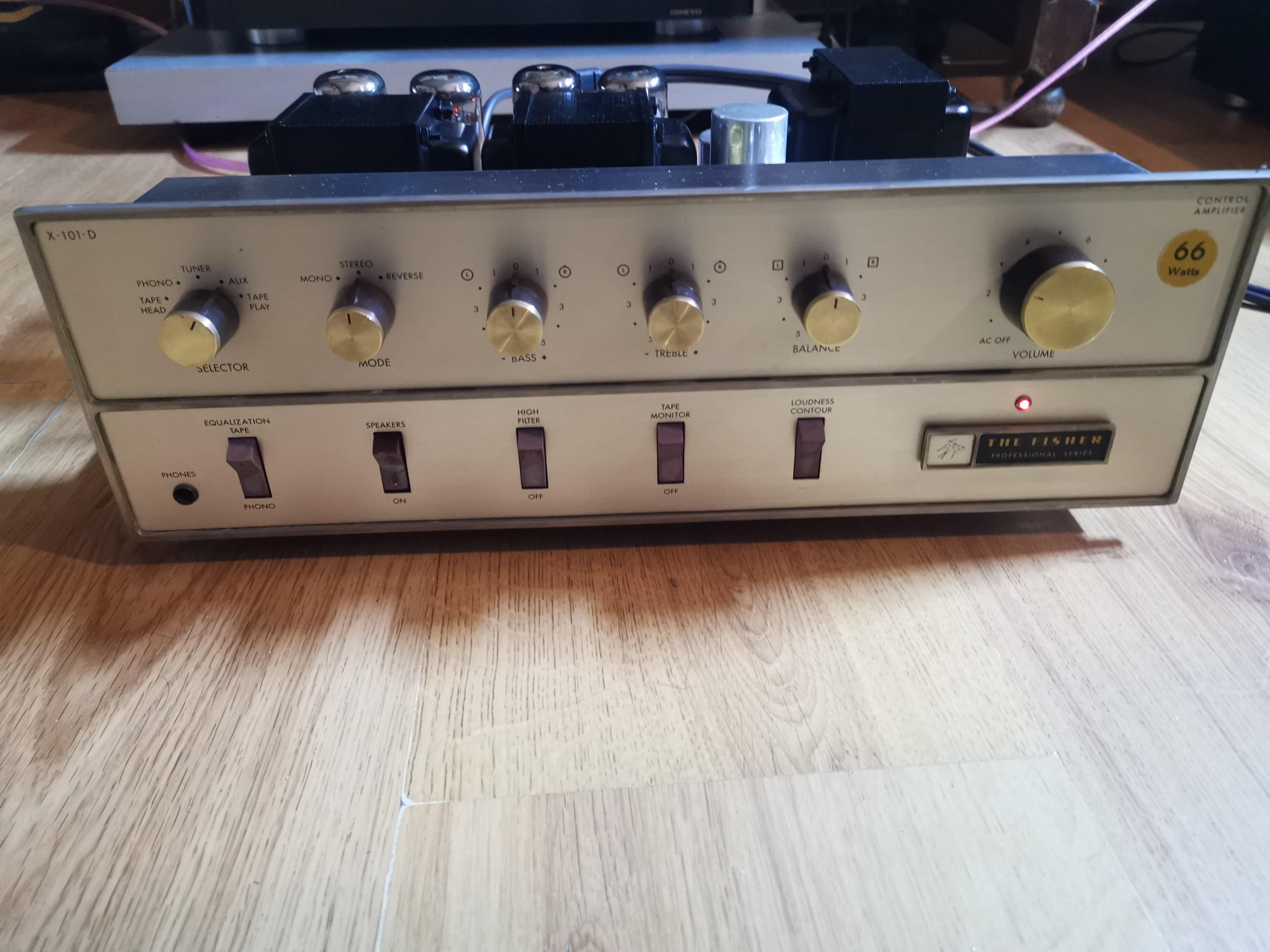

Hello, this is finally the Fisher works !!!! The resistances and capacitors replaced and now he sings without problem ... Fortunately the original transformer and well in 240v (2x120v) and not in 220v the filaments are well fed in 6.3v and all voltage ht are exactly as in the manual. I thank you for the advice, here are some photos for fun
