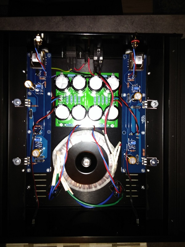

Hi, i have build F6 amp and i need advise how to set bias voltage. I now this ( starting with a meter across the 0.47ohm source resistor ) but which is source resistor? ( R?).
How i now when trip pot is turned all the way down before turn power on?
Thanks.
Thanks.
R2 0.47 (they are in different places so be sure.
You must start with a current limiting device (bulb tester)
As an example my pots work backwards so be ready for that!
If you have 6.2v zenners fitted start with the adjusters set about half way.
Switch on with the current limiter fitted and watch the voltage across R2, this will rise slowly as the caps charge. (If it seems to run away switch off and try adjusting the pots.)
Just look for enough voltage to start the mosfets getting warm.
Make sure that you know which way the adjuster is working.
Turn down the bias and remove the current limiter.
Start again raising the bias slowly and balancing offset.
It is all in the build guide.

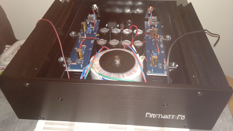

Just finished and i also have build B1 and they sounds great.

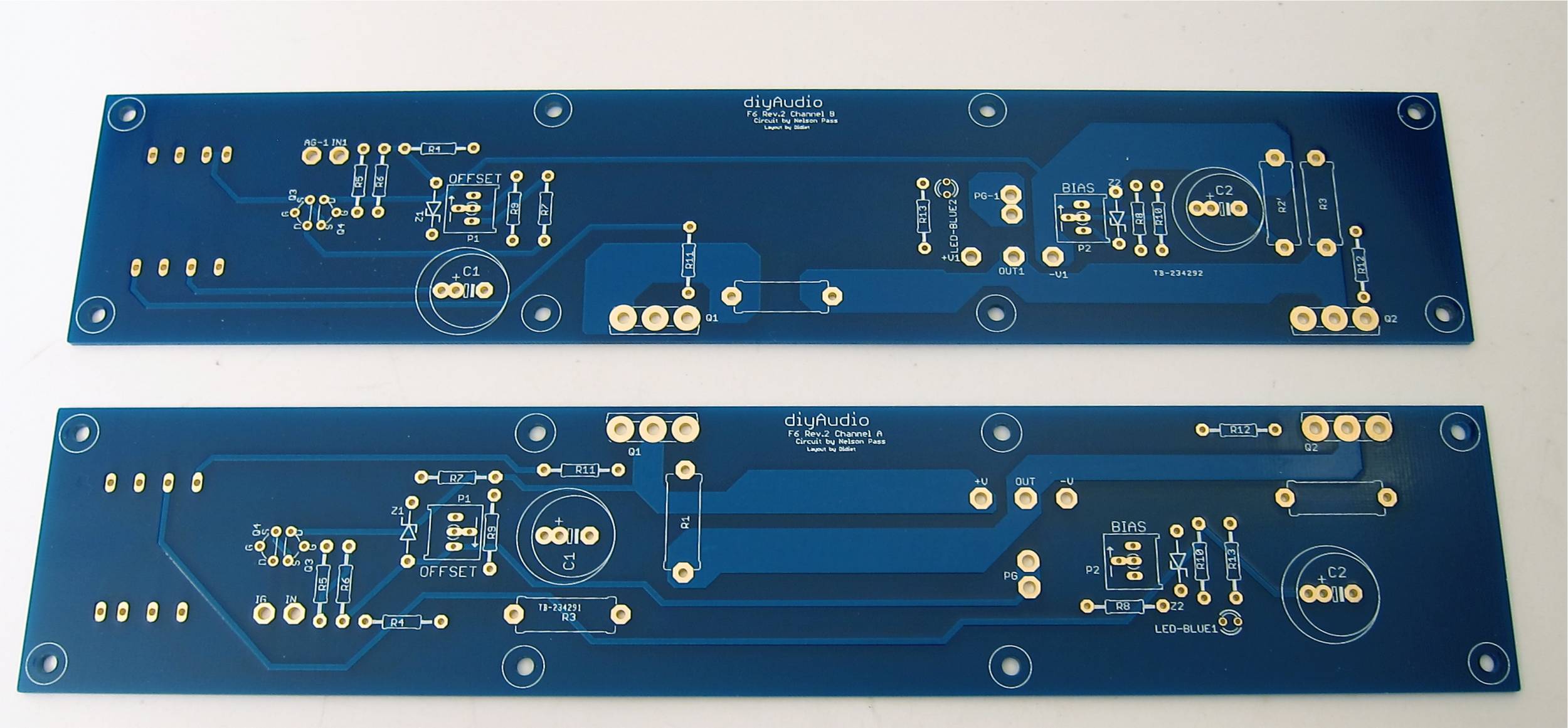

Hi i have a problem, i try to adjust bias a bit higher and something goes wrong. I can bias only less than 0,1v (left channel) right is ok.
Sorry, but I would suggest that you have caused a short with a test probe.
You are far from the first, I did it!
Time to test the Mosfets, and hope that the Jfets are still Ok.
You maybe right, so how i do the test?
I have test mosfets and there are no connection between drain and source so i think it´s ok
I can adjust bias voltage to 0 but not over 0,1V
Left channel board where problem is (upper PCB)
post schematic here, I can't be sure that my search will be valid
Problem solved, 1 resistor and Q1 transistor burned now it´s working
