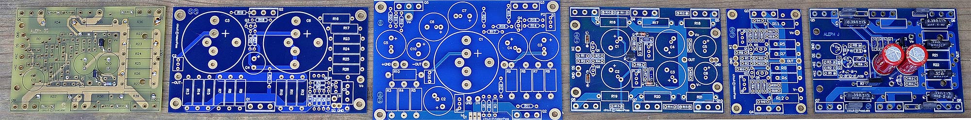

So, I'm looking at building an amp (and maybe a preamp) in the near future.
The ideal thing would be a Single Ended Transistor (SETr anyone?). The closest thing I've seen are Nelson Pass' designs.
I really like the look of the First Watt F2.
Is this available as a kit? Is there a project page somewhere describing how to build my own? Or is this just a commercial venture for Mr. Pass, and I will have to look elsewhere for a design?
I like the Zen designs Mr. Pass has come out with in years past, but I don't know how up-to-date the designs, parts lists, etc are.
Any help out there on making a decision?
I'd like a kit because I don't have the facility to make my own circuit boards. But if wiring is simple enough, the point-to-point soldering isn't out of the question.

The only official circuit board is the B1. It can be found on the PassDIY site.
However, there are group buy circuit boards for F3, F4 and F5.
http://www.diyaudio.com/forums/group-buys/140306-f5-pcb-group-buy.html
http://www.diyaudio.com/forums/group-buys/134554-gb-f5-pcb.html
http://www.diyaudio.com/forums/group-buys/156363-gb-f4-pcb.html
Any of the Firstwatt amps should be simple enough to build point to point.
Good luck with your build.
Doug
F2 boards are available here: http://www.diyaudio.com/forums/group-buys/152785-f2-pcb-group-buy.html

That F2 group buy might be just the ticket.
Peter, you got any of those left?

I still have plenty of them available

Yeah, I figured that out now... duh ... i was looking in the Pass section. 🙄
Since all 5 F series amps use / need the same power supply, and Chassis & Heat Sync, I would read the reviews on 6 Moons and build whatever seemed the best match. You could then change to any other F series at reduced cost at a later time.
