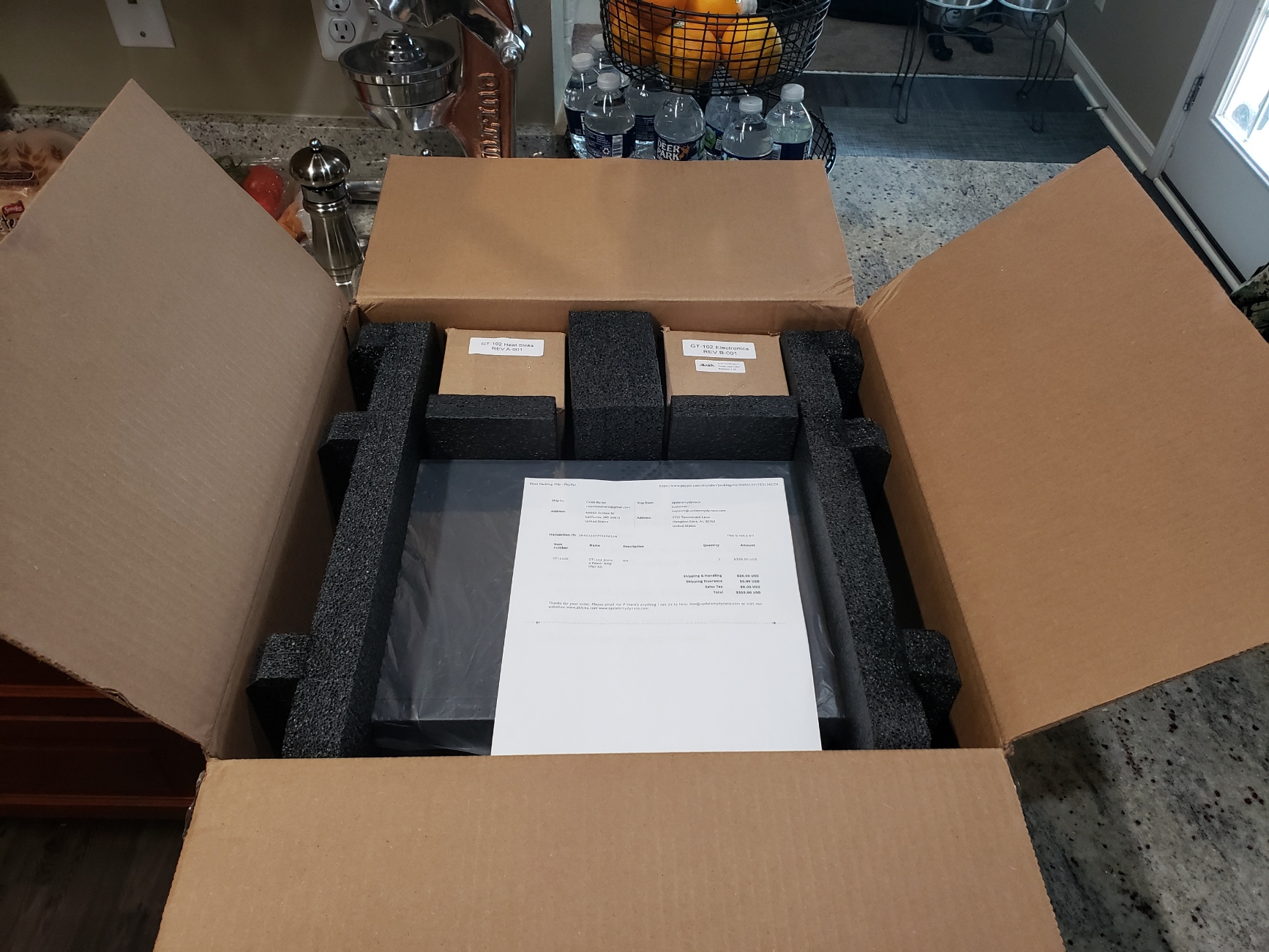

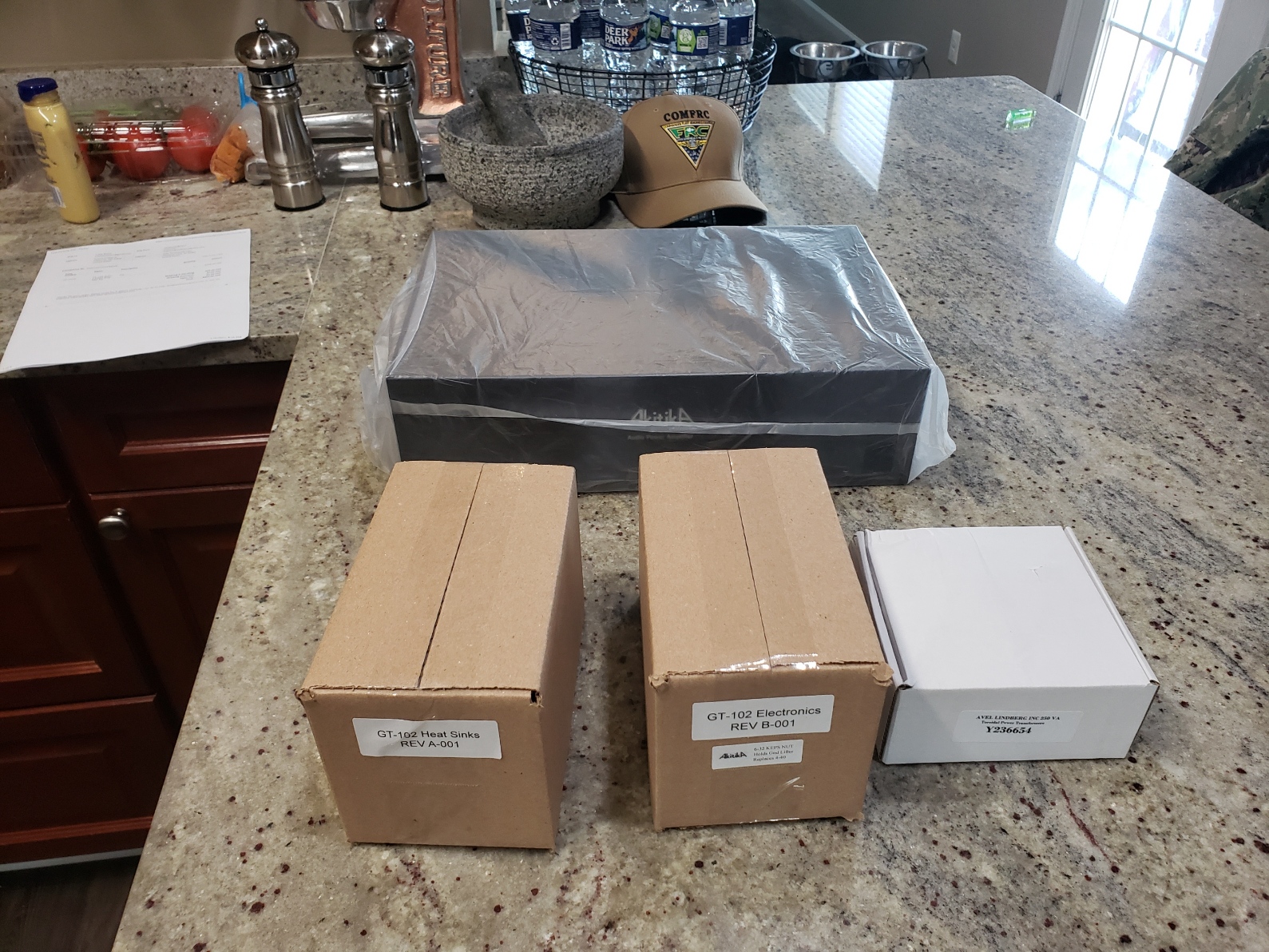

Thanks to sage advice from @Mark Johnson and others I ordered the AkitikA kit. The kit just arrived and I have the house to myself for a few days so here we go....
It will go together 3X easier than ANYTHING you see on the diyAudio website. Including both of the products in the diyAudio Store, designed by me. You've paid for top flight, first class support / instructions / kitted contents , and that's what you got. Your first project will be (comparatively) easy, and it will help you discover just what you can do, when motivated.
edit- put away the beer. Take out the Anejo tequila.

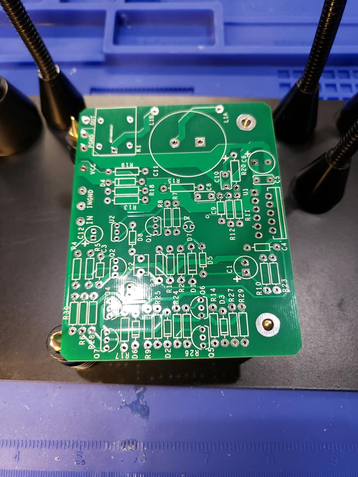

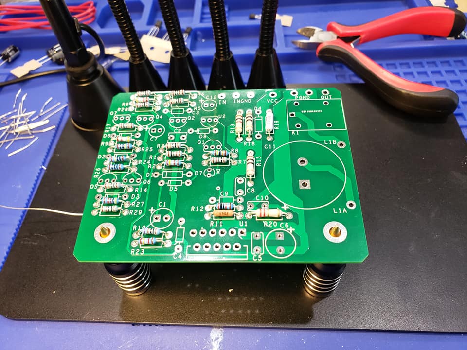

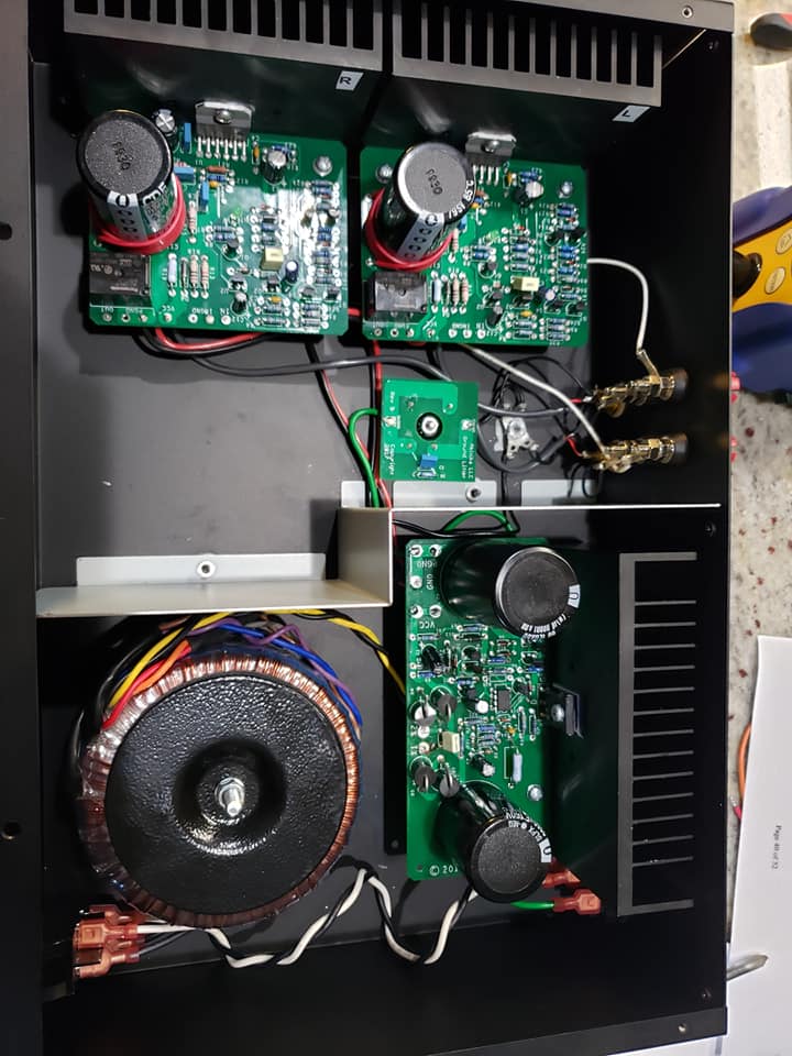

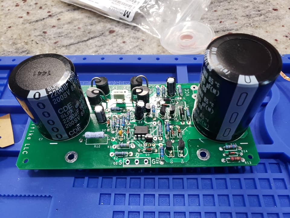

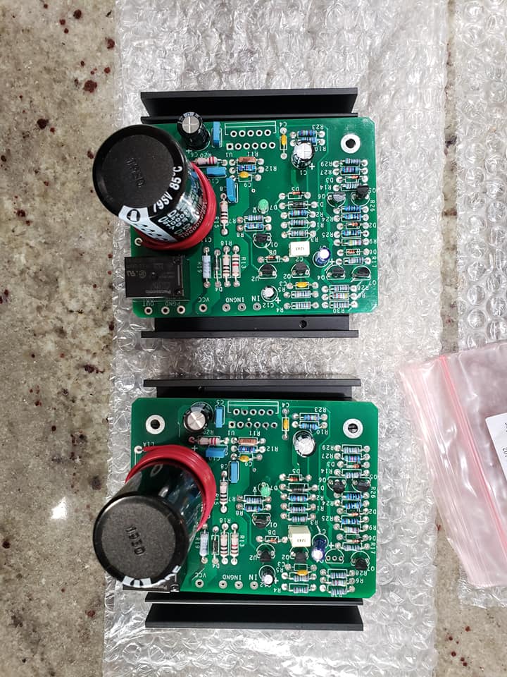

All done. Started work on Friday and finished up Sunday afternoon. The kit went together really well, the directions were great and I am glad I went this route to get my feet wet and build some confidence. Starting here was great advice. It is downstairs now playing and settling in. Sounds great so far.
Stuffing the boards was easy peasy...
https://www.diyaudio.com/forums/attachment.php?attachmentid=968207&stc=1&d=1626699531
https://www.diyaudio.com/forums/attachment.php?attachmentid=968208&stc=1&d=1626699531
68209&stc=1&d=1626699531
https://www.diyaudio.com/forums/attachment.php?attachmentid=968211&stc=1&d=1626699531

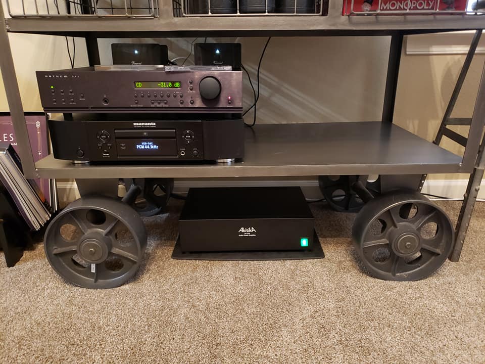

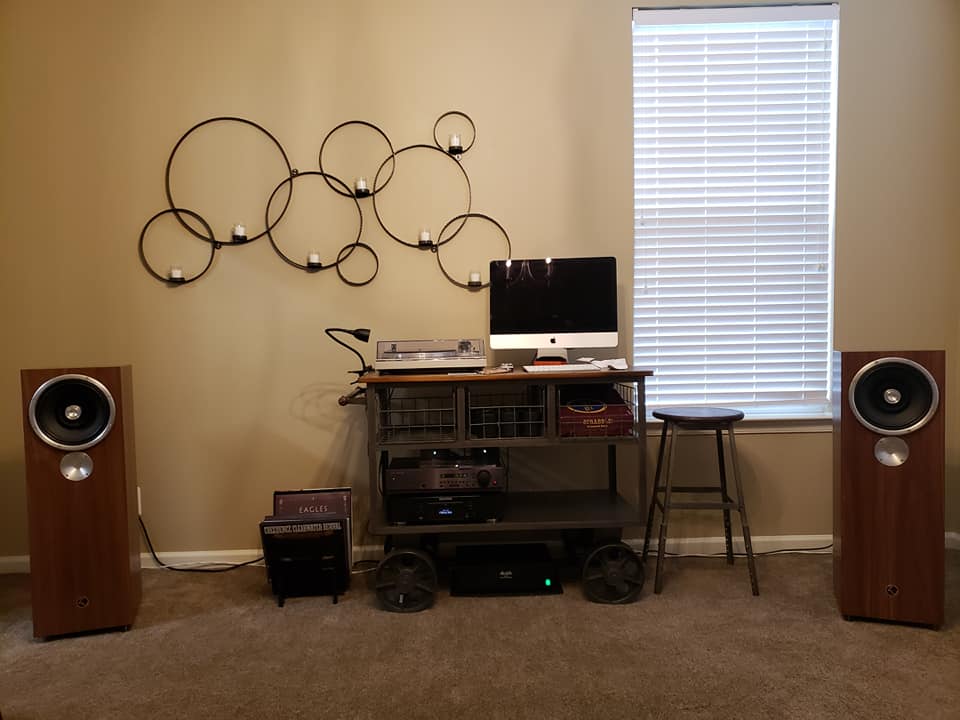

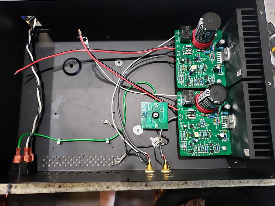

All that left was wiring and loading the chassis, then it was time to test and hook it up for a test drive.
https://www.diyaudio.com/forums/attachment.php?attachmentid=968212&stc=1&d=1626699531
https://www.diyaudio.com/forums/attachment.php?attachmentid=968214&stc=1&d=1626699531
I think I will start collecting parts for my next build shortly. Cheers,

That was unreasonably fast!
A regular build with going back and forth between designs, putting together several BOMs, ordering from several vendors, discovering that you already have these parts in stock, putting off metalwork to finish the chassis, stuffing pcbs, procrastinating doing the internal wiring while working on another build that has also been sitting on the bench for too long, firing up the amp late at night and not daring to hook it up to the main speakers ... all that usually takes months!
Don't get used to the pace at which you just finished your first build 😀

Congratulations Caleb! There's nothing more gratifying than success on the first try. Best wishes for even greater enjoyment, as you take on more ambitious projects.
Very nicely done. Congrats on your successful build.
Looking at the pics, can someone remind me about the whys and wherefores of wrapping wire around electrolytic capacitors?
I see it here in this build and I remember seeing it employed in early Dynaco solid state amplifiers (ST-80, ST120 etc).
No doubt related to some form of inductance but what is the advantage of doing of wrapping the wire around the capacitor?
Is the cap simply being used as a form or is there more to it than that?

Curt,
According to the supplied schematic the wire is acting as an inductor in parallel with a 10 ohm resistor. The provided theory of operation indicated that this circuit provides load matching to allow the amp to drive a variety of loads. The attached pages explain in a little more detail. Hope this helps!
Caleb
Akitika Was based /derived from an upgrade of an ST120. No surprise that it reuses the wound on the caps 'coils' . Besides , they do their job.
That said My Kit sounds pretty darned good TBH. Not as good as my F6 but not massively less either 😉.
It's a Good 'un... enjoy it.

Question - I see the discrete diodes on the power supply board, that I am assuming are the diode bridge. Do those get hot during operation?
And what is the small square circuit board near the two amp boards, on that side of the RF shield?
I am probably going to get the DC scraper, if I get this kit - my system gets a very audible 60Hz hum/hiss at times, coming from the speakers. And I may ask AkitikA to send a second DC scraper, that I can put into my B&K ST-140.
The other amp that the GT-102 reminds me of, is the Audio by Van Alstine AVA Vision SET-120. Which is also 60W/ch, but puts out (nearly?) double into 4 ohms. It also costs $899.

Mark, thanks for clarifying - I did think of the Dynaco, but I wasn't sure. And I had heard their history, but forgot this part.
And thank you for saying how this is a "chip amp". That term makes me think of an IC, so understanding what "chip" means in this context is helpful.
Any thoughts on how it is that the GT-102 doesn't have/need and bias trim pots? Is the bias level set with part of the discrete circuit, and if so, is there any advantages / disadvantages in terms of sound quality, or longevity, etc?
It certainly makes building it easier and less touchy. I have recapped and rebiased my B&K ST-140 - it had drifted A LOT from stock specs - I think it is supposed to be ~210mA? The left channel was at about 340mA - and the right channel was about 510mA !! My black anodized heat sink is a beautiful pink/magenta, after having been run 24/7 for a good portion of the 34+ years I have owned it.
