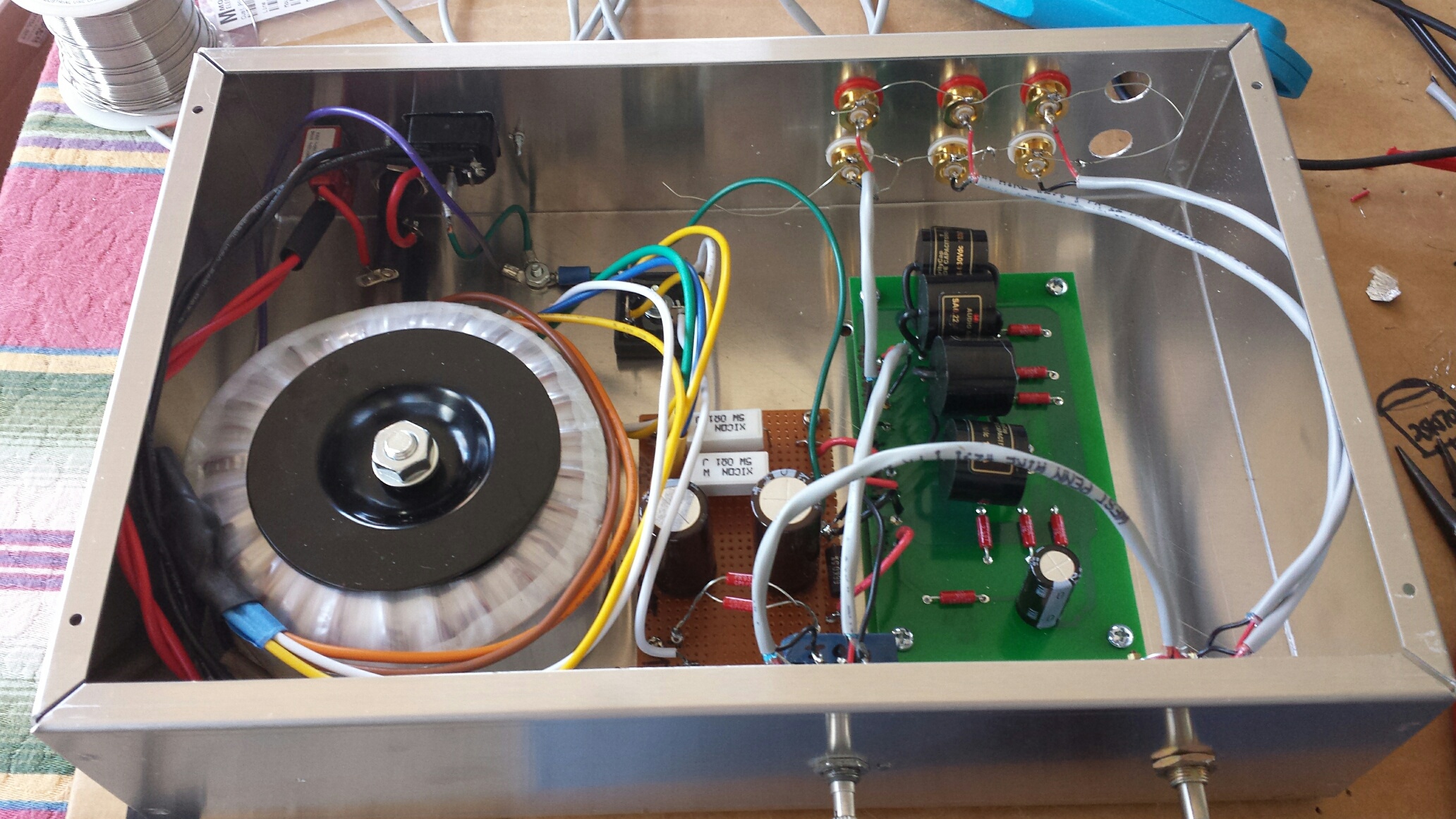

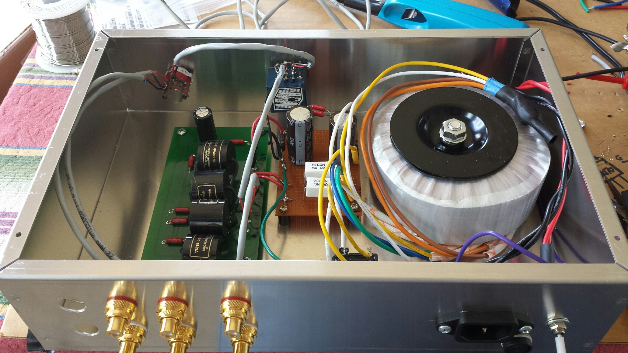

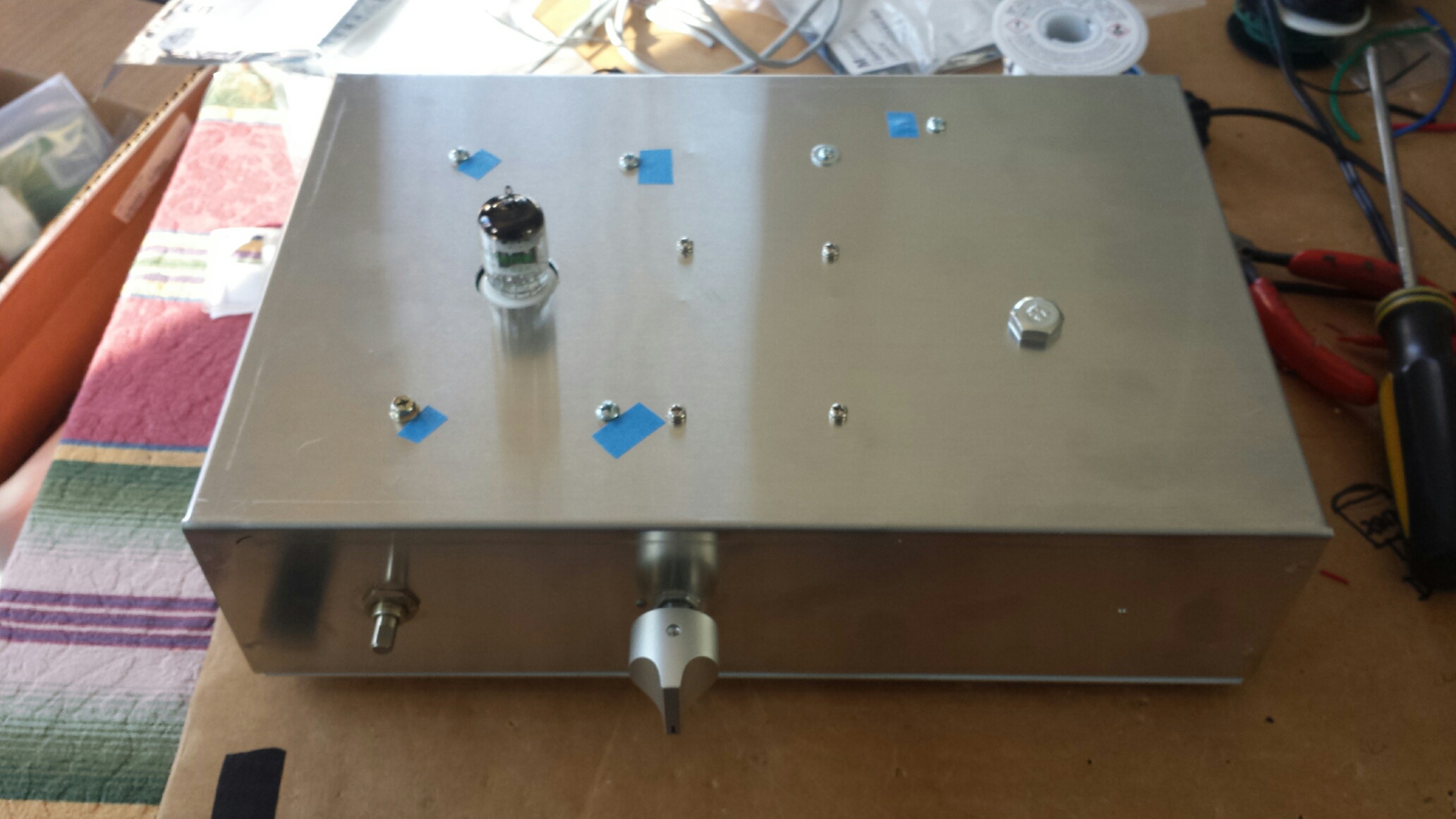

Was able to get the S5 circuit built over a few weekends.
Plenty of gain to drive the First Watt F4 without changing resistor values.
I think it sounds pretty good out of the gate.
Has the tube sound I was looking for.
Would have been disappointed if it sounded like a transistor preamp. 😀

Question about the cathode resistor capacitor voltage.
I measured 1 volt across the cathode resistor.
Would a 47uF 25v electrolytic be safe or does the voltage across it change with a signal?
I picked up a 60uF MKP 300vac, but it will not fit in the case.
They are 2.25"D x 2"L.
thanks,
Vince
The 6922 filament are not lighting up.
Using the Electro-harmonix gold pin 6922.
Is the 6922 really a direct drop-in replacement for the 5670?
It's ok if it's not. Will send it back.
