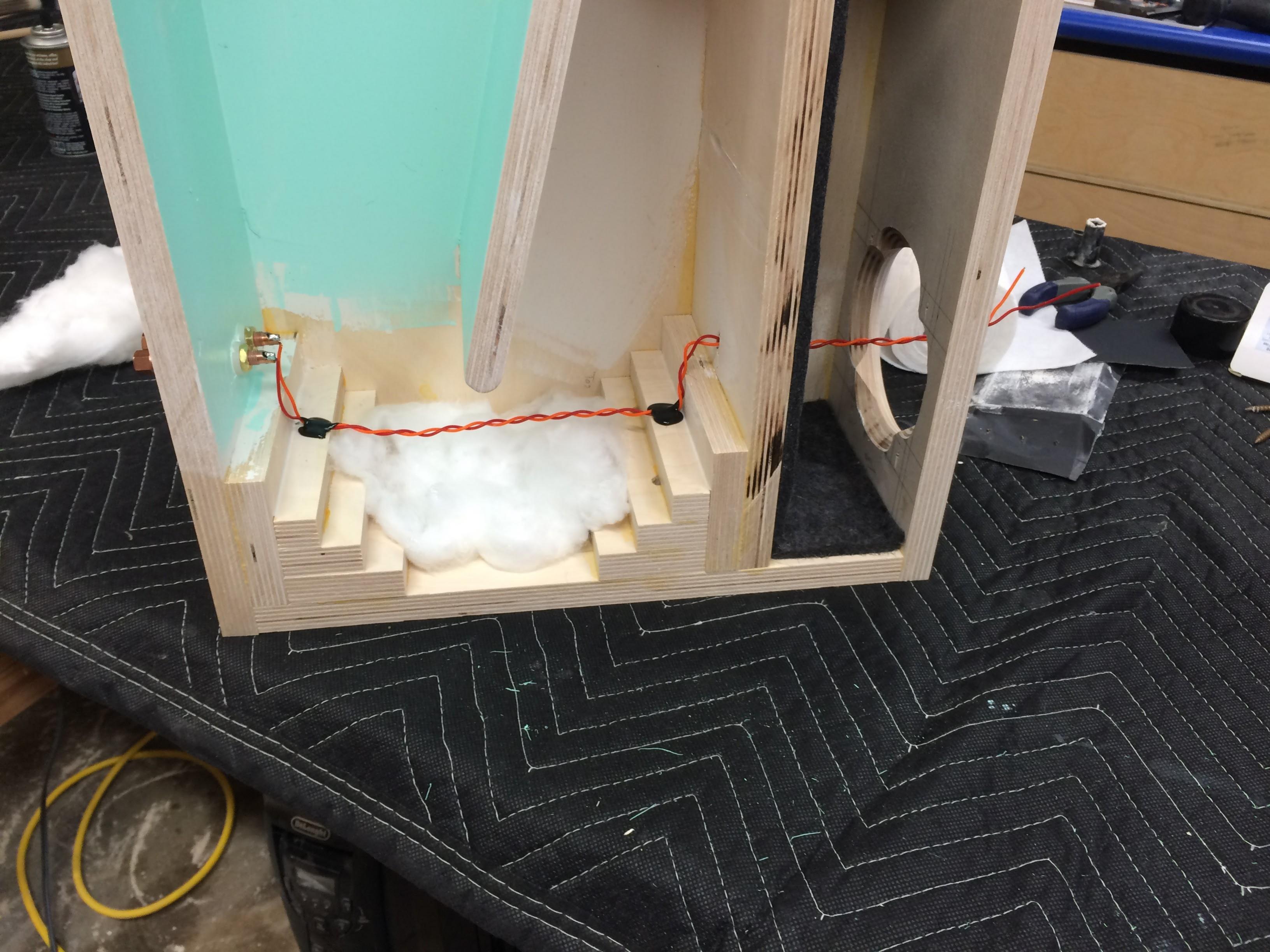

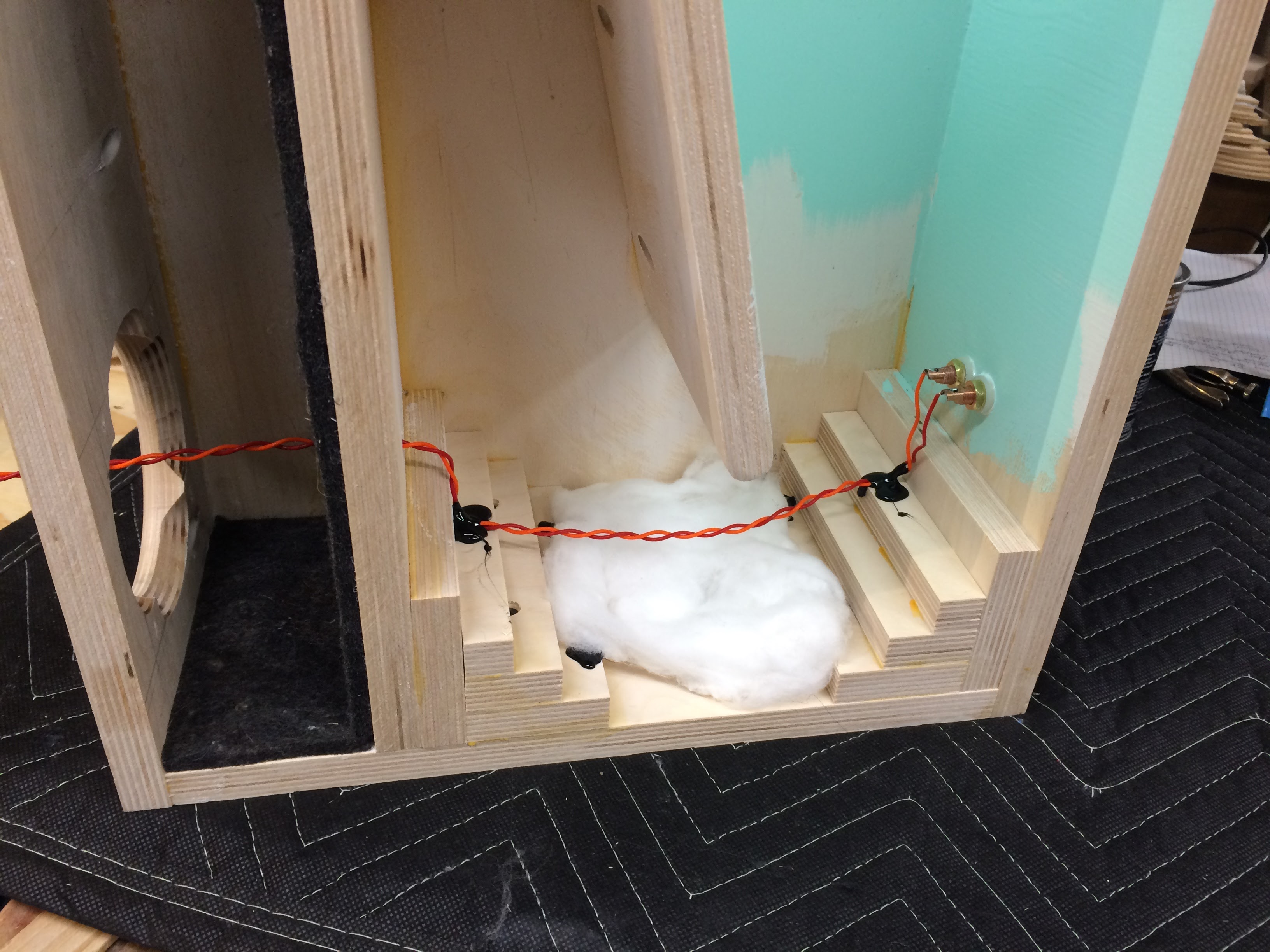

first time building speakers. Almost finished with one bk-12 speaker, but before i seal the other side, I'm wondering if I'm doing the stuffing right and if there's anything else i should do.
Also, should i add more stuffing, like it says in this image below? Original instructions don't say anything about this...
it looks sensible per that drawing. If you have a few clamps laying around to temporarily hold the side in place , you could experiment with density and position a bit by "ear" before gluing that panel into place.
I built some a year or so ago. I put a little bit of stuffing at the top of the transition, similar to the drawing.
