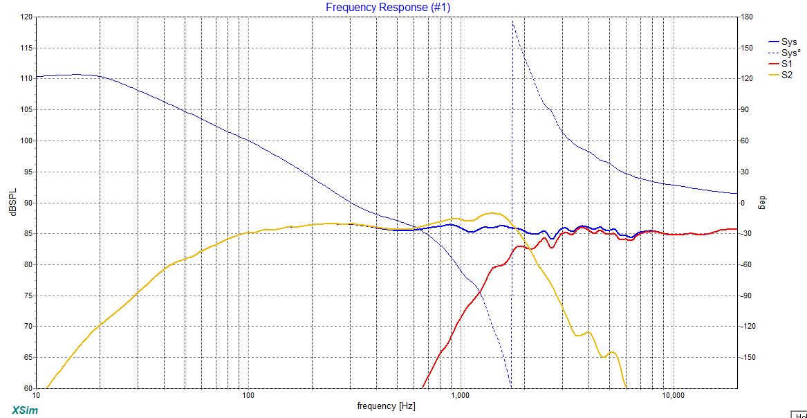

Hi guys, I am new to the forum and also my first time designing a crossover for a 2 way speaker. Done it using XSim and attached are the frequency responds and Impedance curve. Do the curves look alright or is there something needs to be corrected. Look forward to your comments.

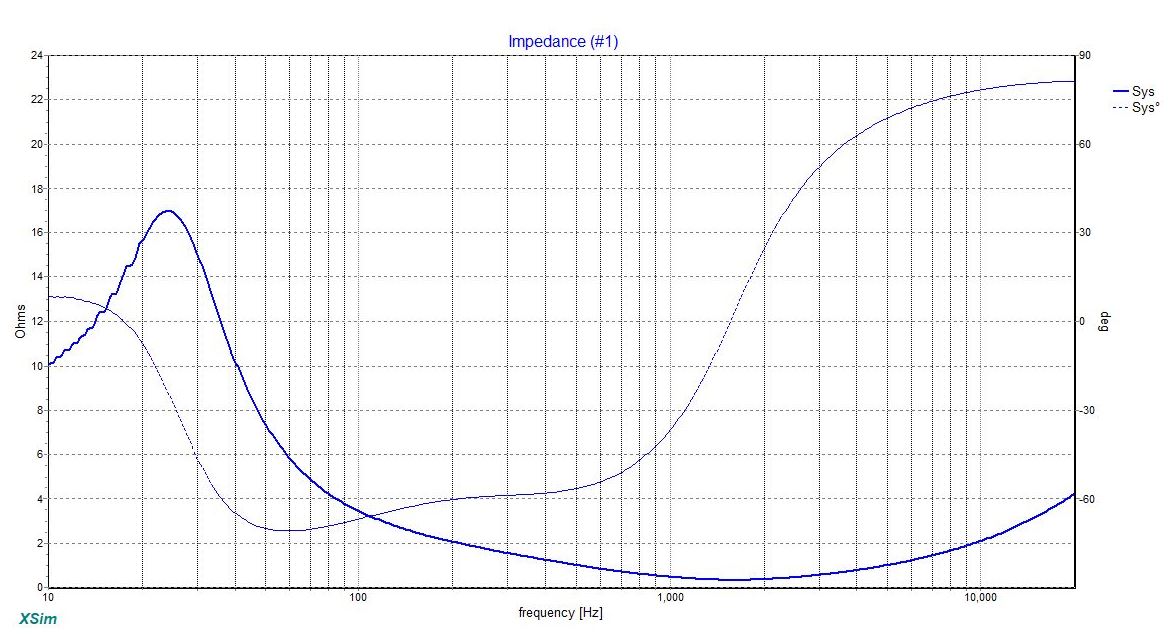

One concern I have is that your impedance gets quite low, and typical amplifiers would have a problem with that.

There is a need to know more about the design. Namely the speakers used and the crossover circuit. Basically the low impedance is an indication of a serious problem as pointed out by Allen B.
Thank you for the comments. The low impedance also worried me a lot. After reading your comments, I went over my XO circuit again and found out that the low impedance is mainly caused by an inductor in the tweeter circuit. After adding some resistors to it, now it looks much better. Care to comment on the new impedance curve?

Show us a Frequency Response plot where you remove the system phase, but instead display the phase of each driver.
At 1.5 kHz, your woofer response is several dB higher than your system response... this makes me suspect that your tweeter is partially cancelling your woofer in this region. It is true that this can result in a flat system frequency response, it is also true that it may not sound good. It is better if the woofer and tweeter are in phase with each other at the crossover frequency, and each is down by about 6 dB... then they just add together nicely.

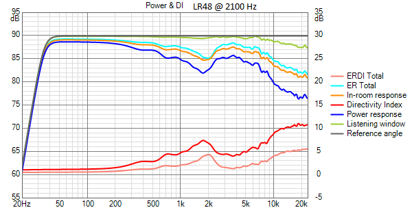

Show us also power response, off-axis polarmap -180...+180 deg hor & ver, listening window rms, early reflections rms and estimated in-room response.

The on-axis SPL curve looks okay, but that does not mean the design will sound good. You'll need to consider the off-axis SPL curves in order to check if the dispersion and power response is right, which is needed to learn anything about "how it will sound".

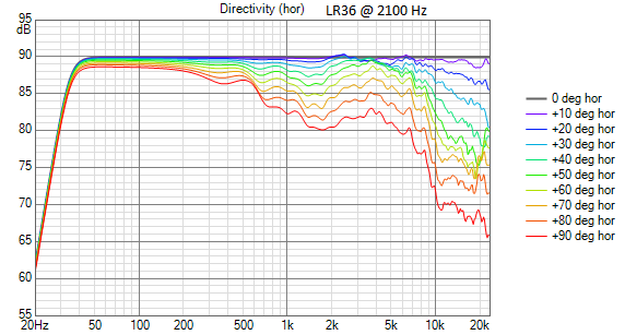

He is crossing a 7 inch driver to a 1 inch tweeter at about 2100 Hz. That fact by itself will pretty much determine the horizontal off-axis performance. If he gets the on-axis response right, the off-axis response will be acceptable.

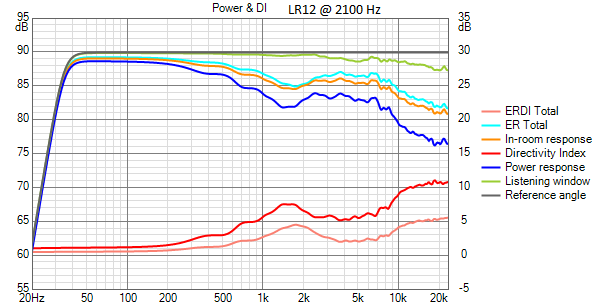

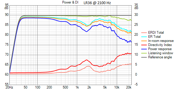

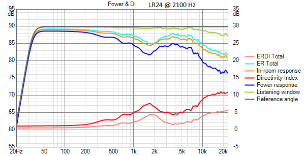

Off-axis performance depends also on box shape/diffraction, location of drivers, crossover slopes and phase matching. Typically off-axis performance of 7"+1" (w/o wave guide) could be okay with straight axial response and phase match on-axis when acoustical slopes are not steeper than 2nd order.
Few examples with 6.5" woofer and 1" tweeter. Box size and shape are not optimized specially for this driver combination and XO frequency so none is acceptable with flat axial imo. Acoustical 2nd order is the smoothest, but flat on-axis produce dip due to exact phase match at XO.
The horizontal off-axis will be acceptable, but what about the vertical?He is crossing a 7 inch driver to a 1 inch tweeter at about 2100 Hz. That fact by itself will pretty much determine the horizontal off-axis performance. If he gets the on-axis response right, the off-axis response will be acceptable.
If you look at the OP's frequency response plots, the drivers are only summing to about +2dB at the crossover point, so the phase alignment is somewhere more than 90 degrees out of phase. The result of this is that there is (worst case) a +4dB peak aimed towards the roof, and a null aimed towards the floor or vice versa. In a real world room, this means that the on axis response is no longer flat, as the reflected peak will probably still be heard. A link-witz riley alignment (0 degrees / in phase) means that only nulls can be produced vertically off axis, which are far less audible than peaks.

The first set of pictures show a severe phase response anomaly around crossover. You want both drivers to show smooth rolloff in the crossover region, instead one driver is clearly rising. The flat axial response curve is not sufficient to illustrate the problem with the crossover. You will need to look at individual and combined phase response as well.
We ideally also need info on the drivers for a slightly more informed reply. There are a number of other considerations, such as time-alignment and impedance. Impedance is clearly a problem with the speaker, it's an amp-killer.
