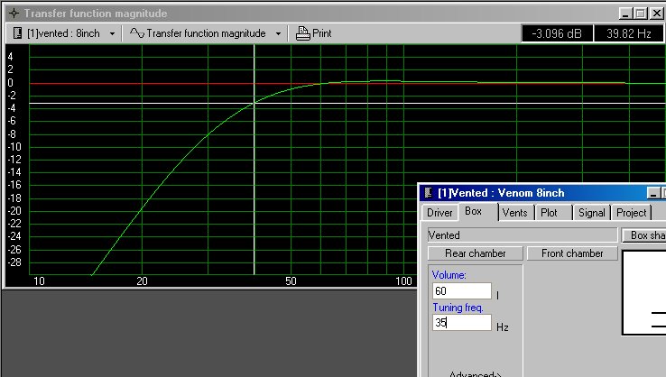

seeing as how I am also talking about a computer sub using 8inch driver(s)... and the "having the last word" thread was closed...
I thought I would ask here.. lol
what do ya think of these?
http://www.advanceae.com.au/car/prod4.htm
I was thinking of putting 2 in a 60litre box tuned to 35Hz... looks something like this... lol anyway.. I have no money... but I was wondering what you guys thought of these "subs" maybe I should just finish my towers first... 🙄

I tried simulating with 2 of the the Peerless, which are cheaper, in a 70L/30Hz and it mimics yours frequency response except giving better extension as well as more SPL. But then I am still learning. Take my words with a grain of salt. =P
Is it just me or is that site way more expensive than others? Their Peerless XLS 10" is almost $300. You can probably find better than that venom driver, it only has 5mm of xmax but it looks like they tried to make it LOOK impressive with that big surround. Try ebay and see if there's anything decent on there with the right ts specs. I got my sub driver for $40 off on ebay and it has a return policy and full warranty and all that, there's some good deals to be had if you wait for them to pop up. To lower the Q you could try an aperiodic vent if you do a sealed box, and a bass boost could lower the f3.
