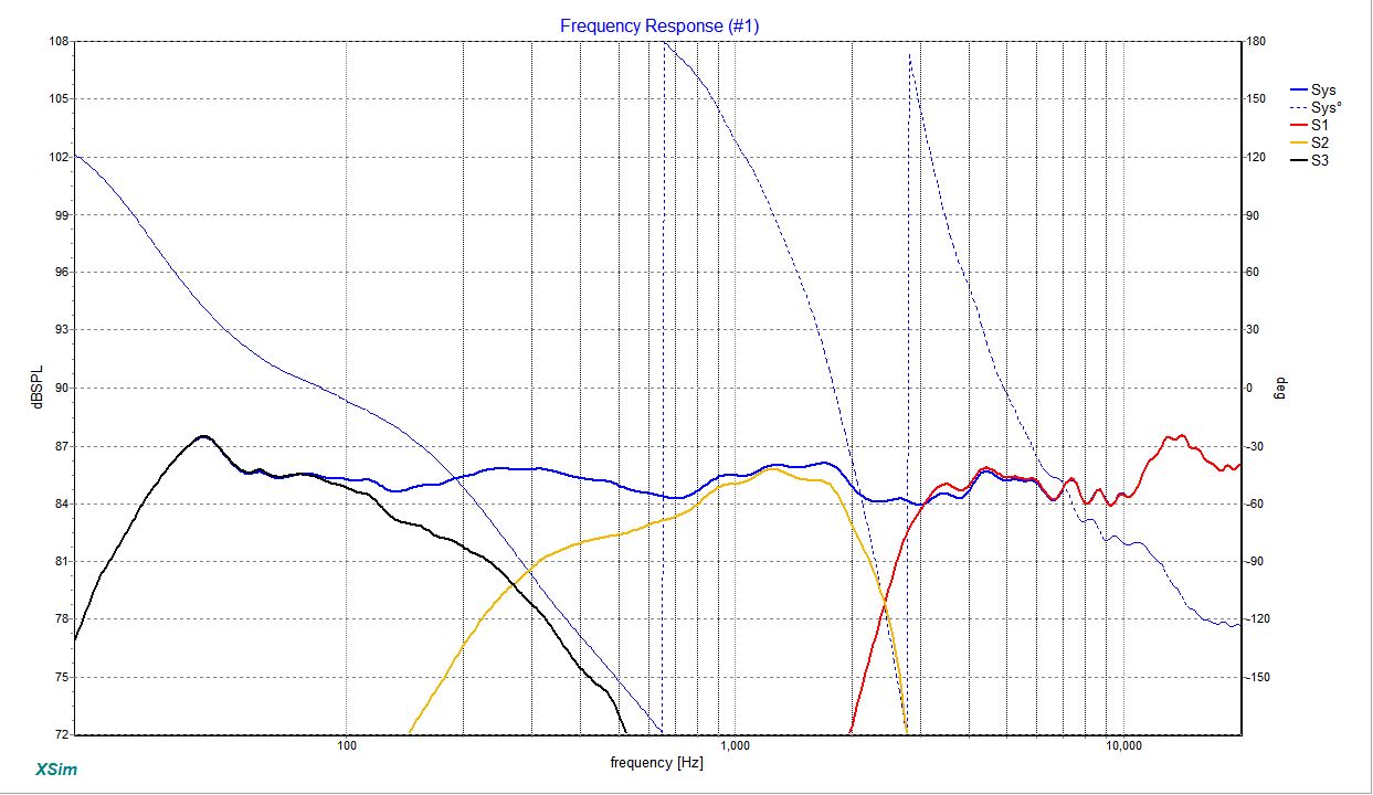

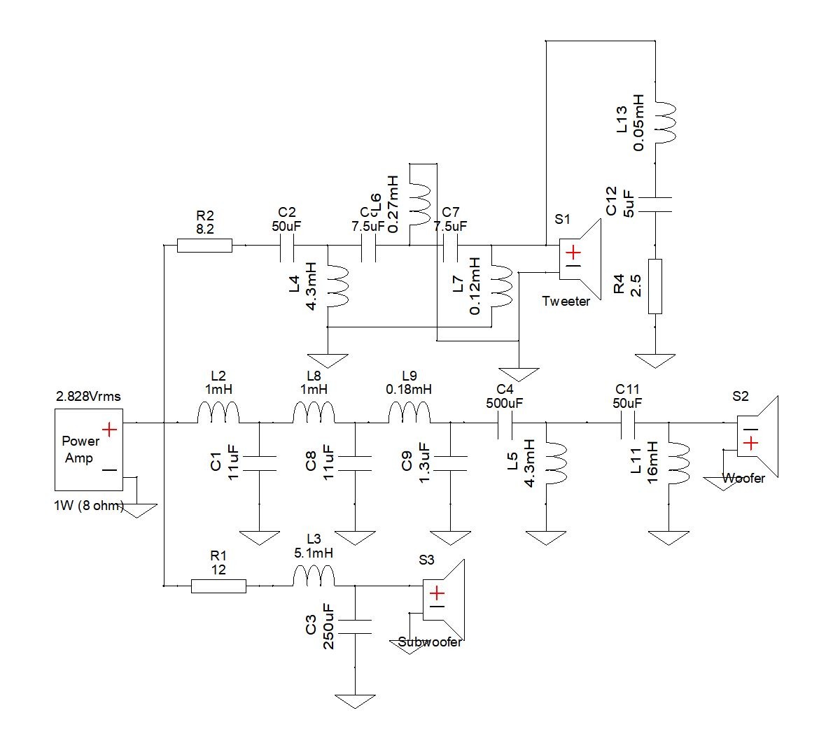

I've been attempting to learn Xsim over the last several nights trying to work out a crossover for an upcoming project. I think I have a beginner grasp of what to do in regard to leveling out the frequency response, but I feel lost when it comes to keeping the phase in check. I also am unsure what my goal is for the impedance chart so any pointers there would also be of great help. Please let me know if I'm massively screwing something up with this 🙂 I have attached screenshots of the charts and wiring diagram and the project file.

Anything else aside, the crossover looks extremely complicated - I've never seen one as complex.
Have you tried using fewer parts, as that one will need a lot of readies thrown its way.

Yes, curious about the source of the measurements. Then we can discuss sensitivity, phase and the woofer resistor.
First you'll want to turn on phase. Here is a tutorial on Xsim plot window configuration..

If you can acceptor a XO with that amount of components you might perhaps want to try xMachina XO software...

I used the measurements provided by the manufacturer. I know this will be massively effected by the box and room later but I need something to start with.
Tweeter - GRS RT3.0-8 Hi-Res Neo Ribbon Tweeter 8 Ohm
Woofer - Dayton Audio RS225-8 8" Reference Woofer
Subwoofer - Dayton Audio PA310-8 12" Pro Woofer 8 Ohm

I'd begin by assuming a 6dB baffle step. Remove the woofer resistor entirely and attempt to level the response without it, in accordance with baffle compensation. (If it isn't essential, and usually it isn't, the resistor is only getting hot where it is.)

This "subwoofer" will have a quite limited low-frequency extension, according to the Dayton design specifications. It will only go down to 73 Hz in an appropriately tuned vented-box enclosure, due to its moderate Qts value and relatively high free-air resonance frequency of 39 Hz. If you plan on adding a separate powered subwoofer, then that's not a problem.Subwoofer - Dayton Audio PA310-8 12" Pro Woofer 8 Ohm
The PA310-8 woofer also has very high sensitivity, 96 dB, which makes it quite difficult to match up with other drivers that are usually found in domestic loudspeaker systems. Hence, you've discovered the need for a large series resistor in its signal feed, which is generally not a good idea.
On its own, this woofer can go down to 38 Hz in a vented-box system, according to the design guide. That's almost a full octave lower than the PA310-8. Maybe it could be used on its own, subject of course to your specific maximum SPL requirements?Woofer - Dayton Audio RS225-8 8" Reference Woofer
Your use of a 6th-order low-pass filter (LPF) on this driver is a bit unusual and will be quite expensive in terms of parts cost. A 4th-order LPF/HPF system would probably meet your design goal of minimal frequency overlap between the woofer and the tweeter.
