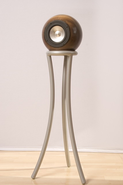

Currently setting up a small loudspeaker design company in old Blighty, using the excellent Jordan JX92s for our monitors - below is an image of the first prototype to give you a little taster...

Cute speaker... how do you deal with the internal resonance of a sphere?

In answer to your question, the size and thickness of the wooden sphere makes it very stiff, which so far has stopped any problems with it resonating.
I was concerned in the early stages with using a real wood, however many people who I've discussed the design with, particularly those designing very expensive esoteric loudspeakers [many times the size and cost of mine] use woods like walnut, oak and Epée to brace as it is often stiffer than MDF.
Eventually we decided to suck it and see, and we were all relieved with he results.

I was actually inquiring about the strong standing-wave resonance that builds up in the centre of the enclsore

First, the internal layout is not a perfect sphere, the rear is flattened and the driver at the front 'slices off' some of the sphere so it isn't really a problem.
Second, the internal surface isn't finished like the exterior and is left rough, and finally the insides are hand coated using a sealant, which helps to break up any smooth reflective surface.

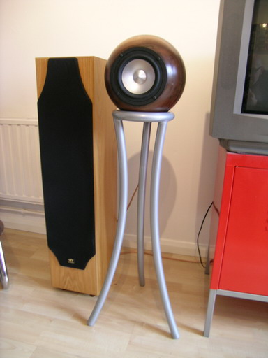

Yes natural wood finish, I'll get some more photos up as soon as I can, as my amateurish photography isn't quite up to scratch !
