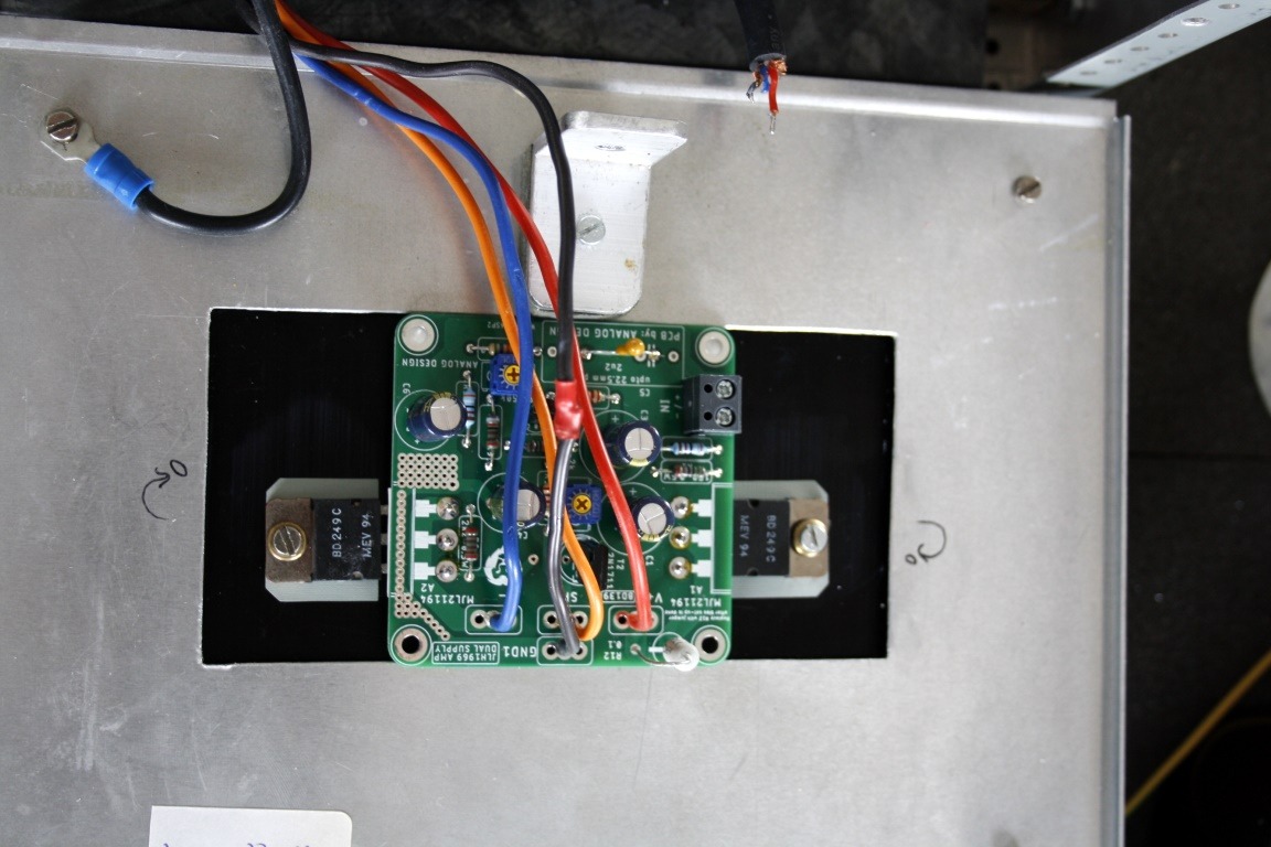

I build myself a JLH and I have yet to find a better sounding amp. And I heard many.. 🙂
It's only 2X 10W but plenty for my use.
https://sound-au.com/tcaas/index.htm

Yes I like the JLH amps. I built the high power ESL version a few years ago but it wasn't really upto the job of driving a complex load like a hybrid ESL (ML Aeons)
BUT you can't run them off 12v DC so will need to rethink your power supply.
PCBs are widely available on ebay etc.

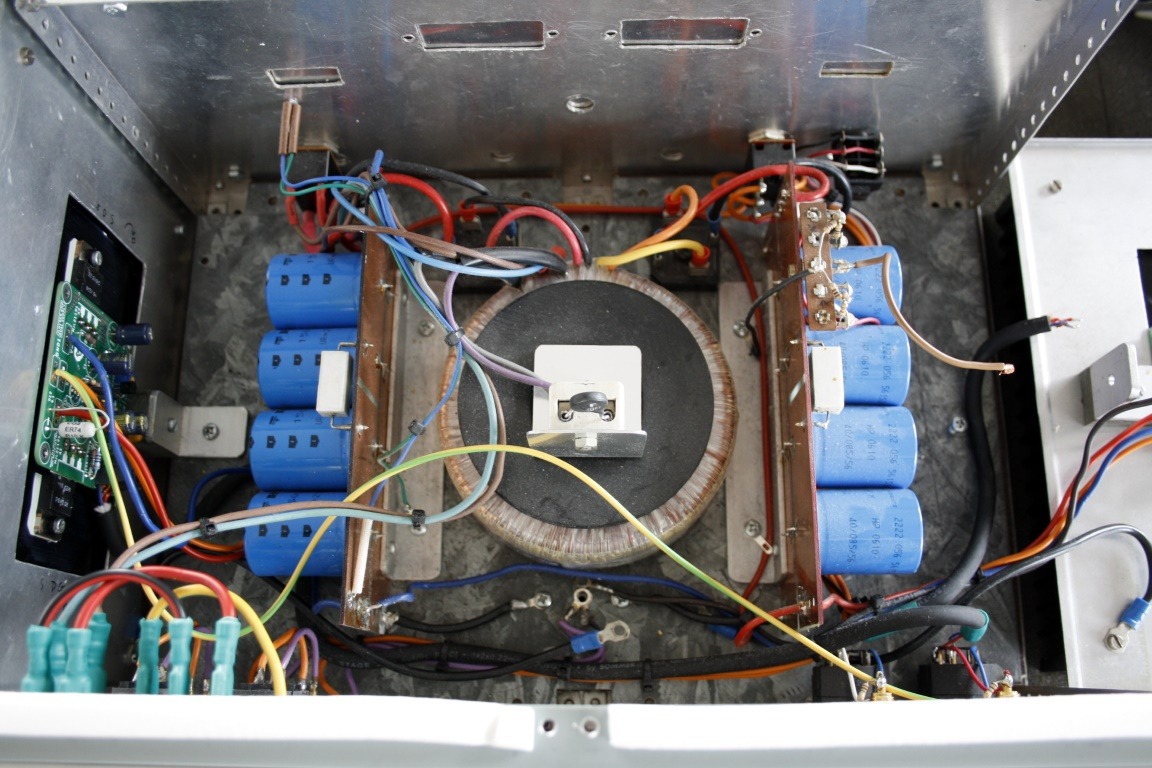

I swapped the 500va linear supply of my Krell KSA50 clones for a pair of 300w 'audio grade' + -36v SMPS from this company:
https://hifimediy.com/product-category/power-supplies/
I was testing them yesterday and was happy with the noise spectrum and level.
They seem expensive, but a 500va Toroid, rectifiers, and .1F of smoothing caps wasn't much less and both of the SMPS modules fit inside the amp chassis.
They also have a +-12v output which I used to operate the speaker protection and drive a 5v cooling fan via a separate small LM317/337 regulator module.
