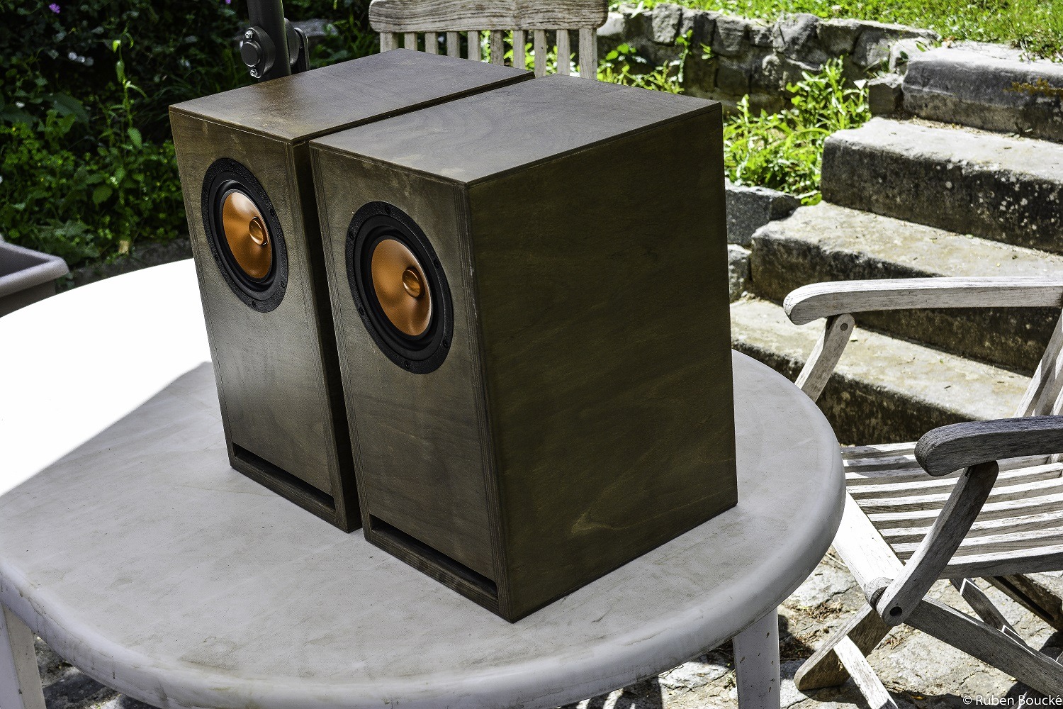

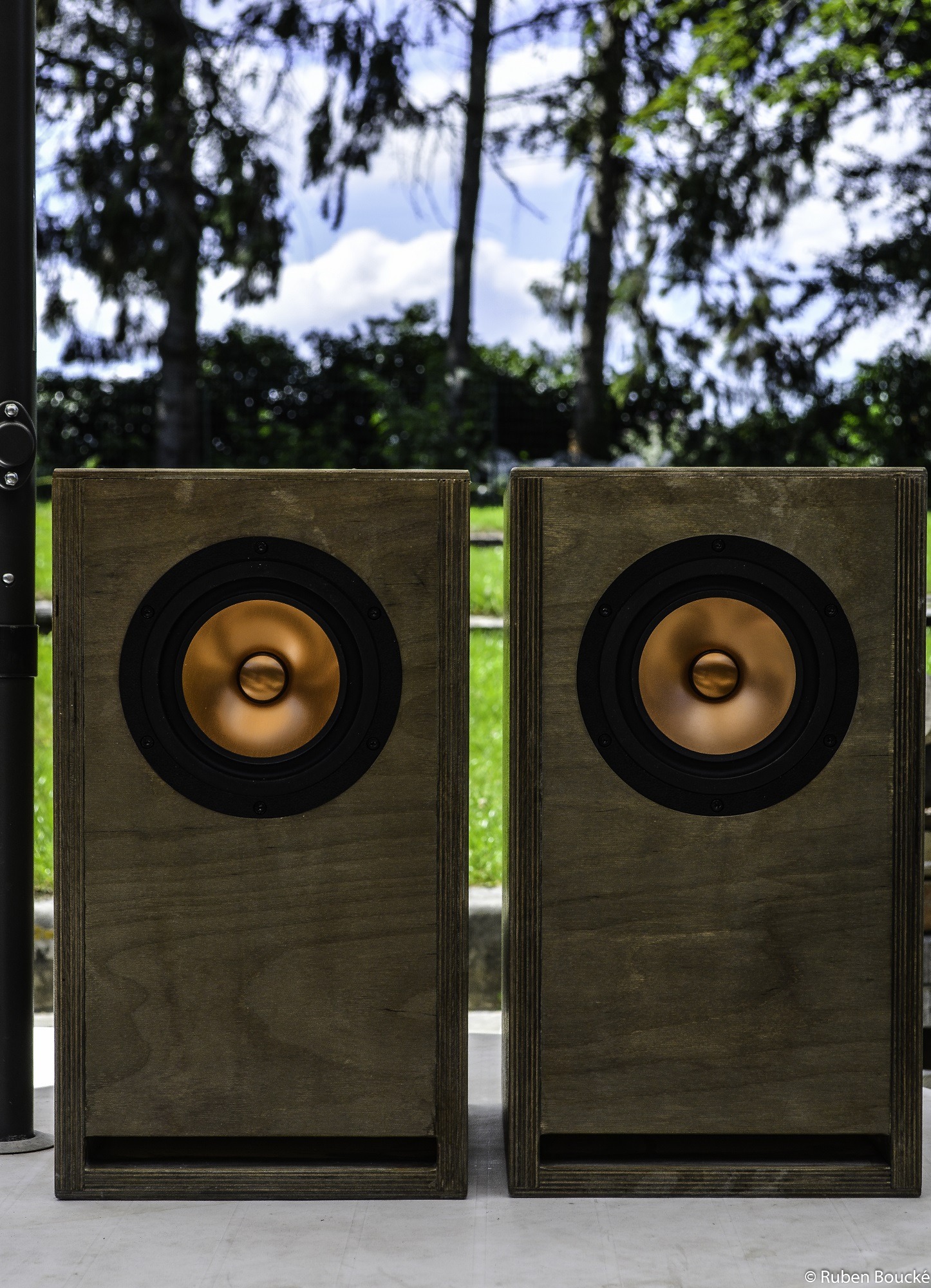

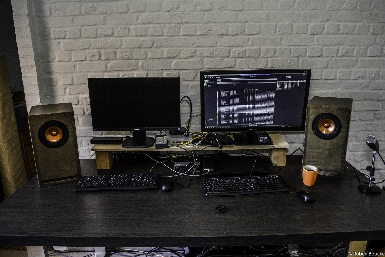

A speaker like that i'm very happy with is this own design with the Mark Audio Alpair 10.3. I use it as office speakers, and use them daily.
The cabinet is a 17.9L reflex tuned to the 45Hz. The wood is 18mm birch ply but teinted. plans are here:

those look amazing! Size wise they look pretty much spot on.A speaker like that i'm very happy with is this own design with the Mark Audio Alpair 10.3. I use it as office speakers, and use them daily.
View attachment 1151107View attachment 1151109
