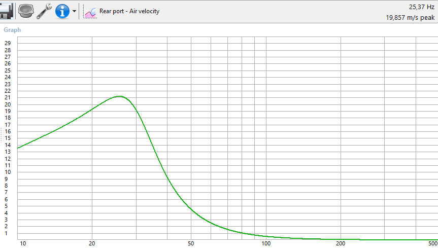

I have included a couple of screenshots from WinISD and the drawing of the enclosure.

At the maximum 300W power, the volume is much higher than required, but the port velocity also goes up 24 m/s. I am most certain this would create a lot of port noise. However, I think at 200W I already have quite the volume for my space. At that power level velocity caps out at 20 m/s. I have seen the guideline 18 m/s max. Is this expected to be a problem if the port end is rounder off? Obviously I only care about port noise in real world scenarios and not test tones.
I found a lot of people finding that for these long port lengths, the required length for the tuning is actually shorter than calculated. I am hoping for this effect, as all desired parameters will improve in this case. I would be more than happy with the calculated results.
