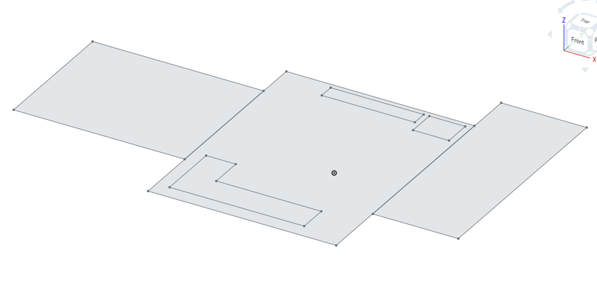

This is going into a basement, where the only use will be TV/movies/light video gaming. I have two younger kids and my wife in the house, none of whom are craving bass. Honestly, I would only ever immerse myself in an action film (i.e. enough to shake the house) a few times a year. The speakers are Polk RM20's and there is currently not a sub. The goal for this project is for me to get a subwoofer into the system and to learn a bit on my first sub build.
The primary listening area is about 11x14', but there are areas off to each side - ~5x12' and 10x12'. My budget is unfortunately small, but it's what I have - $175 for driver and amp. I've got a space about 2.5x2.5x3' for the sub, but that's the max I can probably go.
I'll try to post some drawings of the room. Would a 100w amp be enough? What size driver would you recommend? I'm looking primarily on Parts Express. I assume eBay class D amps are not recommended? Looking to get the most bang for my buck... Thanks for any advice you all have!
I added a rough image of the floorplan if that helps. The couch is the L-shape, the TV is the long rectangle, and the square is where the subwoofer will go. The whole space is open; disregard the lines between the three primary sections.

Maybe go for a Dayton 10 or 12, with a Dayton plate amplifier? Build a box with a slot port. Model in Winisd, ensuring you consider that the excursion can go a bit ballistic below tuning frequency, therefore a subsonic filter is required. Most plate amps have a subsonic filter but you need to check the specs, or questions posted on parts express as others may have answered.
OK, the side rooms will act as very high tuned band stop filters that will put a couple of suck outs probably somewhere in the main's response.
Tiny budget with decent size sub box allows multiple cheap drivers = less amp power required, so will take me awhile to do any driver/amp browsing to see what's available since I assume the amp will consume most of the budget and won't know how much power is required until the drivers are chosen.

If it's the same surface area, the length will be the same. For example, a 4" diameter circular port has an area of 12.5 square inches. If you have a rectangular slot port 1inch x 12.5 inch, it will also have a surface area of 12.5 square inch. The lengths will be the same.
