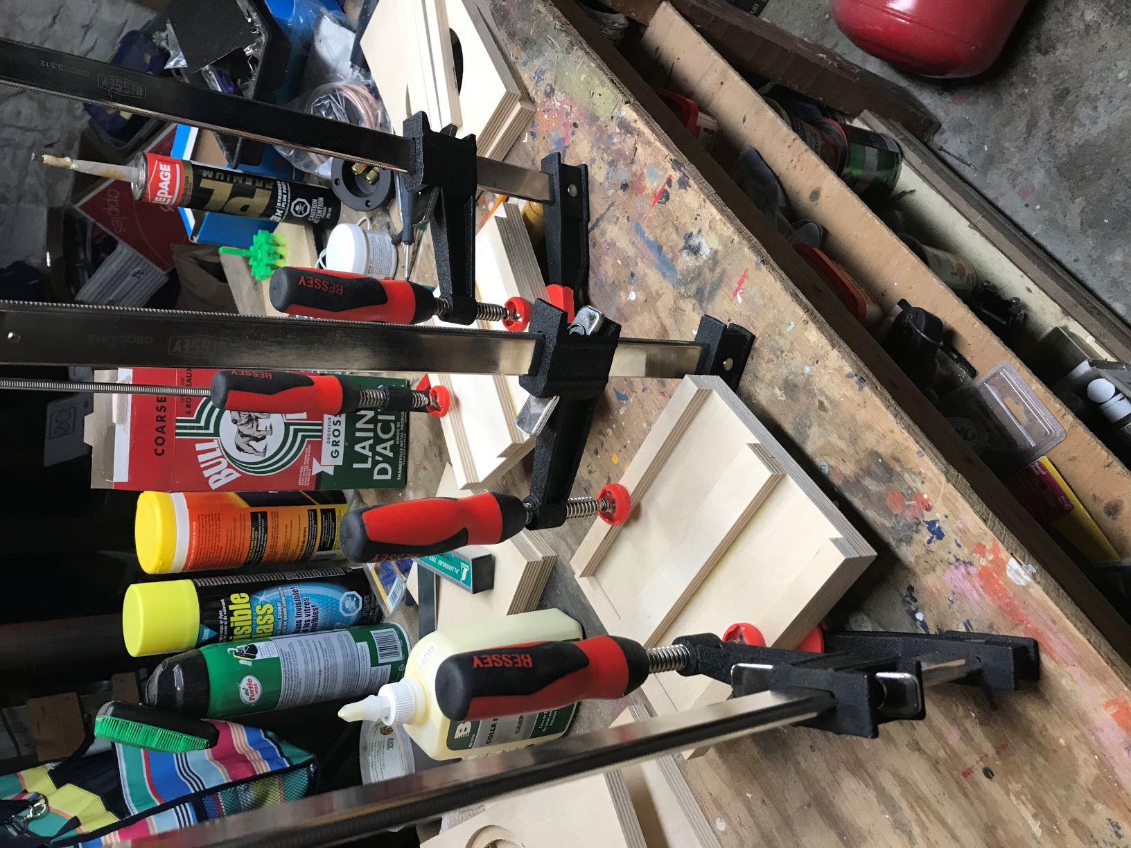

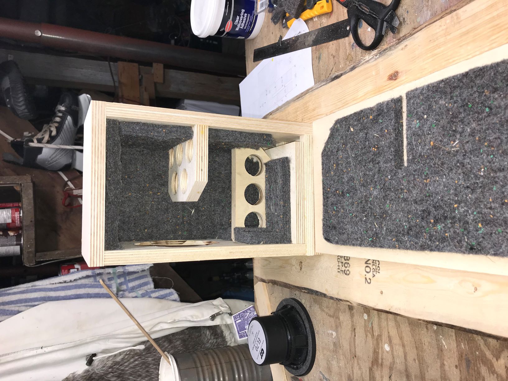

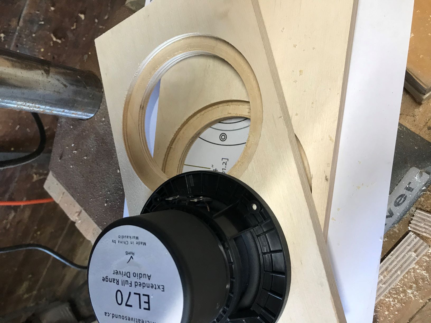

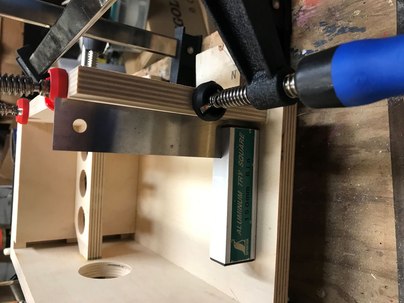

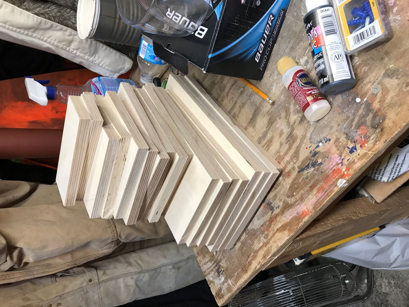

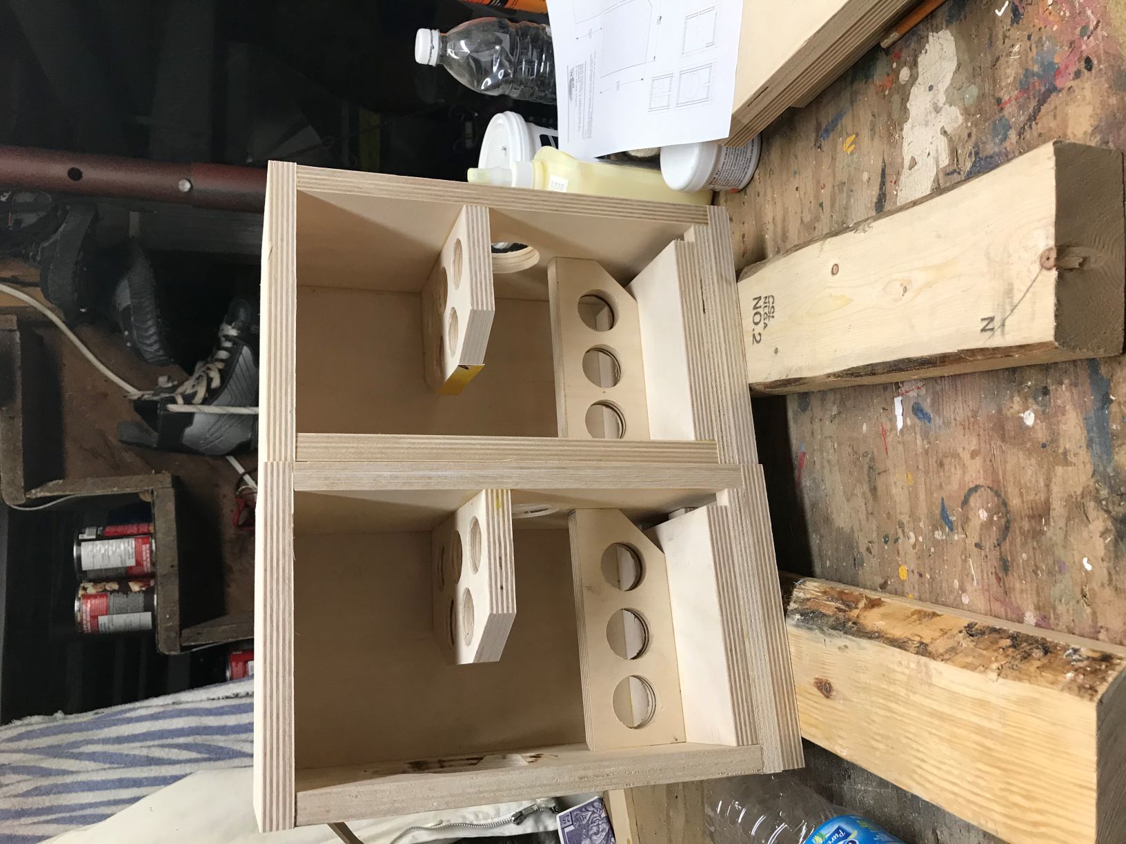

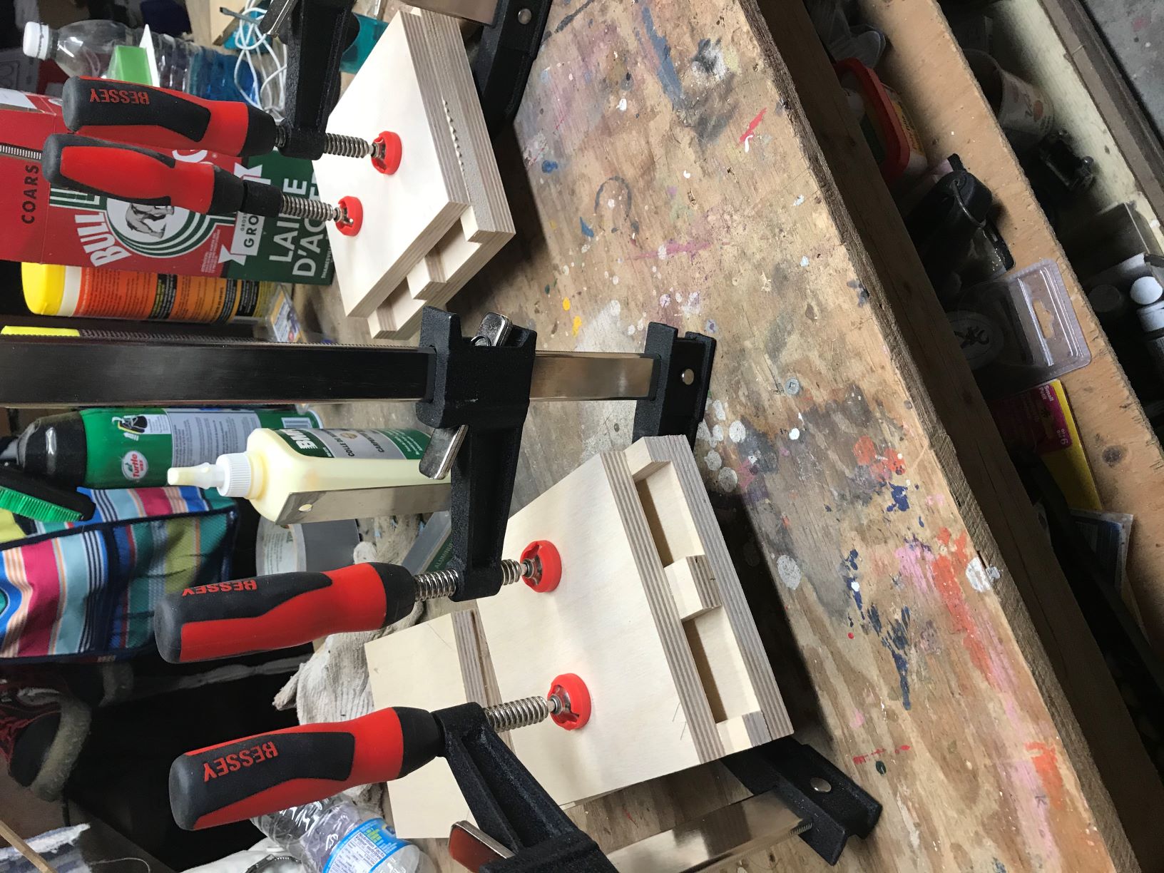

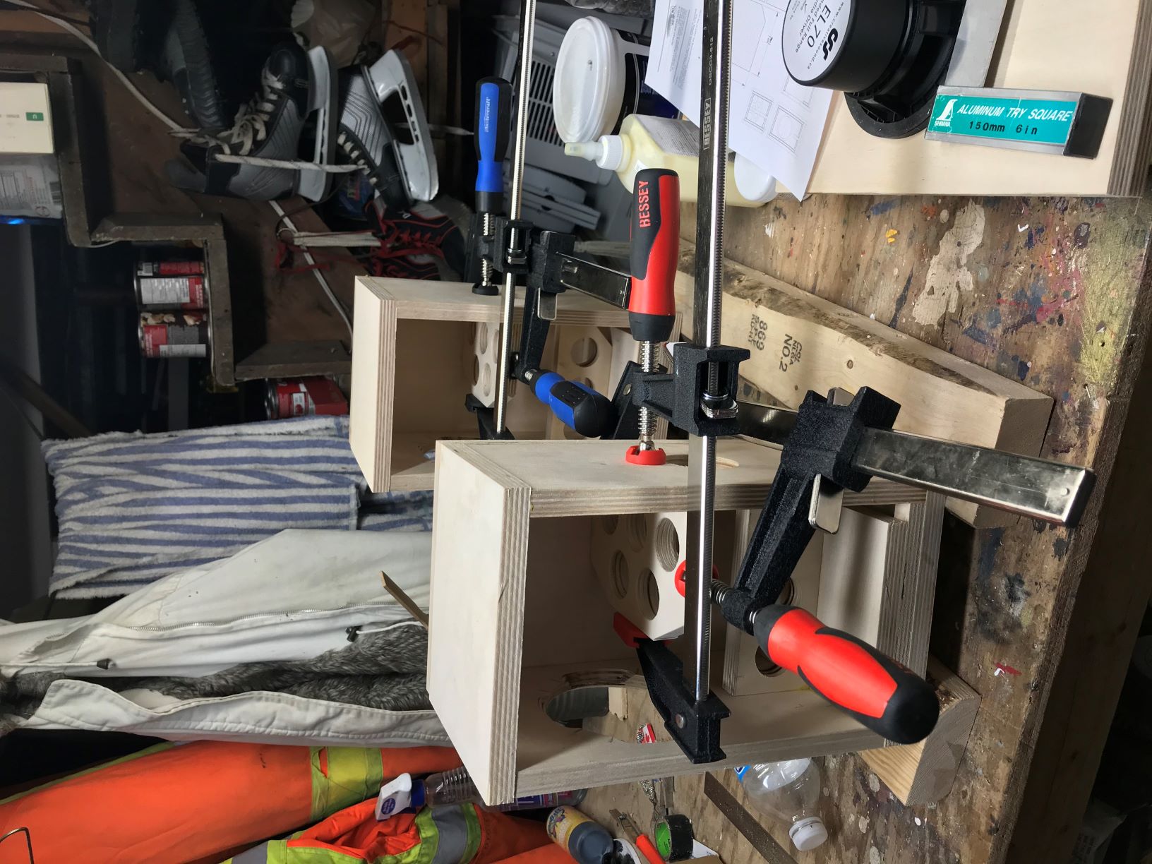

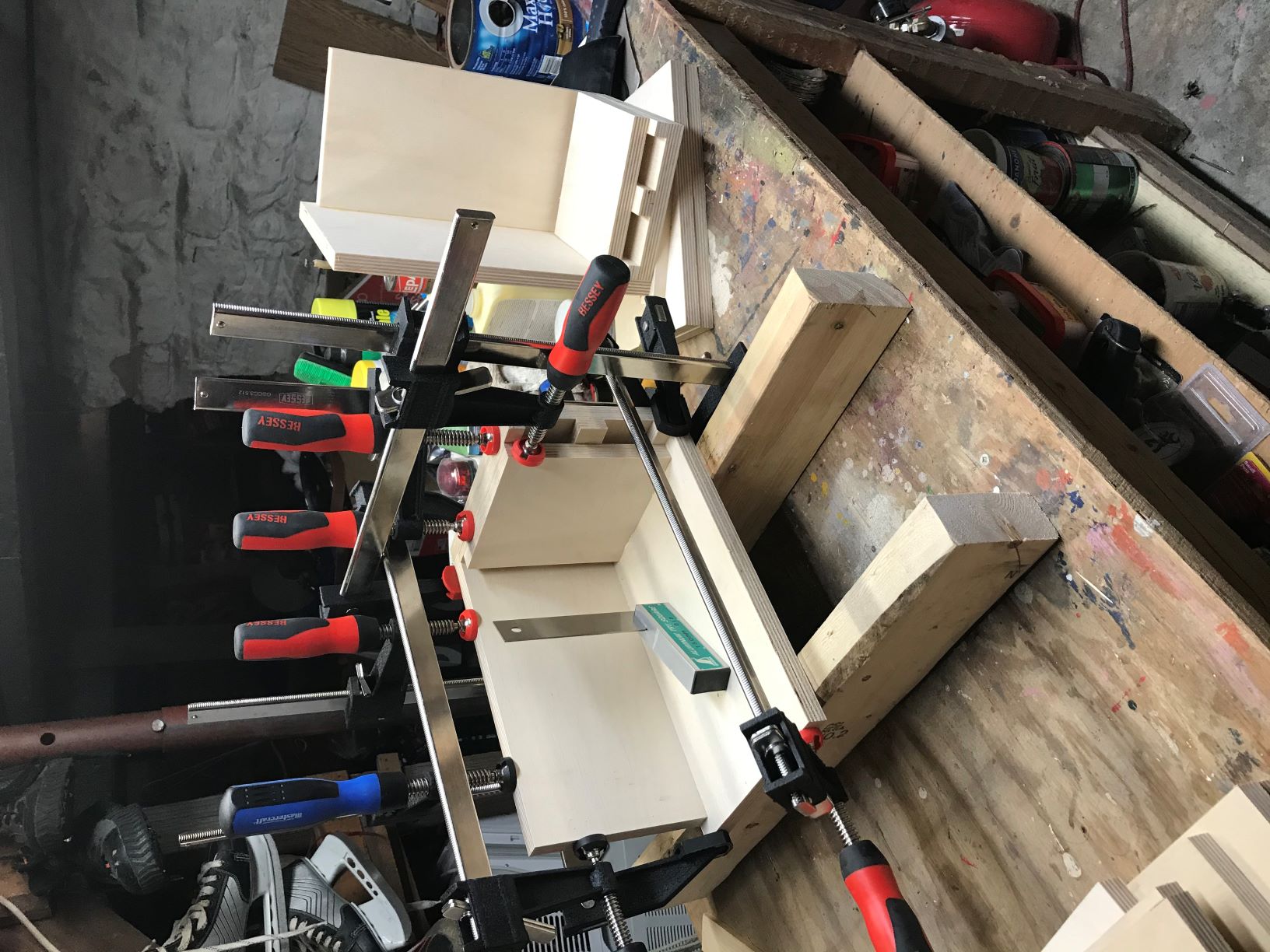

Originally bought the microtower kit from CSS about 10 years ago and did nothing with it. Family prevented the expansion of my full stereo system so here I am finally downsizing to computer based audio. Purchased the MaKel70 plans from Planet 10 (cause you never know....) and here is the build attempt....

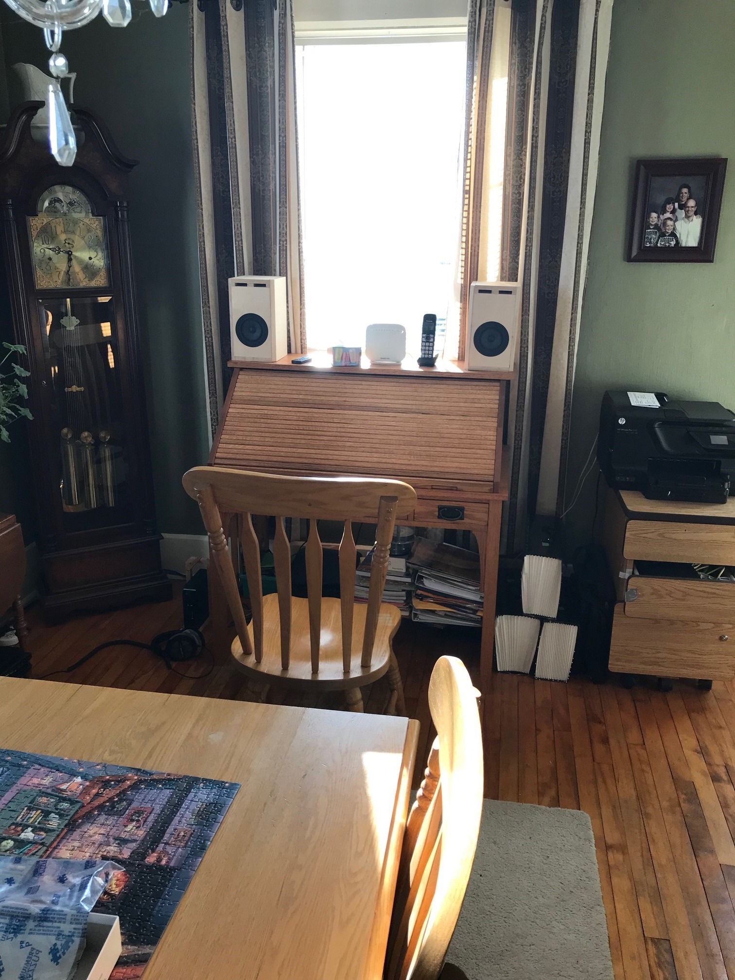

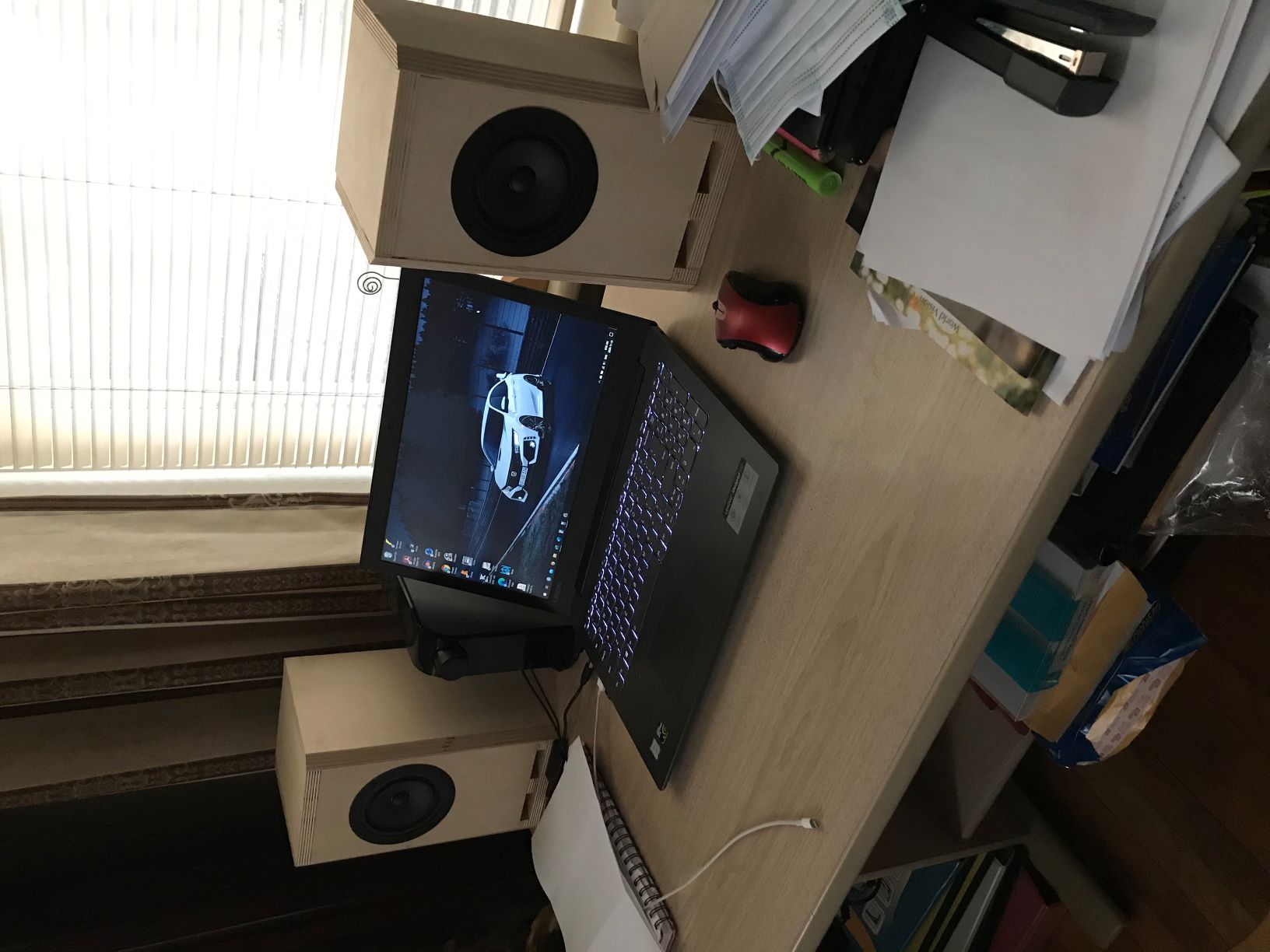

Buttoned up and breaking in. Ran the drivers for a few hours in their cardboard shipper prior to build. They are now singing beautifully on the desk. Solid 70hz using Audacity to test response. Some 60hz but definitely dropping off. Very pleased with them. Next step is to repurpose the Logitech subwoofer driver for the added bass support. Stay tuned......

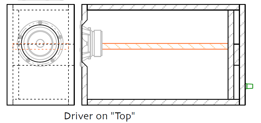

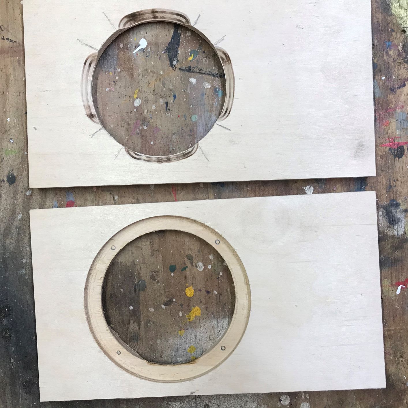

Enjoying these for a while now. However the woodwork is .... not the best. If I make new boxes, can the drivers be mounted on the end without upsetting the sound? They are near field on top of the desk so it would be nice if they were on their side (shorter).
As an aside they integrate with a subwoofer very well.

Not quite sure what you mean. They typically sit with the slot at the bottom, but you do have them high up.can the drivers be mounted on the end without upsetting the sound?
You can mount the driver anywhere it will fit, there will be small differences in the 2π to 4π transition.
dave
Sorry should have included this as an example. Classic GR Plu-Ken7 0v91. This box is too big so was thinking maybe the same idea with the mMar-Kel size...
