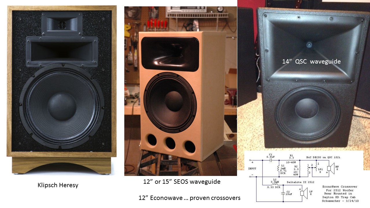

1) Spend a few weeks checking the newspapers and CraigsList for classic high efficiency speakers like the Klipsch Heresy.
2) Study how you can modify the old Cerwin Vega 12" speakers into a 12" EconoWave using proven designs and crossover. waveguides like SEOS12, SEOS15, QSC, B52
3) Visit the diysoundgroup website and look over their EconoWave style speakers. diysoundgroup sells CNC cut front baffles for their kits, and complete sets of CNC cut "flat pack" kits.
diysoundgroup.com
