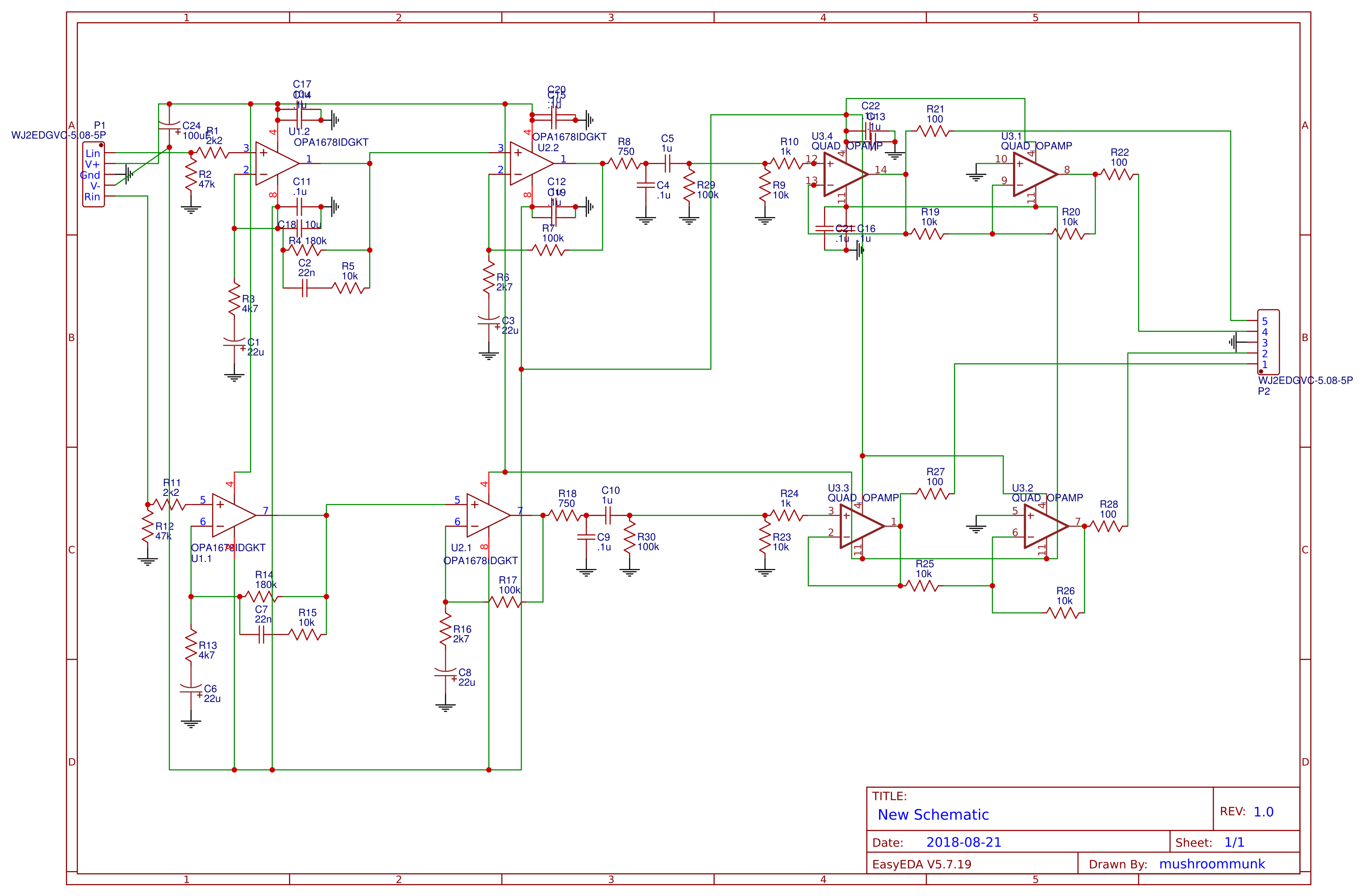

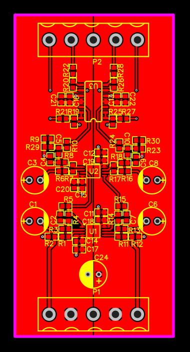

I've been hemming and hawing on posting this as there's hundreds of phono pres here, but, I decided I'd go for it anyways. I'm absolutely brand new to PCB layout so hoping for some critique here.
The goal is quite simple, my last relationship left me with 4,000 records, but no turntable or pre-amp. I wanted to build a stage for MM, and I decided I wanted as much SMD as possible for practice. So in order of priority I wanted:
1) Something that works
2) A proven design
3) Mostly SMD as I want the practice
4) Reasonable layout practices
For the design I ended up picking Project 06 by Rod Elliott, and just tacked Project 87B on the end, which is the balance line transmitter.
For layout, I knew nothing, I had to go from vaguely recalling an intro to circuits class in college to actually laying out this thing. Major learning experience as I'm a CS, I understand C++ (which sadly doesn't mean Capacitors plus plus). I spent a week reading everything I could get my hands on, from Analog Devices Decoupling Capacitor papers to TI high speed layout techniques, and beyond to trolling forums.
Three things stood out to me as important:
1) Control impedance
2) Control loops
3) Try to limit input noise

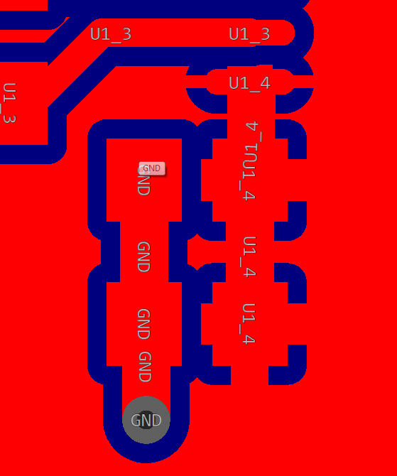

Nothing screams lower impedance to me than maximum width copper, so the top became V+ on left side and V- on right side. My understanding is with the bottom becoming GND that loops are minimal correct? To control noise I decoupled every power input with a .1uf and 10uf cap, with a 100uf power capacitor at the beginning to act as a reserve. Is this correct? Overkill? Not enough? From the 100uf power cap to the last IC is 1.5 inches, so under the 2 inches recommended by AD.
Finally, to control loops, I tried to not hop between layers with vias too much. Should I have put components on the bottom, or is keeping them all together and keeping a solid ground plane reasonable?
Overall how'd I do? Any major improvements or thoughts? I tried to take it logically, left input is on the left, right input is on the right, then carry it through, leaving room for power. Currently all parts are speced 0603 size, and the op amps I'm considering are opa1678/9. Not sure on power choice yet, still need to figure that out.

Looks pretty good, you should post the complete schematic for the pcb,
with the part numbers on it.
Oh right, I meant to do that. It's not laid out the cleanest as I was just copying.
The value of R9 is going to affect the T3 (R8*C4) value, because of no buffering.
Just use R29 alone, at least it causes <1% error. That will have better bass, too.
I was wondering about that. I inew they would be seen as in parallel, I just didn't know how it would affect things. If I just use R29, should I leave it as 100k?
The parallel value of R29 and R8 should be 750 so the T3 time constant is correct.
C4 * (R29//R8) = 75uS, and if C4 = 0.1uF, then R29//R8 = 750.

R1, R11, R8 and R13 are so high their thermal noise will dominate over the op-amp's noise.
Make sure to use good quality components: preferably thin-film resistors and definitely NO class 2 ceramics (X5R, X7R, Z5U, Y5V) as filtering capacitors, only class 1 (NP0, C0G) or film.

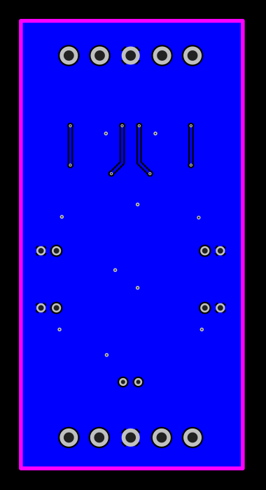

Why using ground planes for V+/V-?
I would prefer big copper plane to the decoupling caps before supply pins OPA?!

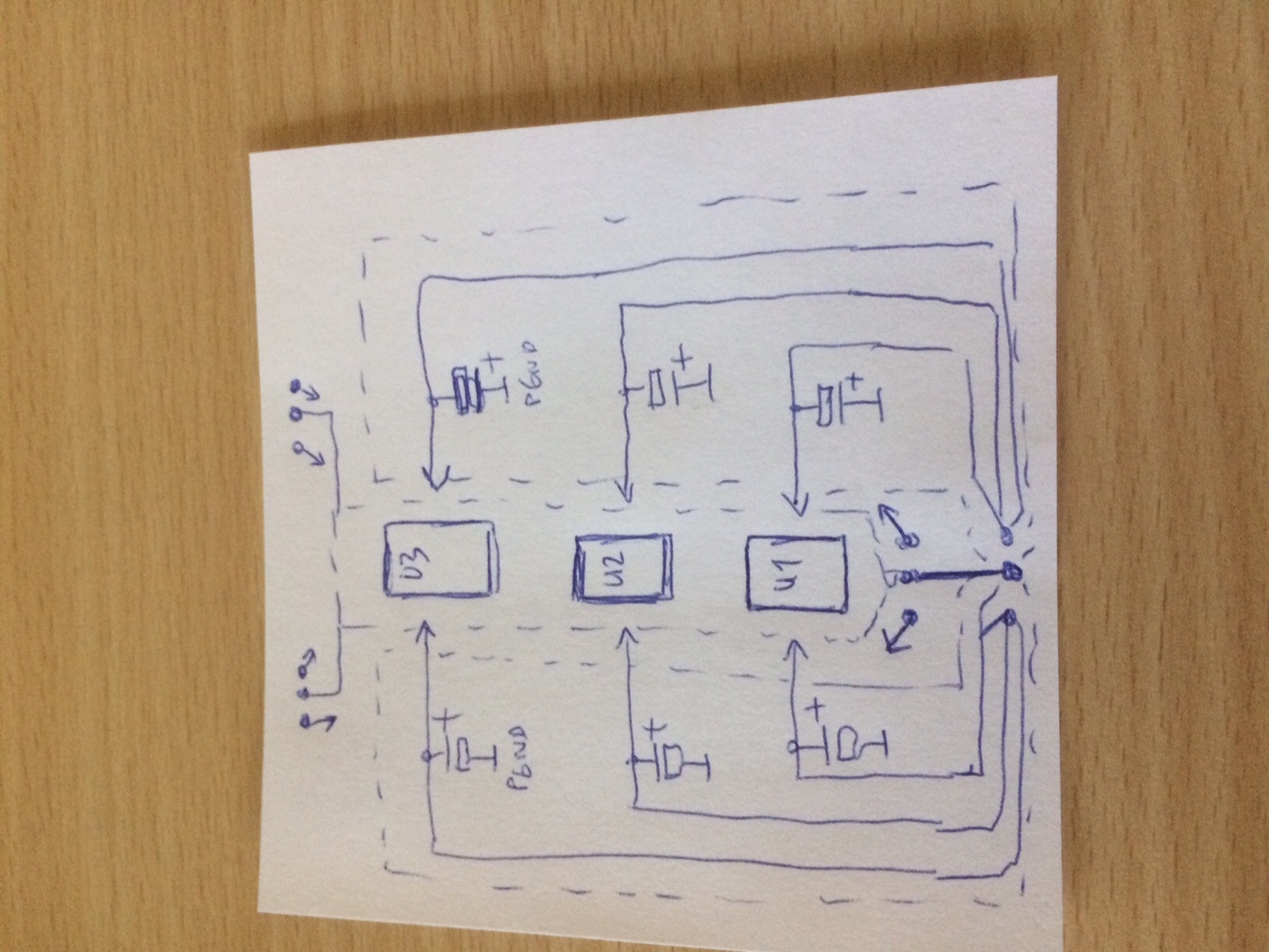

Dedicated connectors for signal and power.
Dedicated different ground planes for signal and power, following signals or power lines.
Star grounding?
My 2 + 2 cents,
JP

I was planning to get a Signstek M4070, DE-5000, or Global Specialties LCR-58 and try to match components between channels as much as possible. Seems like it should be easy enough to run the math and try to find an R29//R8 = 750 pair.

I was going off of this article which seemed to indicate that just connecting both pins to a power plane was better than explicitly routing power to caps then to IC. I've attached a closeup of one of the bypass cap layouts. My understanding is what I have is virtually identical to what's in the article. Any reason for doing it differently?
Edit to add: I'm using Easy Eda to create layout. I created a copper pour for V+/V-, it isn't part of the ground plane, unless I'm misunderstanding you.
Star grounding?
My 2 + 2 cents,
JP
I see what you're saying. I'm going to have to mull this over a bit more, I don't understand enough to see where/how much I'm compromising the system with my method vs yours.Something like this...
My 6 cents,
JP

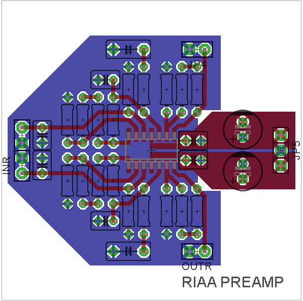

A few comments that should improve the loop area and a better layout of the GND.
At the input, connect input GND, R12, C6, C9 and R30 together with a single connection to the power GND. See my simple layout where a separate power ground is used.
At the output, parallel traces from (U3) pin 1+7 to (P2) 1+2.
(U3) pin 5+R23 connecting together then connecting to GND.
The main pcb layout problem I found was with a power supply on the same pcb.
Mixing the smoothing caps charging impulses in with the audio ground is a recipe for disaster. However your not doing that here so it shouldn't be too dificult. I designed a USB mixer with power supply on the same pcb and didn't bother much with pcb layout.
I got 1VRMS of hum on the output with the input shorted !!
I would keep the input tracks as short as possible to keep noise down.
A ground plane is a great idea.
