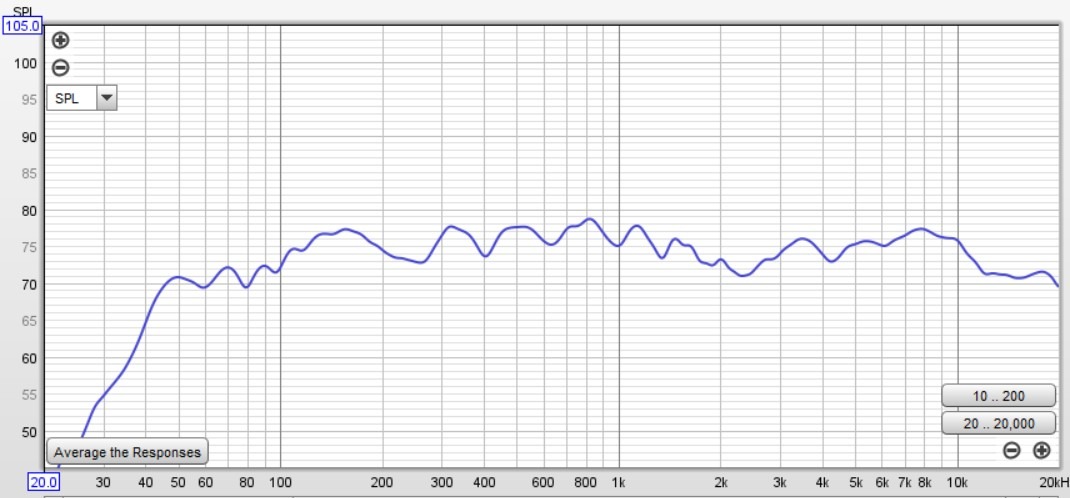

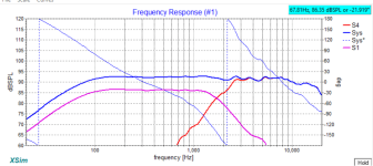

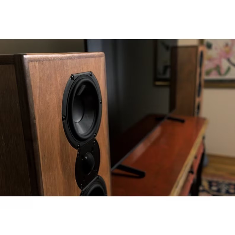

Here are some pictures, Xsim theoretical design pieces, and an outdoor measurement of the MTM pair I designed and built from scratch. Objectively there is room for improvement, but even so I think they sound great (because I made them? who knows ;P ). And I built more than one pair and tried to sell them (which is why I have this Etsy link... I'm not getting rid of them), and it is HARD to sell speakers you've made yourself. I should have known, but I had grand plans.... Ah, well.
Let me know what you think! I'm still learning and building (and have some ideas for the next projects....), and I want to take every lesson I can from this pair to improve the next 🙂

Nice finish. Decent frequency response to 100 hz. What is not to like?
In a world where sub-woofers are part of 90% of systems, this is a good start.
I like you did the work to install a passive crossover. You don't have to replace the dsp every time the software doesn't match the current phones. You only need 2 or 3 channels of amplifier to power up every hour of use.

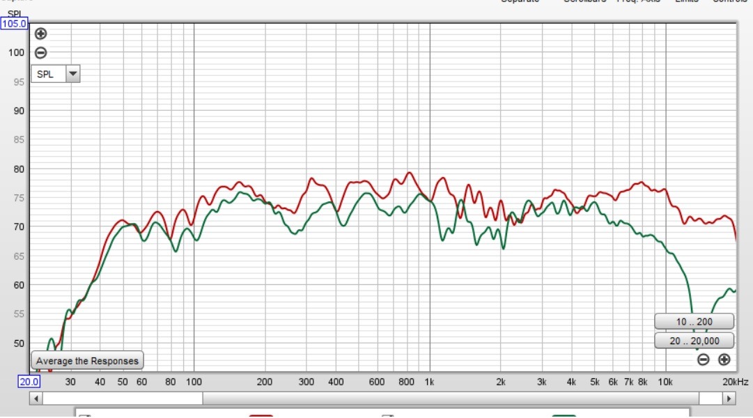

What can make your design more significant is doing off axis measurements. Also a harmonic distortion measurement would be informative. My (purchased) system has HD 2nd harmonic 20 db down from response from 60 hz to 12 khz. At 5 watts. That speaker has response 6 db down from on axis at 45 degrees off axis. All frequencies.

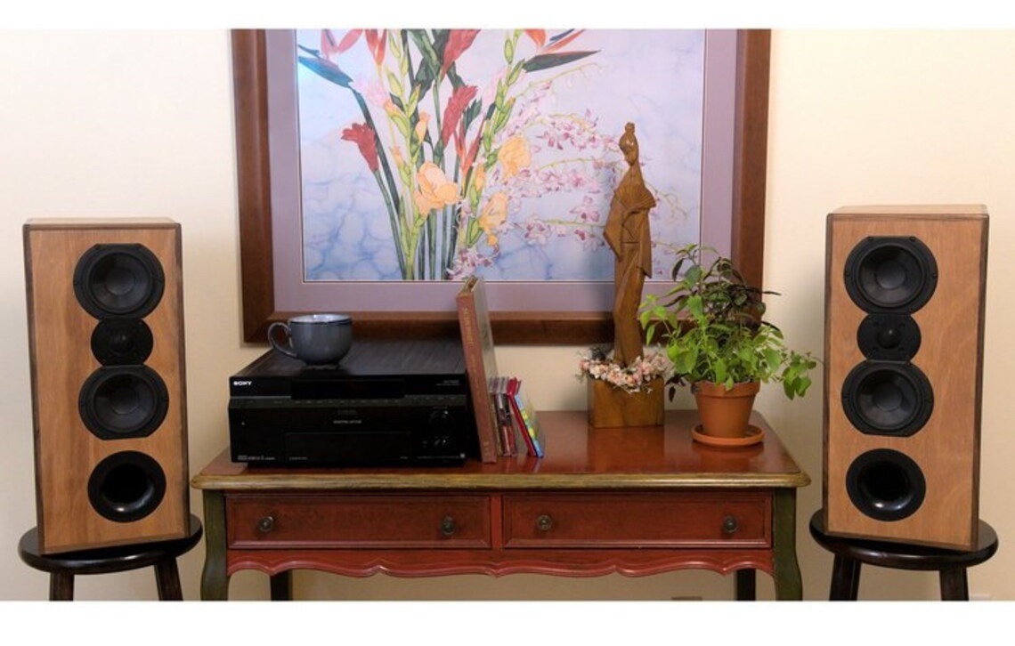

Cool project! For your first project, you have achieved great performance.

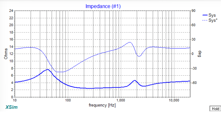

The minimum impedance looks like 2.5 Ohm at 300 Hz. Any problems driving them, such as the amp getting hot or tripping its protection circuit?

Nice speakers indeed. High WAF with those.
Curious: At what point did you decide to reverse the polarity on this 3rd order XO?
They look great but they look like they could have a lack of bafflestep compensation and the phase coherency through the cover frequency might be lacking.
Thank you Jo! I've attached a measurement comparing on-axis and 45 deg off axis. Huge dip right above 10k hz but I also don't normally listen from 45 deg off, I should have taken measurements from 15 and 30 deg as well but from what my ears tell me, it's more even than the 45 deg is. I'm not even sure how to do distortion measurement, I'll have to do more learning on that!Nice finish. Decent frequency response to 100 hz. What is not to like?

I have a 150 watt per channel Sony da7100es which isn't rated for 2 ohms but I haven't had (noticed....) any issues.

Thank you Cal! I'm pleased to say she likes how they look and sound 🙂Nice speakers indeed. High WAF with those.

I made the decision during the "theoretical" phase of crossover design (I made it in XSim, then adjusted it in real life with listening tests and then took a measurement and adjusted once more). In Ray Alden's Speaker Building 201, it shows that reversing the polarity of the tweeter in a dual 3rd-order crossover wouldn't change the phase (from my understanding of it, anyway), and it was much easier to get the FRD working with the crossover points that I wanted when it was reversed.

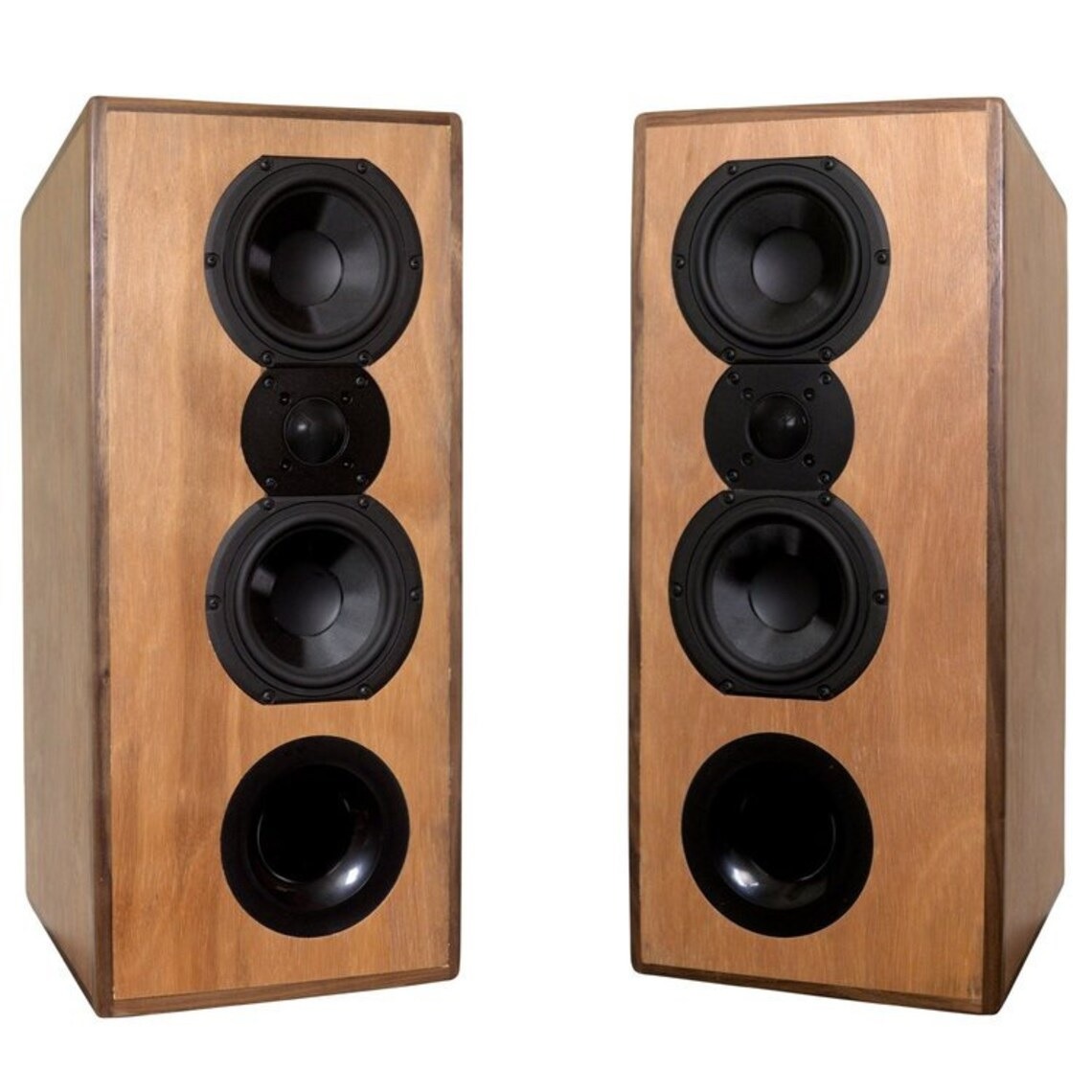

I placed the drivers with an irrational fractional ration from edge to edge in an attempt to help with the stacking of diffracted waves, but I definitely could have designed the xover to help with that, too.
The phase coherency... is again just beyond my knowledge, so you are most likely right! I'll look into that for the next set I build or improvements to this one 🙂
Nice to see an MTM where care was taken to get the driver centre-to-centre as small as possible.

Bafflestep compensation flattens response for speakers set at the front of an open stage, or in the middle of a room. Bass wraps around the back, no way to stop it. Bafflestep compensation boosts the bass. For speakers backed up to a hard reflective wall, it makes the bass too heavy. Speakers against a wall perform in a "half-space". Your picture clearly shows your speakers backed up to a wall.They look great but they look like they could have a lack of bafflestep compensation and

I doubt it. What is your XO? To acheive optimal spacing in an MTM the centre-to-centre of the 2 midbasses need to be within a quarter wavelength at the XO. Pretty much impossible to achieve with traditional tweeters. But certainly doable with a WAW.
I see other criteria mentioned but they are compromises.
dave
According to D'Appolito (in Ray Alden's Speaker Building 201), "in order for the 3/2 [MTM] geometry to work properly, the distance between the centers of the adjacent drivers should be kept close to one wavelength of the crossover's frequency."I doubt it. What is your XO? To acheive optimal spacing in an MTM the centre-to-centre of the 2 midbasses need to be within a quarter wavelength at the XO. Pretty much impossible to achieve with traditional tweeters. But certainly doable with a WAW.
dave
My crossover is just over 2,000 hz, and that means from center of woofer to center of tweeter, it should be about 6.75 inches.
So I'm pretty close to that -- but if there are other findings, I'd love to learn.

You placed the mid dip very well in the measured FR. That gives you a more natural off axis sound to the ear and allows you to adjust the sweet spot by toeing speakers in or out.
Old and out of date. And one of thoaw, e’ll compromise on this number.
Remeber, every loudspeaker is a set of compromises.
2,000 hz
For that frequency the ideal goal would be 1.7” centre-to-centre.
As i said, you will see other metrics used since this is not acheivable.

You can see the downward trend, between 100Hz and 800Hz, with the, in-room, measured response posted. This is the baffle step losses I'm talking about.Bafflestep compensation flattens response for speakers set at the front of an open stage, or in the middle of a room. Bass wraps around the back, no way to stop it. Bafflestep compensation boosts the bass. For speakers backed up to a hard reflective wall, it makes the bass too heavy. Speakers against a wall perform in a "half-space". Your picture clearly shows your speakers backed up to a wall.
Amazing how obsessed the senior members on here are that every design be suitable for performing on stage.
No one said the design was going to need 6dB worth of compensation but 2-3dB? Sure.
You still get some bafflestep losses with speakers even positioned like that. They need to be flush mounted into a wall, or in a corner, to get none.
