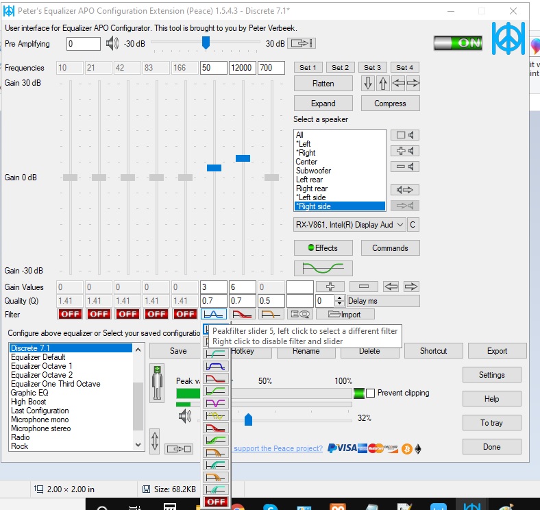

First order filter with Equalizer APO/Peace
How do I have a 1st order filter with Equalizer APO? In the list of filters there is no option for 1st order filter.
Also how do I add boost/gain to a single channel?
I am using Peace to configure EqualizerAPO
Thanks,
WA
Strangely, first order filters are missing in EqualizerAPO.
You can define one yourself with the free filter, but then you need to calculate the filter coefficients yourself.

1st order filtering goes as like Henrik wrote. An example:
