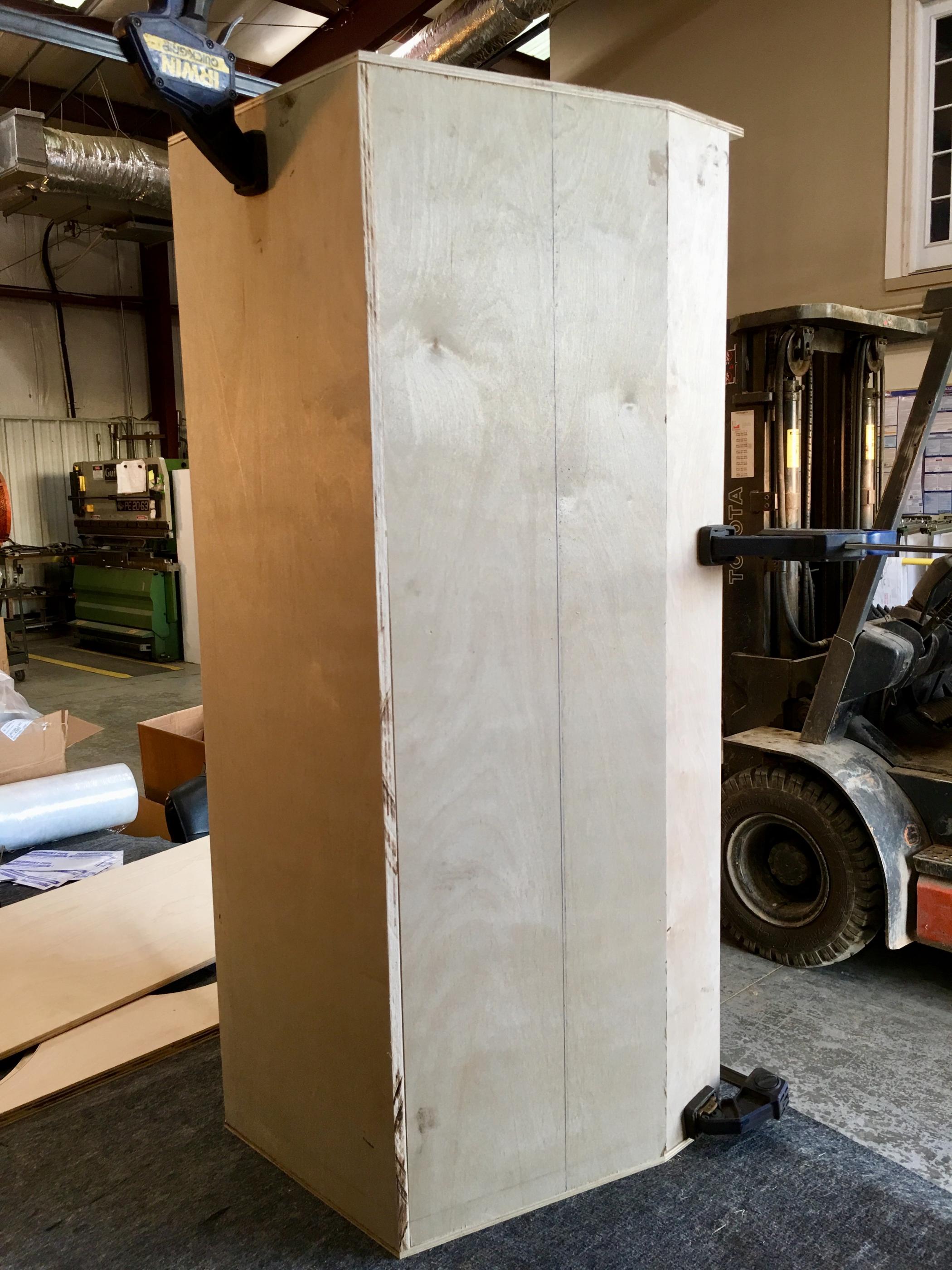

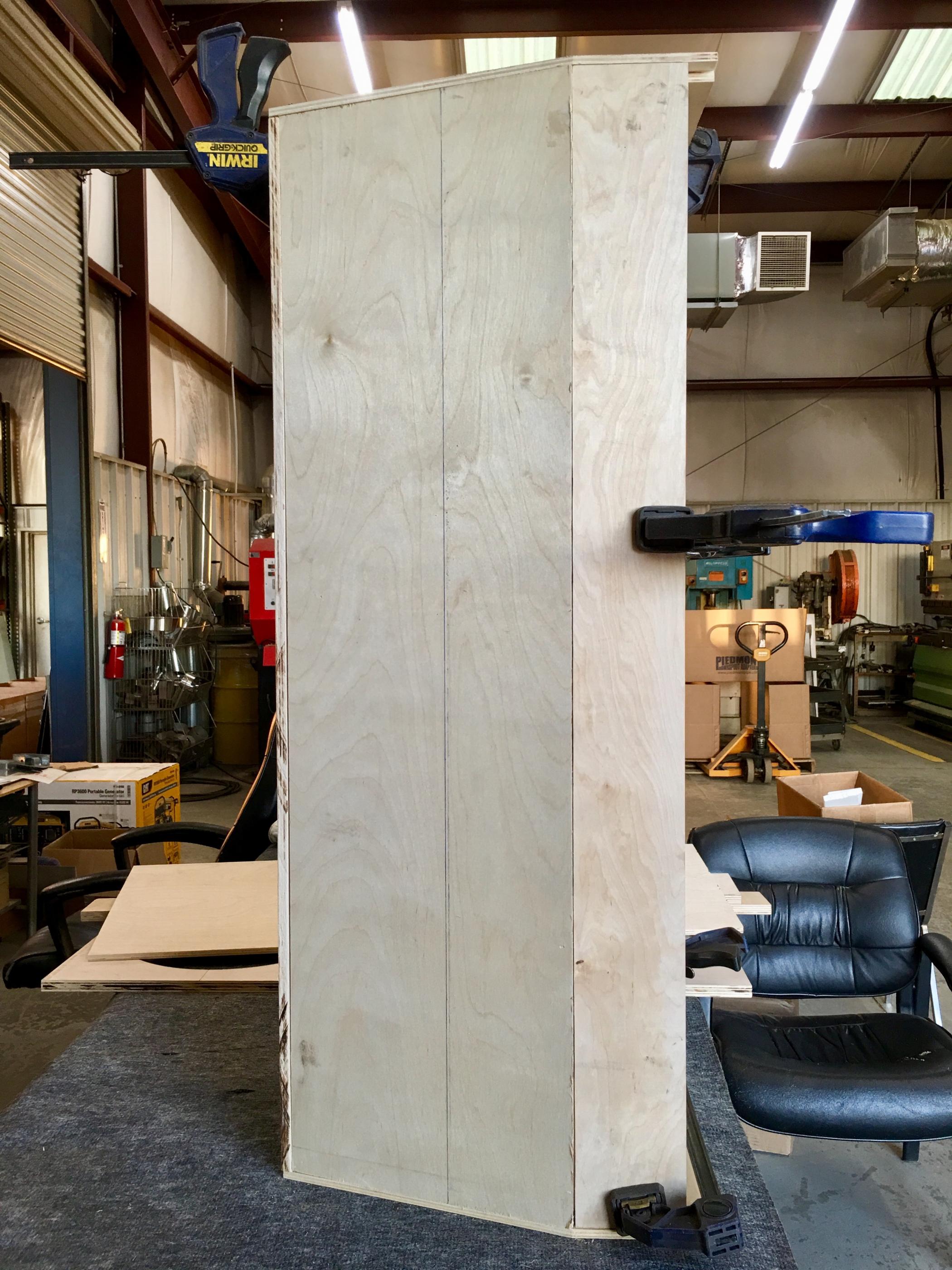

Cabinets are trapezoidal in design, with the 15" being baffled into its own chamber approx. 1.7 cu ft.(sealed) With the 10" and the compression driver sharing the same space. basic cabinet dimensions being 40.625H x 18W x 12D (basic internal dimensions). built from .75" plywood.
CL between 15" and 10" is approx. 16" and CL between n10" and CD is approx. 11.75". so my quandary is..... where did i mess up and whats likely to be my worst problem. (I'm just starting to learn about lobing and phase.) these are intended for medium to large bars and outdoors.
Well.. your first mistake was probably not asking for help before you made sawdust but maybe you only just found this website so I can't fault you on that too much.
The best way to go about building a speaker is to first define your goals. In your case we know it will be a band PA so what are your requirements and limitations there...
- How loud do you need it to be? How large a room or how many people.
- How much storage and transport space do you have?
- How heavy an object can you or you band members lift?
- How much money do you have to spend?
Ok now we can get into the basics of PA. The first thing you need to know is the best bass response is obtained with the low frequency speakers on the ground, but the best coverage position for mids and highs is overhead. As a result most PA systems are broken into 2 types of boxes.. relatively large subs that remain on the ground and smaller mid/hi boxes that are either stacked on the subs or flown or stand mounted overhead.
Now when you get into designing the speakers themselves there are software tools available that will take the performance specs(Theile small parameters) of a low frequency driver and define the size(volume) of enclosure needed to get optimum performance. Typically pro sound speakers are bass reflex loaded(ported) as this technique enhances bass output without costing additional amp power, sealed enclosures are reserved for mids or horn loaded designs.
So where does that leave you. Unfortunately the bass driver you picked is not at all suitable for a small sealed enclosure.. response falls off fast below about 80hz, and even if you removed the separation in your box which would be OK for the other drivers because they are sealed things would not improve much.
So given that what would you like to do next? I don't suggest trying to utilize this driver in a larger box because that box would be hugh(refridgerator sized), so to utilize the boxes you have you need different drivers. But if you aren't opposed to starting over from scratch then I'm sure you will get all kinds of suggestions on building something much better.

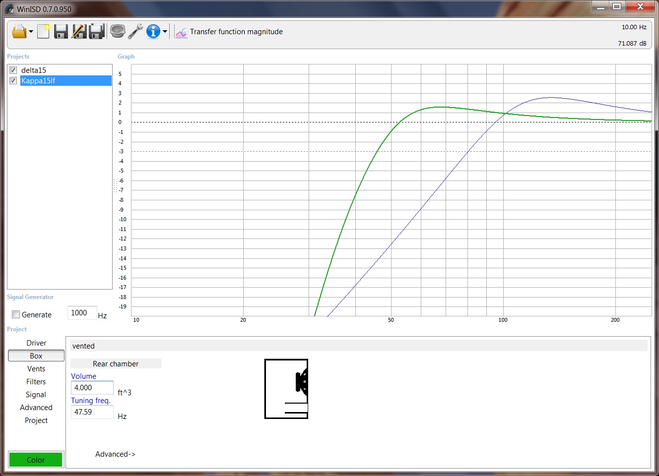

You could use WIN ISD WinISD - Linearteam to plug in the TS Parameters, as a bit of a guide. Not keen on you placing a second driver in the same cab, err, do the calcs first as suggested above. You could intro a second set of cabs for some solid 50 to 100Hz bass and fill the gap between your subs and existing project.
agree that your existing project won't be "bess endowed" with 80Hz sudden roll offand would require a re think/make. How does another set of bins sound ? probably reflex helmholtz resonator type, they would be approximately a bit over 1 third larger in internal volume or more.
Crossovers, go active if you are tri amping, fiddle with actual room response and EQ on set up per channel, makes thing a little more simple.

How much chamber size can you gain? If you get to about 4 cubic feet you could use the delta pro 15 for a full-range-ish cab. Sort of x-max limited but for full range music without too much bump it's ok (50 hz). And quite efficient - the real half space (not marketing) SPL comes in at 98db. For a more full range, use the kappa 15LF (steel frame version). That will get you maddeningly close to 40 hz in 4 cubes (will do it in 5). Costs 2db - it is really 96db/2.83v. Neither will do crazy high levels without subs, but use a sub and you can get full power handling. Or run subless up to about 400 watts.
Yes what would the total internal volume be with the divider removed. You wouldn't lose much volume with ports for a 40hz or even 50hz tuning.. something you could potentially add pretty easily with a slot port at the bottom.
P.S. After looking at your pics again you don't have room at the bottom for ports, but if you're open to mods then I'd suggest cutting a new baffle with driver spacing minimized and that should free up enough space for a slot port across the bottom or even a couple corner ports.
This is awesome guys!!! Ill have to run the numbers again, but i think it came in around 4.5-4.6 cubes, with the baffle removed. Also, i should be able to run approx. 2.5” corner vents without trouble. What about rear venting? The back is 13” corner to corner, so i could do about 11.5” wide slot vent??
If the vents don't end up needing to be too long you might get away with four spaced around that midrange.
At this point, I’m leaning towards the Kappa 15 Lf. At band practice tonight, I’ll do another calculation of the cabinet interior volume. If somebody could help me just figuring out what I need for Vents I would appreciate it. As of right now, I don’t have a Windows computer. So my limitations of software would be major hindrance on me figuring this out.

Ok, so a final calculation puts me at 4.2 cu. ft. Not subtracting for the drivers... i was hoping for a bit more. So say i do the kappa15lf with that volume, will this work?
Yes that will work fine, did you try to download WinISD? These Eminence drivers are all preloaded.
I have attached a screenshot of these drivers modeled with it bases on your box volumes and porting that I think is optimized for the Kappa15lf, the difference in low freq performance between these is not subtle.
No I haven’t downloaded that as of yet. I need to get a windows laptop for some of these applications. I’ve been running Mac for a couple of years. And yes, those curves aren’t even close!! What were the specs of the venting that these were modeled at?
It was two 4.5" round ports 6.1" deep, if you want to convert that to a slot port let me know how much room you have to work with. When using the boxes fullrange a high pass filter is recommended to protect the driver below tuning, use a BW24 at 38hz.
is there a way to calculate it as triangular vents? say, triangular vents in the front baffle around the Lf driver. I'm sure I could fit 3x3 triangular vents. or worst case, if its really needed, rip new front baffles. and ill make a note of the high pass.
Square ports would have to be 4" per side for the same tuning and port air velocity, cut those diagonally and you have triangles but now you need 4 ports.
