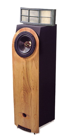

For a tweeter, I would definately go with high and small, something like 60cm x 5cm or so. It's a proven concept.
As an exemple Cadence Avita...
