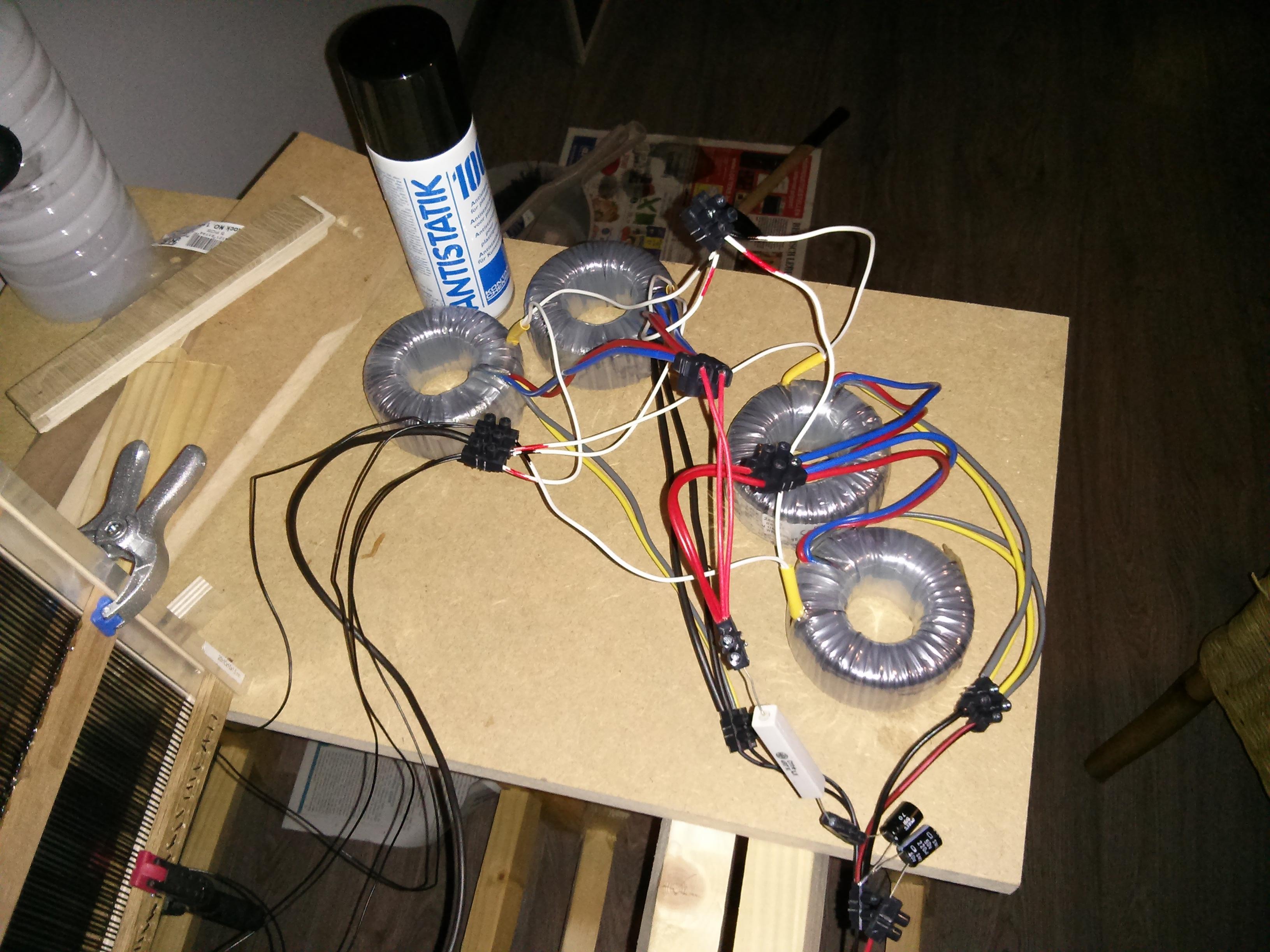

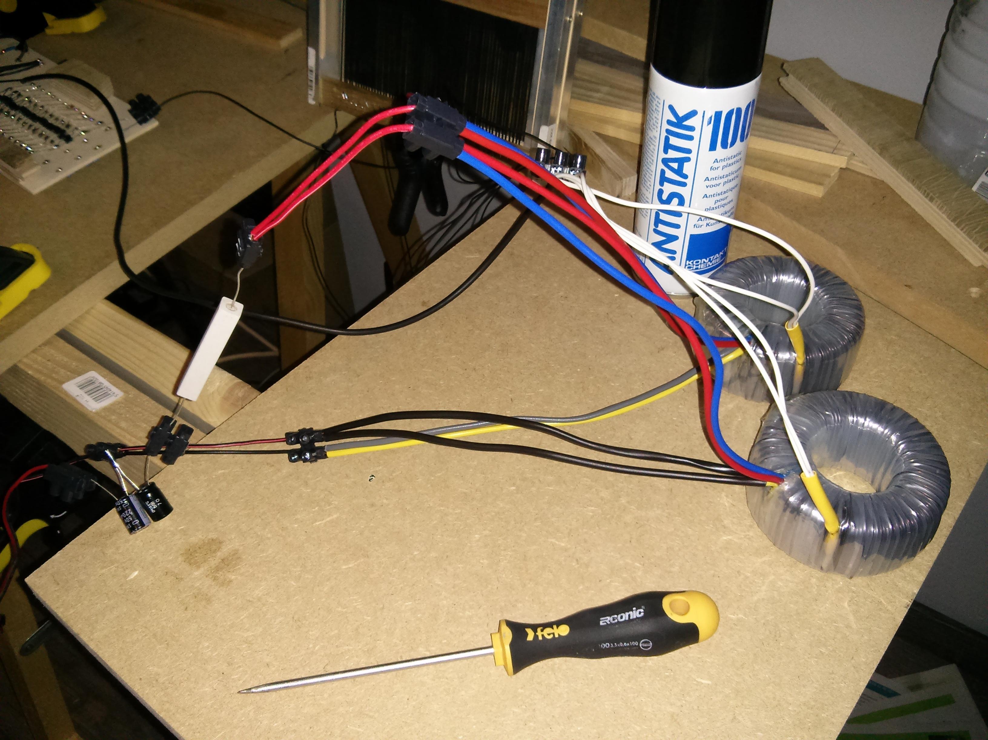

Now, about transformers and amplifiers.
Any of the transformers you have listed may work very well.
However this technique of using power transfomer's in reverse have one draw back, They do create a very low impedance on the low end of the frequency spectrum as well.
For a transformer of this type generally if you try to input a frequency much less than about 360Hz to 300Hz it creates a very low impedance to the amplifier and also the transformer starts to go into saturation of the core and this causes lots of audible distortions and havoc for the amplifier.
A properly designed transformer for an ESL won't have these type of characteristics, However they are very expensive to get right now.
Much more than what your Marantz may cost for a complete system.
Typically most (not all) A/V receiver's no mater how much they cost are loaded with chipamps and are not suited for use with speaker impedance's in the 1 to 2 ohm range that ESL's and the associated power transfomer's in reverse present.
Do not despair this does not mean that it won't work (as it will ), But you may not get the most ultimate performance out of it as to what they are capable of.
A dedicated High Power amp that can handle low ohm loads is a better way to go.
As is an active crossover too.
Electrically segmenting the panel helps with the load issue on the high end as well as it increases the horizontal dispersion.
In order to help with the low impedance factor of the transformer at the lowest frequency's is to carefully choose your crossover frequency while mating to your woofer system.

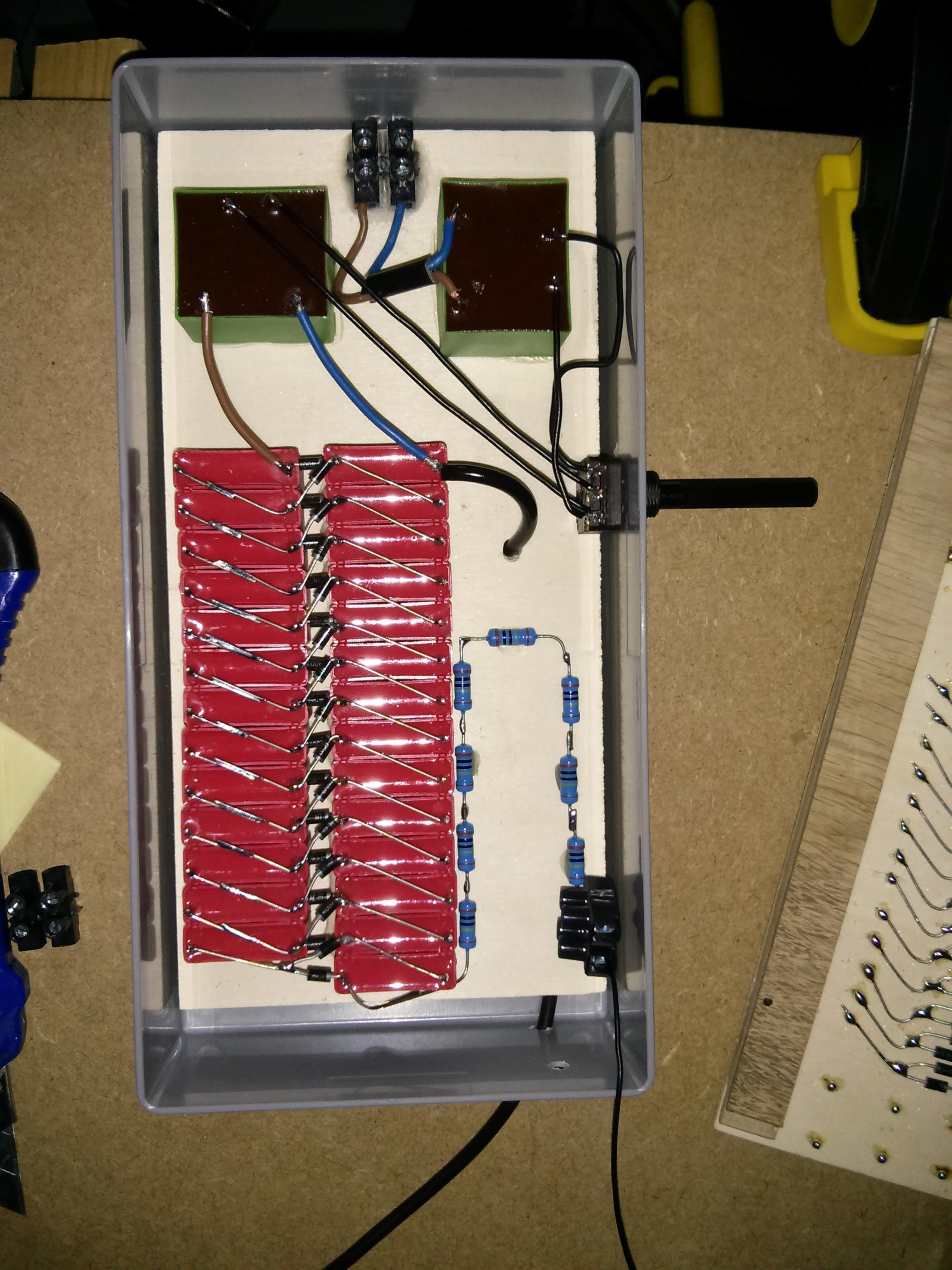

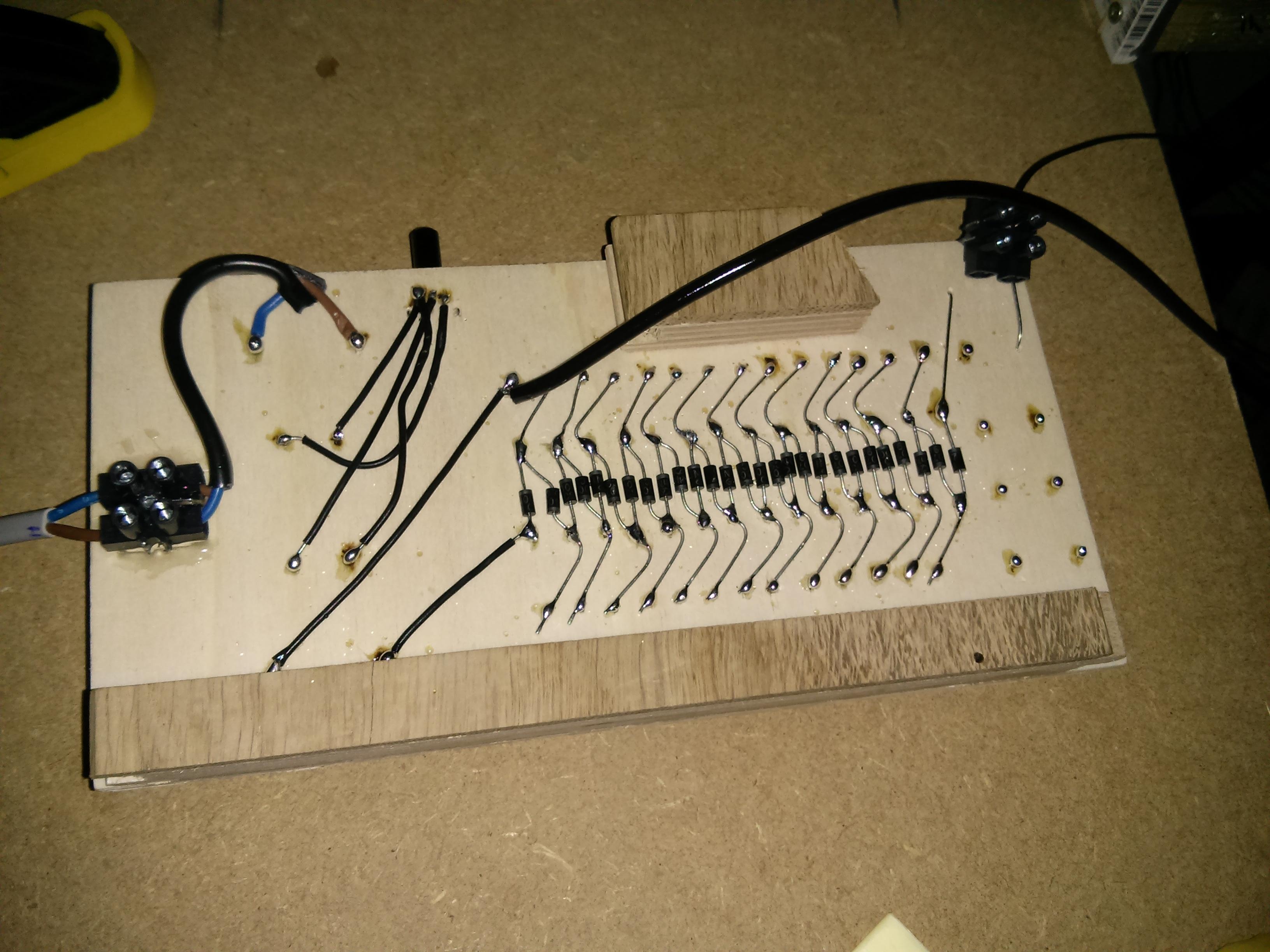

Hi Everybody,
Can't believe it's been 10 months since I've posted something here ... Anyway, I've decided that this isn't going to be the final build but rather test panels ...
I've build the panels and bias HV supply but I'm struggling a bit ... For the bias I've used a Cockcroft Walton cascade ... I used 27 MKP caps rated for 250V ac/400V DC 0,1uf and 27 1N4007 diodes. I've used 2 small PCB transformers 230V/6V with a 50kohm potentiometer between the secondaries as voltage divider and 8 Mohm resistors in series to limit the current. In theory I can get 6000V out of it but I don't think I'm getting that ... Already at the 4th stage I measured a serious voltage drop ... Which I don't get, I've tested all my diodes and caps and they're still working ...
Anyway I hooked the first panel up and ... It does work, there's sound coming out of it albeit not "that" loud, I have to crank up the volume quite a bit in order to play at a decent level...
Any thoughts on how I can let them play louder ? I've posted some pictures so you guys know how things are so far.
Greets, Kevin

- don't use wooden material as PCB under HV-conditions.
You may glue the caps -pins up- on a wooden plate with the wiring soldered free-air.
- Two 230/6V trafos won't give You 230V.
Due to the rather large losses of small trafos its probabely ony around 200V.
- I'd omit with the 50k Poti at all.
You need some current to drive the multiplier and Potis wiper don't take currents well.
Also, most Potis are not specced or intended for high voltages.
If You need less output voltage just use less stages of Your multiplier.
If You want to stay with the Poti idea rather use a discrete voltage divider and low ohmic resistors.
- 250/400V caps have insufficient voltage rating.
If they don't already hum like a bunch of bumble bees its probabely due to the high ohmic poti reducing the current.
- use a charge blinker as indicator for leakage in Your setup
jauu
Calvin

Very Cool!!!
The vocals through those things are incredible aren't they ?!!!!!!
jer 🙂
@ Jer,
Indeed vocals sound amazing ��
Greets, Kevin
Hi Calvin,
Thanks for your help, I have a few questions for you
Already many thanks for your help
Greets, Kevin
Is there a reason for this ? (I assume there is but I wouldn't know why)
This is true, I measured about 196V
The poti is in between the secondaries and aren't getting more voltage than that 6V, will dive deeper into your voltage divider suggestion this evening (and probably the next few days)
Which voltage rating do you suggest ? These caps aren't humming ... So far
jauu
Calvin
Greets, Kevin
- wood behaves dissipative. There´s always some humidity left and its hygroscopic. Methyl-Cellulose for example has been used as diaphragm coating.
- ~200V means +-280Vpeak-to-peak. The caps need to withstand twice the input voltage. So take 630V or 1000V types.
- the poti needs to pass some current. I´d rather use a voltage divider or - limiter on the 230V side of the second transformer, just ahead of the cascade
jauu
Calvin
jauu
Calvin
