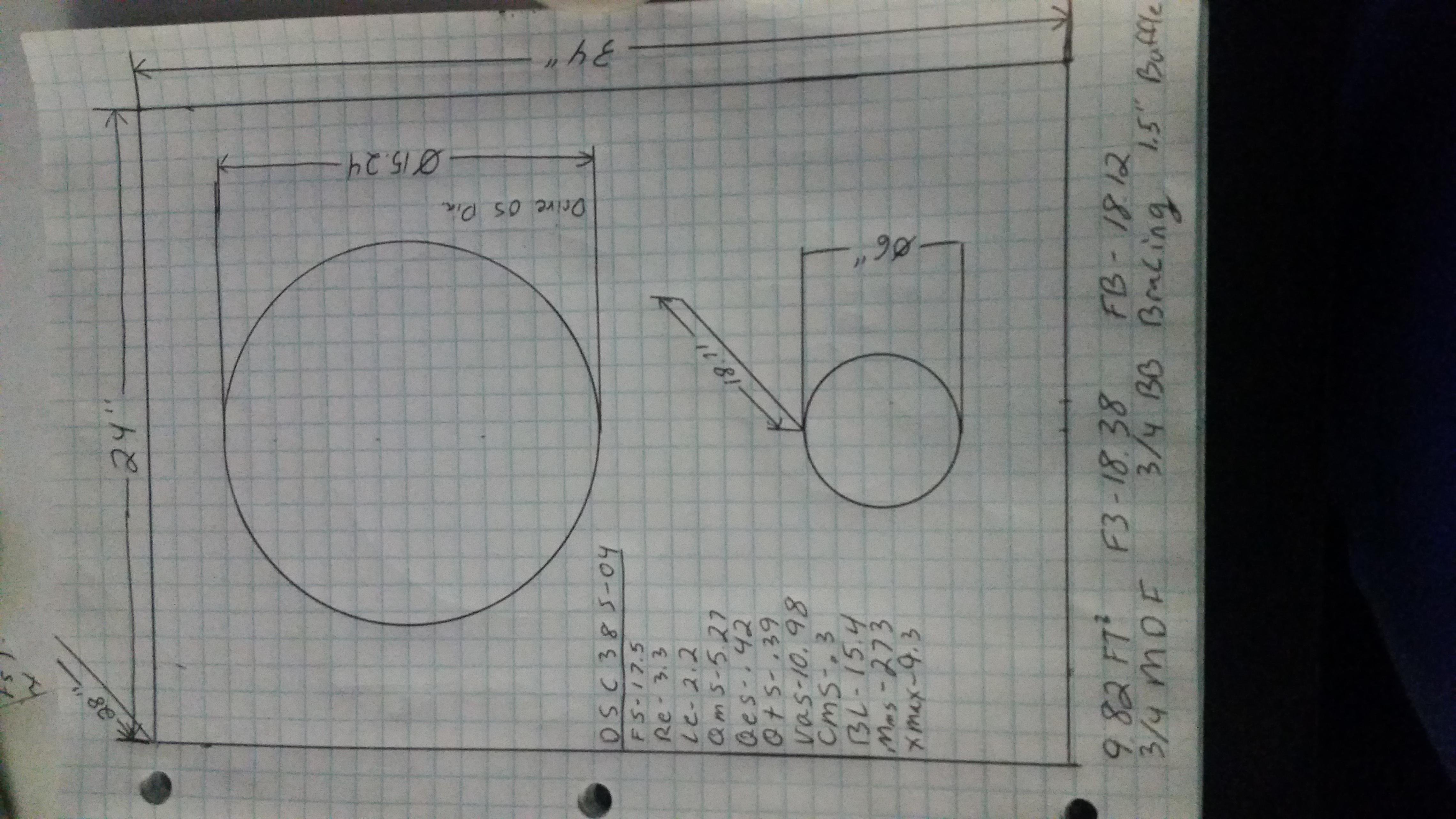

Please be gentle. After looking at what build data and what ever calculated data I can find. No PC so no real sims. This is what I can up with. Is port top or bottom better?
New drive from above dcs385-4. Also on drawing I labeled driver as dsc, dislexia kicking in.

The cabinet sure looks big enough, but I'm getting a crick in my neck trying to read the driver specifications!
EDIT: It's alright, I've looked them up on Parts Express! May get my David Weems book and calculator out!
Yea sorry about that. I tried loading the image several times in all differant orientations, always came out the same way in the preview. I'm not very Internet savvy! I can build or fix just about anything if I can touch it or draw it. This is the first forum I have ever posted in and I'm 50. Up until a couple years ago I was either at work or on the water.
Will make no difference, could even be situated on the back.

Hi, it looks like your well on your way.
One suggestion though...Baltic Birch is a way more suitable material for sub cab walls and bracing instead of 3/4" MDF.
Those dimensions & port look fine to me. I suggest you make it slightly oversize, to allow enough volume for some internal bracing - but don't sweat about getting it exact.
You can tweak the response after it is built by changing the port's length, and by trying the sub in different room positions. Room placement makes more difference than getting the box size 'perfect'.
People usually recommend ply because it is a lot stiffer than MDF (for the same weight). For a sub, a rigid box = good. Some people go to crazy extremes 🙂
Baltic Birch is the default 'good' ply, but if you can source an equivalent (e.g. if you can get marine ply at mate's rates), go for it. If weight doesn't matter, you can just use more (thicker) MDF, or whatever else is cheap & easy.
