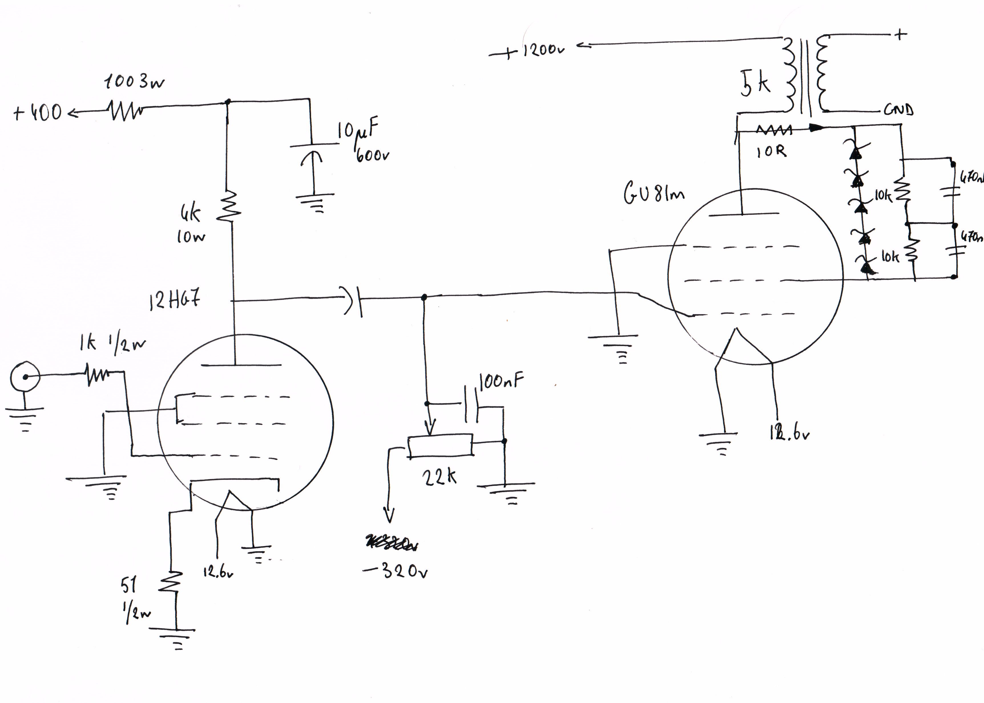

Dear All. I have tried my best and tried to come up with a way to use some GU81M I have seen lying around and *may* go and secure for future projects.
It is my very first attempt to create something. I have replicated the first stage from Pmillet's (813 SE triode amp) and tried to implement the alternative method of strapping a pentode into a triode (diodes and bypass caps on the right) but pmillet used a resistor in his design so I guess it is the correct approach (also with te B+ envolved I'd rather keep everything simple) 🙂
I tried to do my best. It is probably just full of mistakes and useless but if anyone wishes to suggest a complete design I'd be grateful!

1) Can you really ground the screen in the input tube? Will that work?
2) why not use a real triode as the input? Maybe you just happen to have this tube on hand? Triodes have lower noise.
3) Are you using an electrolytic cap as a coupling cap? That will not work. use a non-polarized type cap. Any film cap will do fine.
4) best to connect the wiper of the bias pot to one end. A common failure mode of pots is that the wiper goes open circuit. Then quickly after that the tube fails.
thanks ChrisA
1) NO. That was a stupid mistake. Obviously I need a source of +V and infact Pmillet's design has a +150v source and a 100ohm resistor in series.
2) Pmillet's original design had a 813 tube and required a suitable input tube to drive it. The characteristics I would be aiming for are: high gain, low impedance and (but can't tell by my own 🙂 low distortion). Pmillet himself found out that video tubes provide all these characteristics in a package. Better than triodes infact!
also...(and It helps these days) the 12HG7 is quite cheap!
3)The decoupling cap should be non polarized. Forgot to write it down.
4) Thanks! Will redesign that part for sure!

I just looked up the specs on a GU81M. This is NOT a project for a first time builder. Absolutely not. Once the B+ power gets over 1,000 volts you are in a different world. Kilovolt power supplies are like dealing with snakes, unpredictable and deadly and you don't get a second change after a mistake.
At first look i figured the gu81 was just a normal Russian beam tetrode like am EL34 or K66. But no, the thing is huge. Not at all the reasonable choice for a first time build.
One other problem. What is the input impedence of the power section? You have a 22K resister to ground on the grid. So the input is no higher than 22k. And what happens as you adjust the pot? At any setting other than full left it is less than 22k
Can your driver tube drive such a low impedance? I doubt it.
How will you build a power supply for this? What is the bias current in this tube. I'm guessing maybe 0.1 amp. There are no caps rated this high. You will need a huge series/parallel network and many equalization resisters.
Can you afford to have an output transformer designed and built. This will be in the "several hundred dollar" range and it will be truly huge in size and weight
I would not ground a filament. Best I think to elevate the entire heater loop. Make a virtual center tap and connect that to ground or to something above ground to elevate the loop.

To answer some of your questions to the best of my abilities:
1. To cover the B+ I will be probably go for several 4,700uf caps in series and resistors whith a secondary of 860v more or less. The remaining voltages will be derived from a common 380v secondary on the transformer. Filament voltage and relay control will be separate.
2. To answer some other points, a solution might be to insert an inline transformer (sorry if the term is not correct in english) between the driver section and the GU81M. A 1:2 or 1:3 transformer maybe?
This is just my first attempt at designing. If you were to design a schematic I would probably be able to build it.
Cost is a relative issue. I am willing to spend the necessary money. 100w - 150w is however my ultimate goal.

I'm wondering about the output transformer. It is going to be huge. can such a large transformer still sound good on the high end? From my reading this depends mostly on the interleave plan and other details of the physical construction. Can anyone get this right on the first try? I don't know but I'd plan on a prototype or two.

Given adequate isolation and build characteristics, P-P transformers would be a better choice. It is not an impossible mission to find a 100w range P-P 5k transformer at a reasonable price. To find one with adequate isolation is another matter.
I have no theroetical basis to design an amp. I am just trying my best to learn so if some kind sould were to propose a P-P design based on the GU81M I would be grateful.

I once thought to build with this tube...even got the tubes and sockets. What looked best before I came to my senses was a Class A PP design. U-L rigged; 20% tap location on. 800V supply, 400 mA idle per tube and a 3500 Ohm a-a output trans( to be capable of 200W full bandwidth ). OPT needed to be huge even then...I have since been playing with much smaller designs...🙂

I saw the Hammond 1650 series with OPT up to 280W RMS (12kg!!). Looking for something smaller one could opt for the 100w 5K PP OPT.
Or
Have them done (minimum 500$ expense) but may be worth it. I guess one could reasonably look for a 5K - 3.5K OPT rated at 200W RMS Big, sure, but mechanically doable.
I am really looking for info on a feasable design. Would a single driver stage work? is an interstage trafo absolutely necessary to couple the driver to the output section?

There is nothing much safer about an EL84 amp v. one to be built around a GU81m. it is a matter of scale, and shade...
The 1650R would make a fine starting point. Work out the rest within that OPT's limits. You should be able to run 650V of B+ at what ever current level the OPT is rated for...and within reason probably 10% more.
Try EL84 as LTP for the input stage. Send me your email and I'll send you a scan of schematic.
