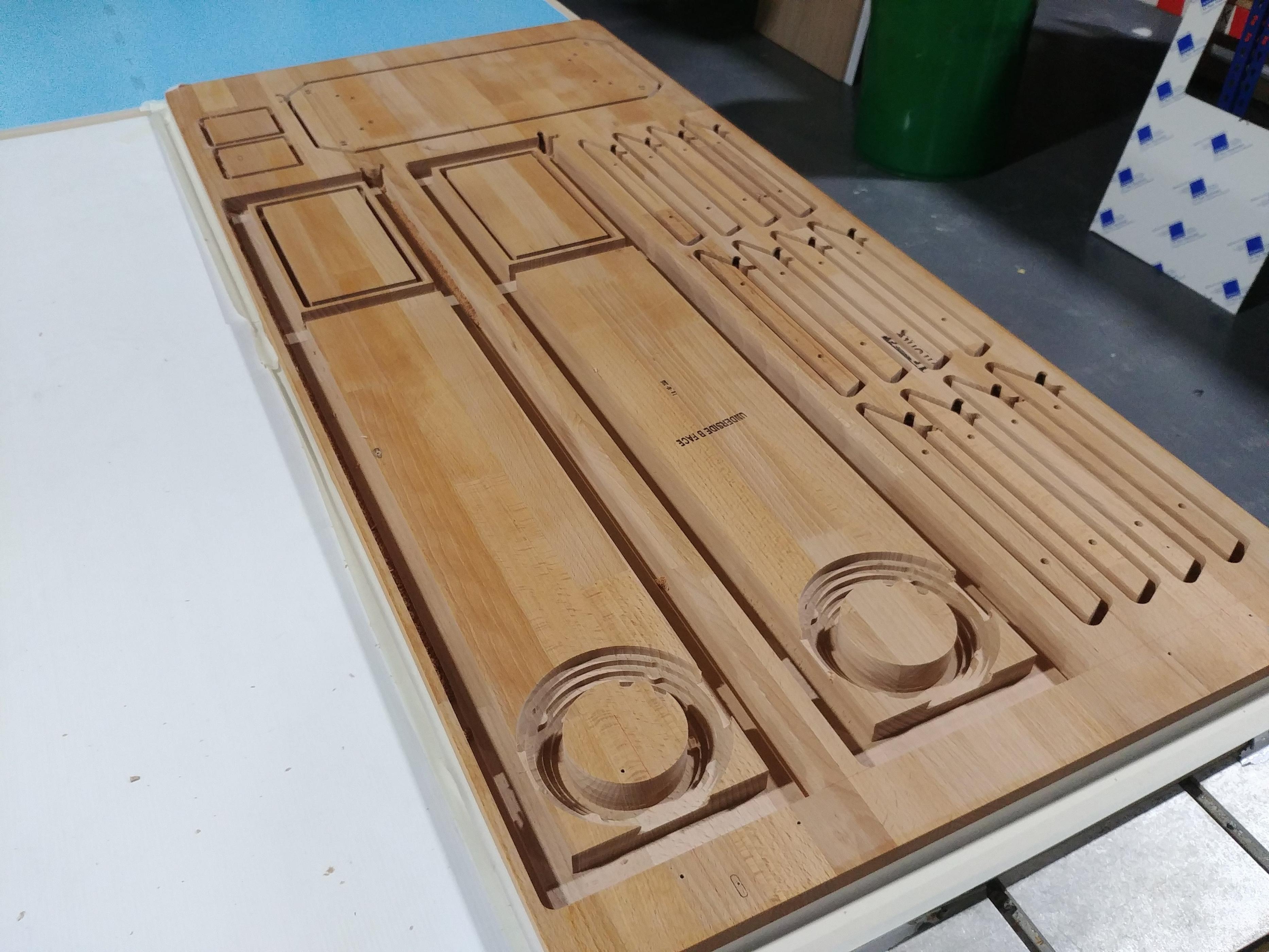

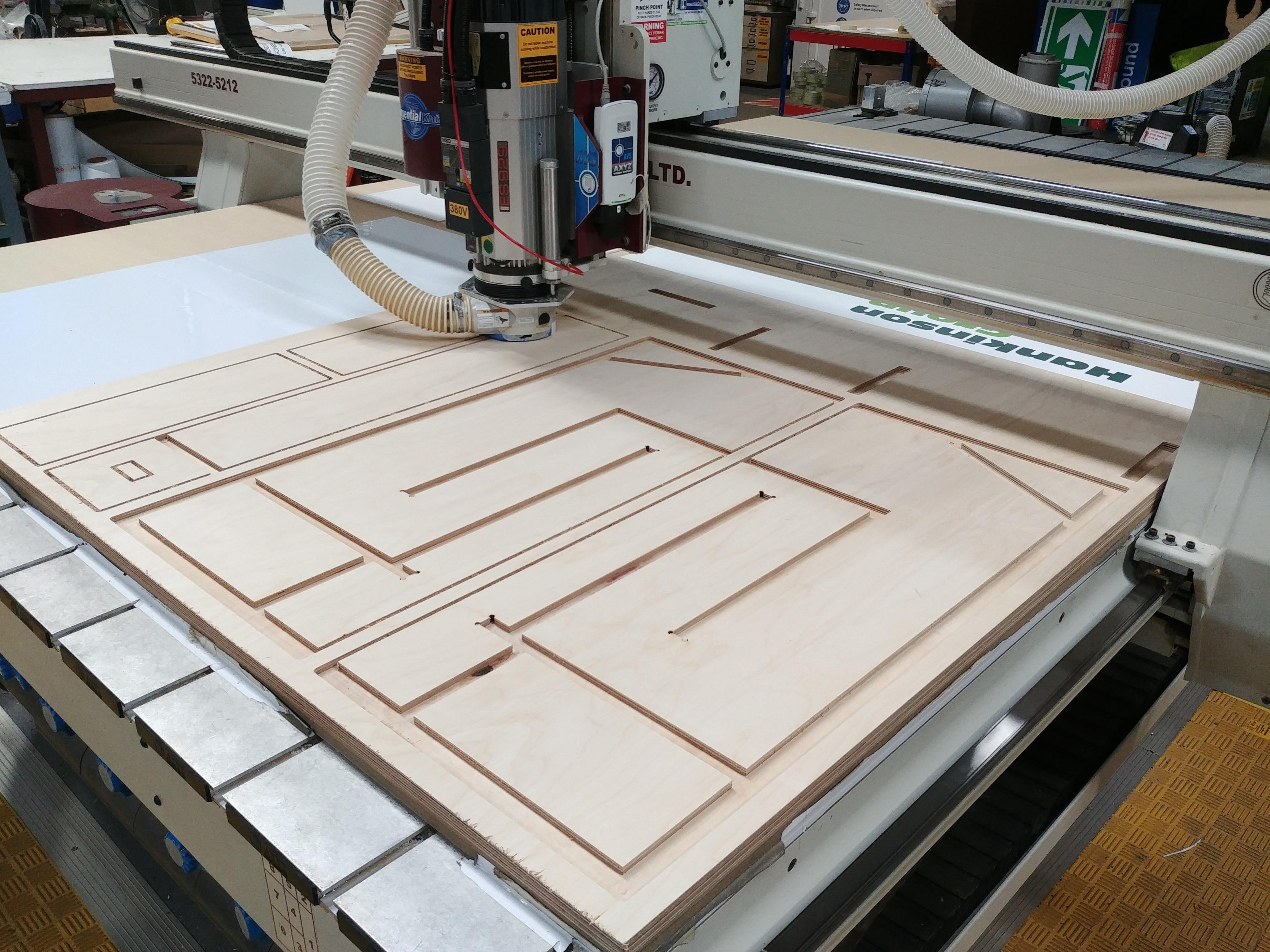

I work as a sign maker so I'm fairly handy with building stuff, but have only really dabbled with basic woodwork almost always in MDF for a famous coffee shop chain. Crucially though, we have a 2m x 3m CNC router which definitely gave me a head start over most first time builders!

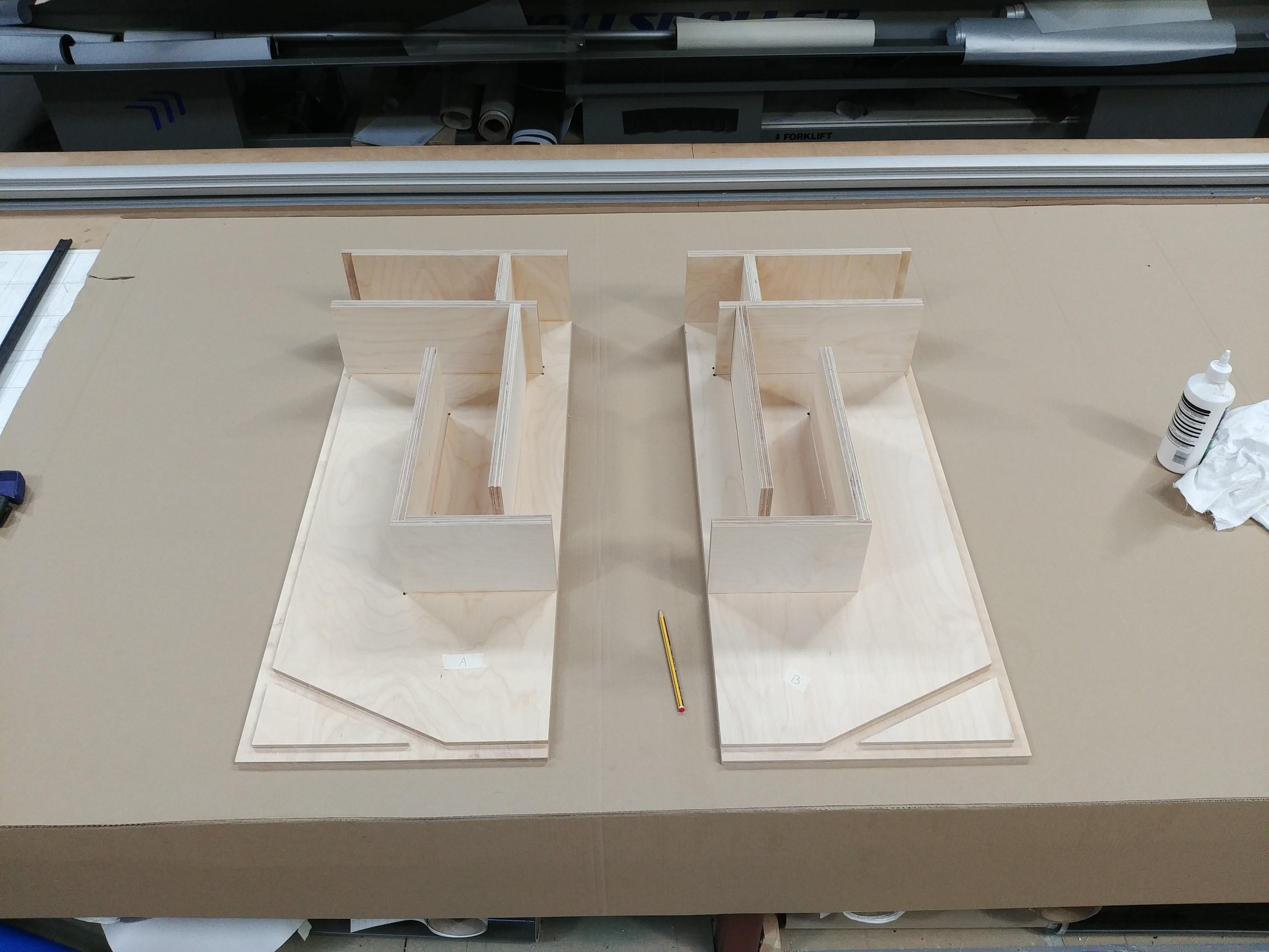

I wanted to start with something fairly simple, but a bit more exciting than a basic bass reflex which pointed towards the frugel horn or BK-12. A major consideration though was minimising angled cuts as I have no (easy) way of doing them with my equipment. This led me to Woden Design and their smallest Fostex design, the Sperrin for FE103EN, which can be made entirely with right angled cuts.
A few emails to Scott later and I had the nicely detailed PDF plans, which I drew up in ArtCAM ready to feed to the router.

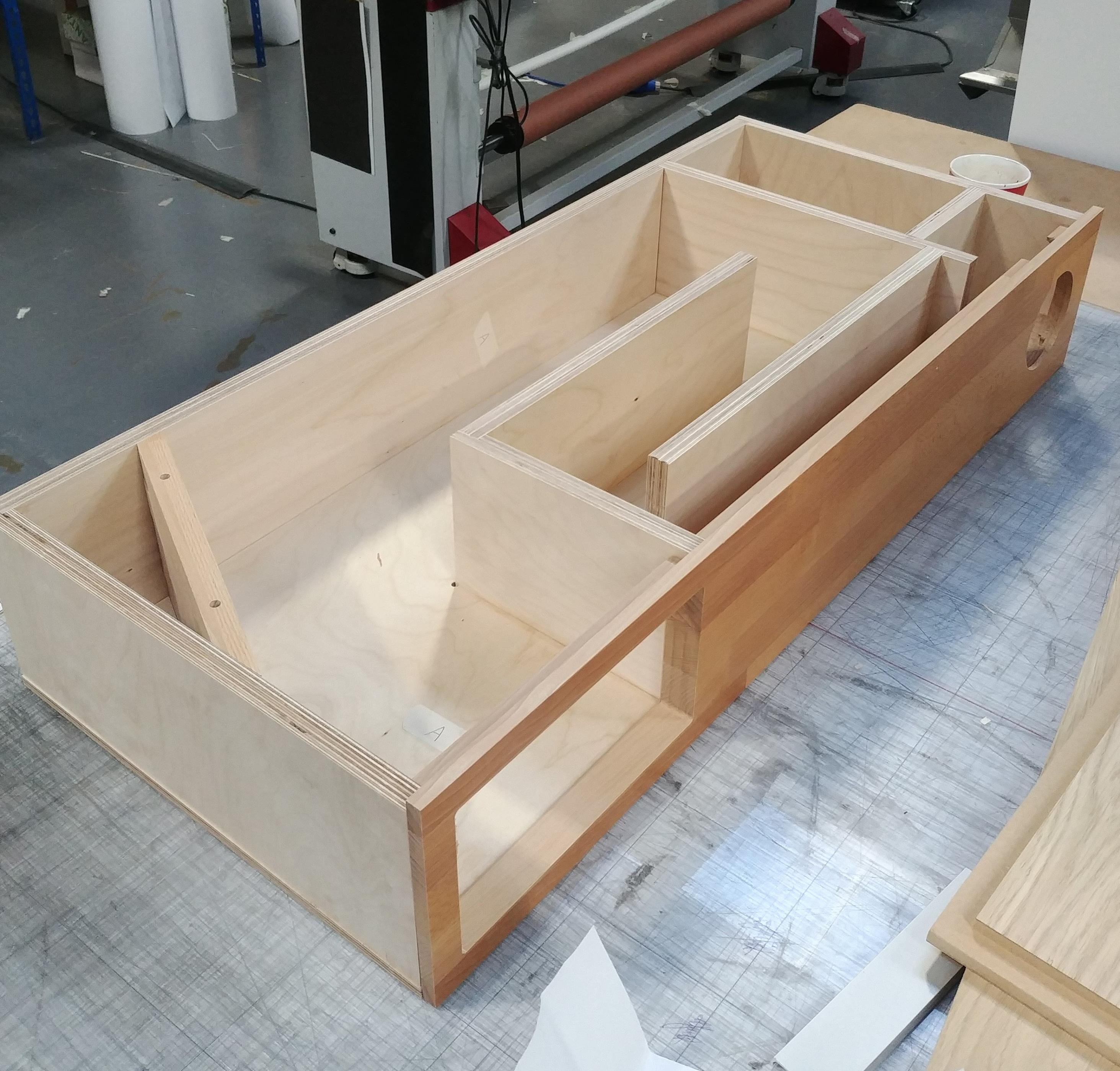

As advised I used 18mm birch ply for most of the panels, but for the front and feet I used a piece of blocked beech worktop which and been sat in my garage for months (purely for aesthetics).

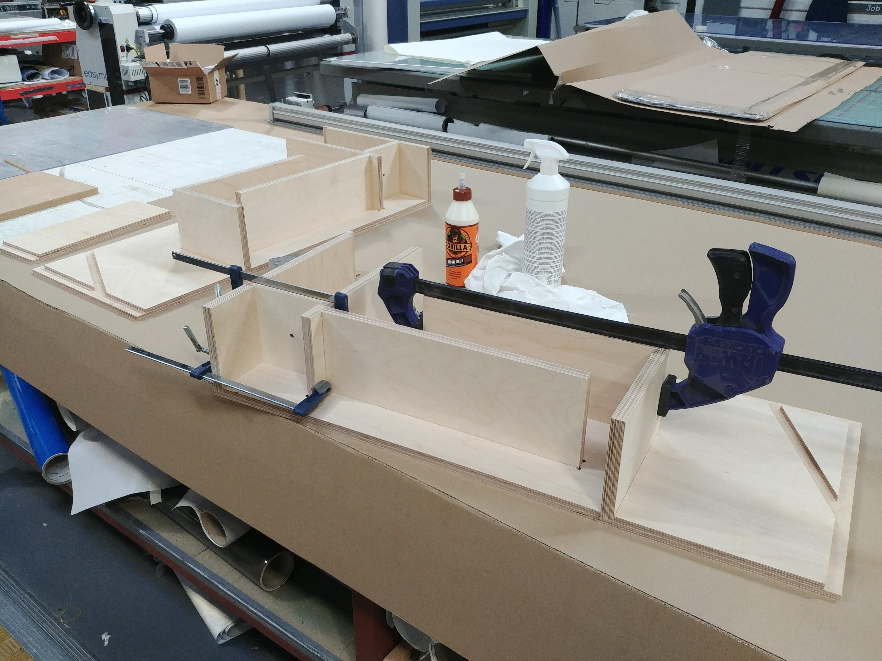

Since I had the router I decided to cut slots and rebates into the side panels to keep everything alighned and as square as possible, but not having many clamps had to glue only a few pieces at a time. More to follow, trying to keep post size sensible!

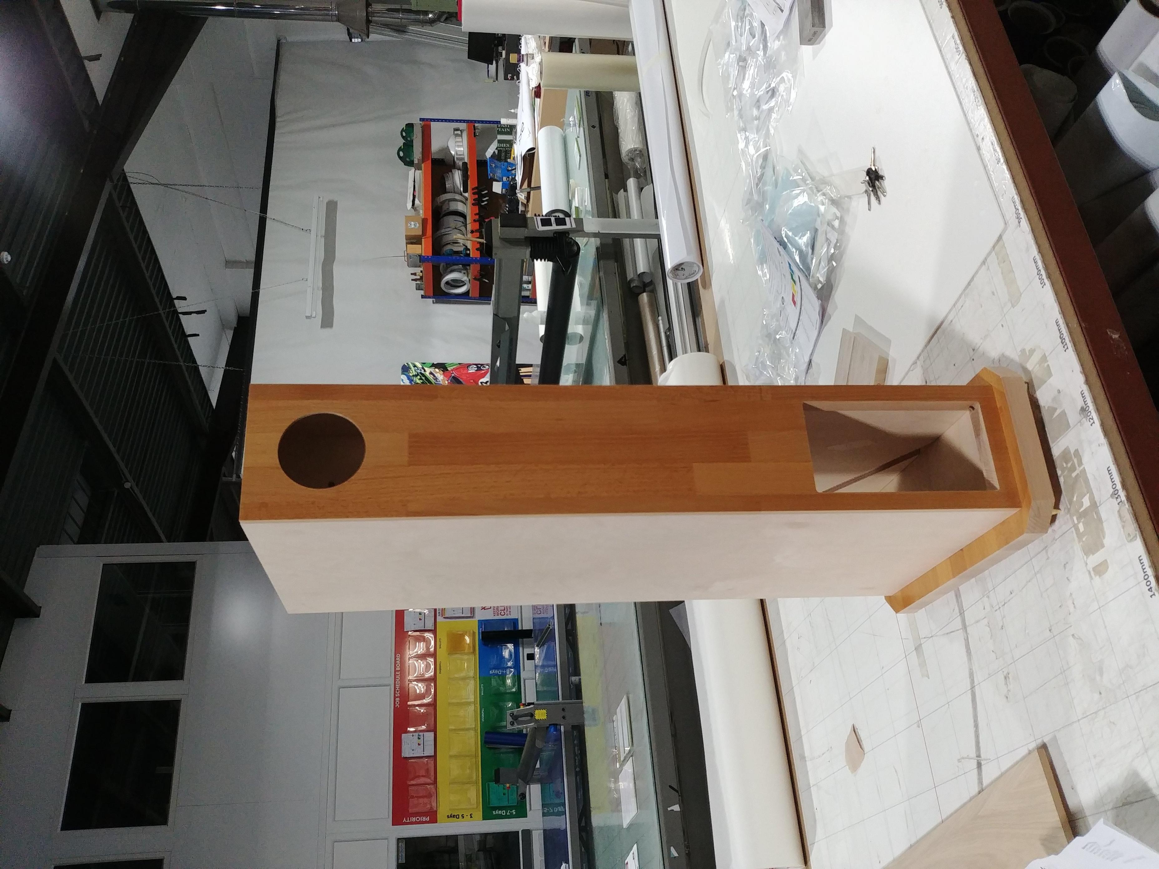

Despite chosing this design for the lack of angles, I much preferred the look of a single angled deflector over the stepped version so I gave my few offcuts to a friend of a friend who had some woodwork experience to try and cut them. Unfortunately this didn't work out, and with no ply left I had to use the beech worktop by layering pieces toether with dowels to keep it aligned. purely by chance the layers added up to almost exacty the required depth and only needed a bit of sanding to match the rest, with the added bonus of looking pretty cool.
With all the parts now cut it was time to glue the other side panel on, this was the only tricky part of the build as there are many parts to get aligned with not a lot of time to work as the glue dried quickly. I will also be using a lot less glue on any future builds, once the clamps were applied there was some major ooze going on, and some frantic scraping trying to clean it up before the glue dried.
The front panel (baffle?) was last to be installed so the wire and felt damping material could be glued in place. This was nerve wracking as well as they were a very tight fit, and needed a fair bit of 'persuasion' to close up all the gaps. I also made some new smaller feet with my last piece of material as the single block didnt look great.
Assembly now complete it was time to take them home for testing 😀

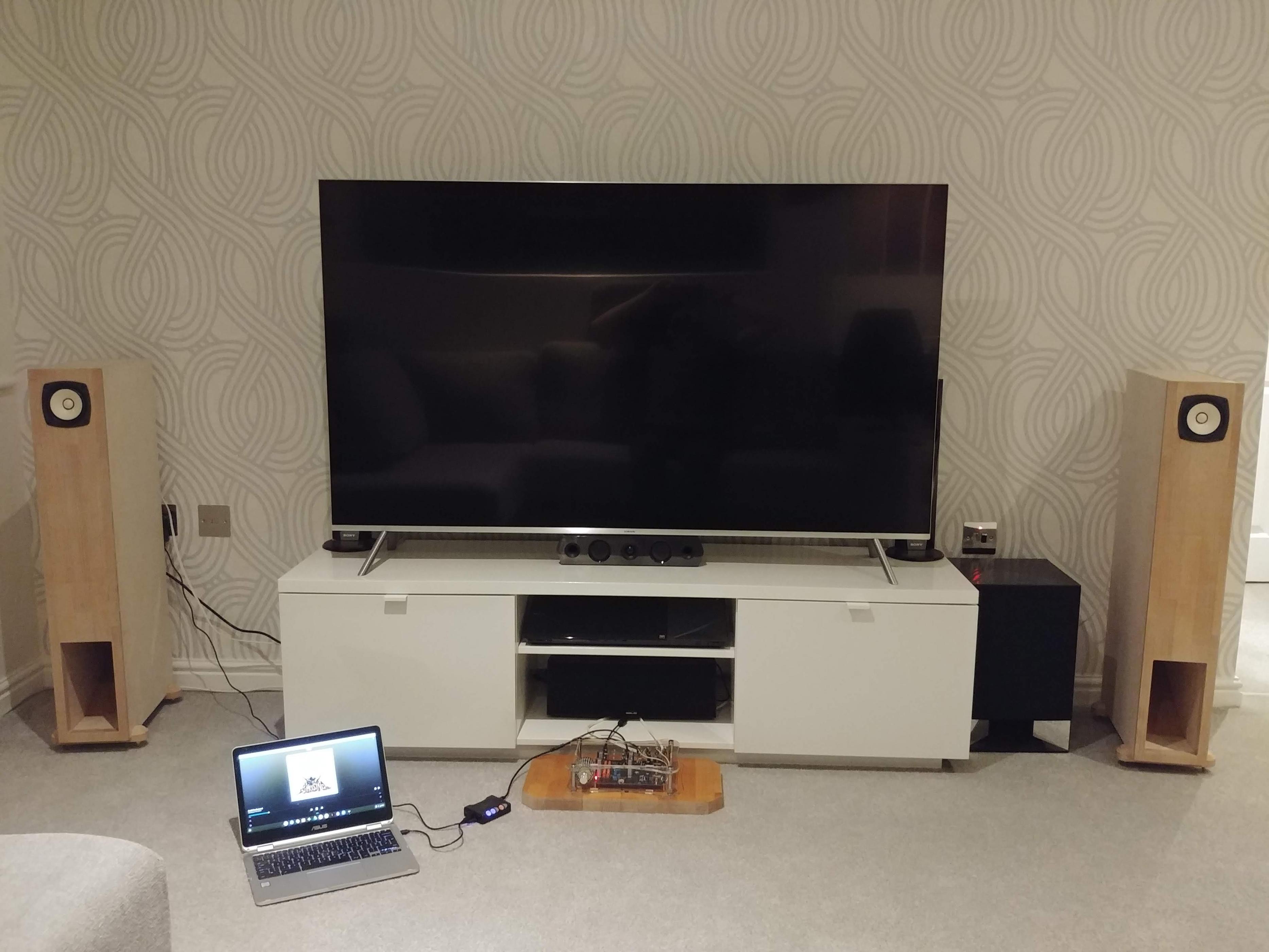

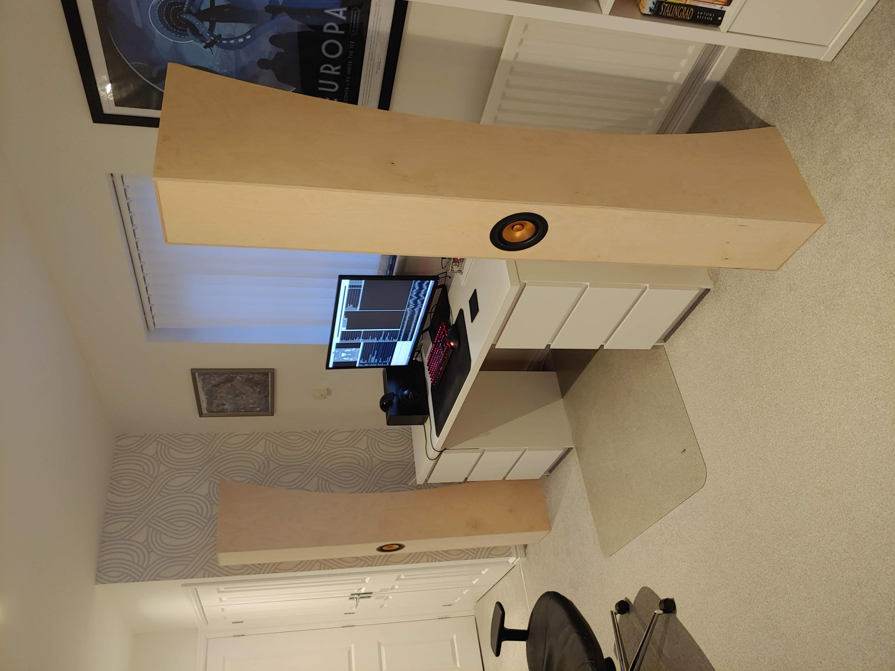

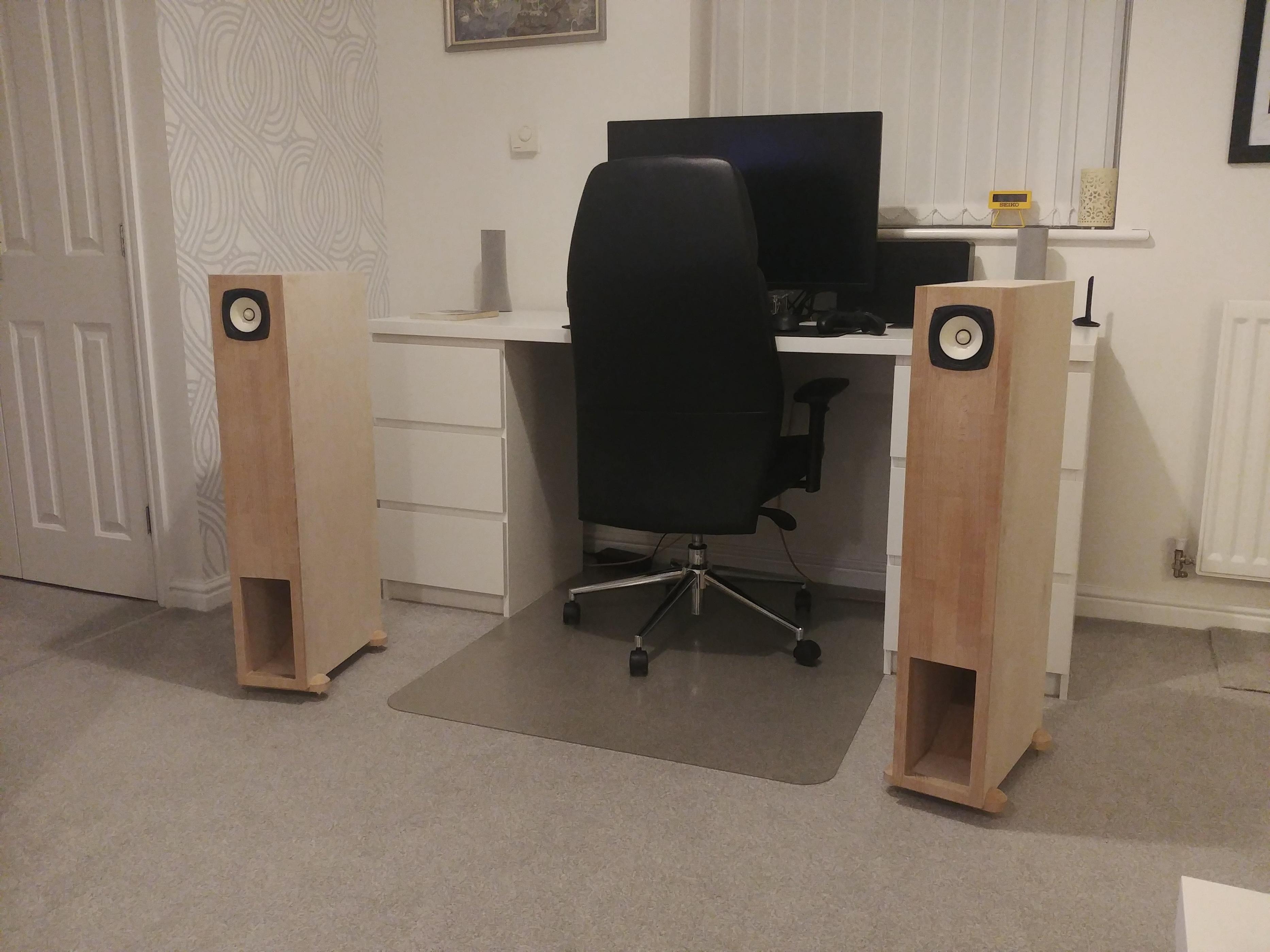

Thanks Scott, you were right about the room being the cause of the LF dips and humps. I moved them to a different wall and the response changed completely, been having fun tinkering with them trying to dial in the sound, but still seems like plenty to learn!
After a week or so of testing, tweaking the stuffing and placement I'm now pretty happy with the results, and on the right track they really are spectacular. I had been running in the drivers mounted to just a flat panel which sounded plain horrible, but once in the cabinet they were transformed. Nice and clean, plenty of bass (for me) and amazing stereo image and seperation. They do struggle when things get busy but I'm certainly not complaining since they are designed for 'small piece acoustic' music. Despite their limitations it really is amazing how much performance Scott has managed to squeeze from such a tiny driver, and I'm excited to have a crack at one of the larger models 😀

I agree with your listening observations, great imaging and separation. Great with vocals and acoustic instruments. I find the treble a bit dry and the sweet spot narrow. The published response graph shows a flat on axis response. The MA Pluvia 7 in contrast have a rising response up top but not overly so, therefore they are better for off axis listening and less fussy with listening position. The Fostex's mid-range is its strong point.
