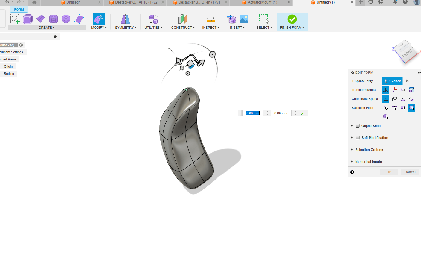

I have only enough experience to give you a couple tidbits.
I have been quite underwhelmed with the performance of any Visaton driver. That satori will blow the visaton away. Also, go with large woofers in a 3 way. I just finished a 8"/5"/Planar T build and realized I would have been better off with a larger woofer because you can cross an 8" all the way up to around 900-1000hz. If you're crossing around 300-400 then might as well go bigger to get more extension.
I have experience 3d printing enclosure as this is how I did it before getting into more multi way stuff.
Use PETG Filament. It has the least "ring" of any of the filaments I tried. Sticking some butyl rubber on the outside and inside of your mid enclosure will lower the frequency of the filament even lower. What you want is the ring to be in a frequency that is lower than your crossover. If you have the space, do not make it a cone or a cylinder. I found some research papers on mid enclosures after the fact and found out that the best thing to use is a wierd shape like a floppy goatskin wine bag. This screws up the back wave frequencies which is what you want. See attached picture (hard to explain in words).

If the mid enclosure should be deformed as such, would it make sense to just melt it with a heat gun and do some bending?

I understand your rationale. It a makes sense to me. Return the Visatons. Go with the Satori, you'll be happy you did when it's all said and done.
Do you use REW to take measurements? If so, you can see where the drivers begin to distort and base your XO points on that to limit distortion.
Almost forgot, make that mid enclosure at least 4mm thick. The thicker it is, the less it will ring. At this thickness you won't be able to melt the shape. You're printing it anyways so just let the gcode do the work. If you find organic modeling like that out of your skill set I can do it for you. I make aerodynamic parts as my side business so I make those types of shapes a lot in CAD and so it's quite easy for me. It was not easy to learn.

@Bmsluite I might take you up on that offer to design the mid enclosure.
