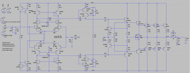

At the moment, I am an electronic engineer student, and I just finished my 3rd semester. So, there are still a lot of things that I don’t really understand, hence this post.
I want to design my own power amplifier. It is a pretty good exercise and there is something special about have a setup that I have designed.
So, the amp. The transistors I am using is chosen only be course I have access to them at the university. If this works in the real world, then I will redesign the amp and source some better transistors.
I really like the idea about a symmetrical amp, intuitively it seems right to me that the amp has the same capabilities for rising and falling edges. About the cascodes, I have just learnt about them, and well… it also seems right to me, to use a topology that reduces distortion. The output stage is simply stolen from Hawksford
So… I am hoping that someone will tell me if there is something really stupid in the design. Or give some pointers towards improvements. Before I build a prototype.

Cascode bias diode D1 makes me uncomfortable.
If there exists any ripple, noise, or output-current-related voltage modulation on the positive supply rail, diode D1 puts that noise on the base of the cascode transistors. I would much, MUCH prefer to reference the cascode base nodes to either (a) signal ground; or (b) tail node of differential input pair.
Ummmm.... doesn't work other than in simulation, this is the already famous ill defined VAS current. Do yourself a favour before spending money on an implementation and calculate the Q14/Q15 collector current.

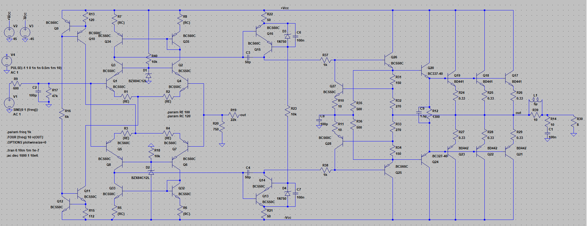

Hey.
The one piece of advice I have never listened to, or enjoyed receiving, was to start simple. In all my hobbies and endeavours the thing that interested me was often the more complicated and difficult route. And in all cases I had read about the exploits of others who were already doing it and they made it look so simple that surely I could start straight away in the deep end and avoid the boring journey to get there. I eventually failed to achieve the results I expected, didn't enjoy it very much, got frustrated and moved on. Now, only in my later years have I been able to design and build some nice amplifiers whilst also enjoying the journey. But I'm wise enough not to give advice that will fall on deaf ears 😀

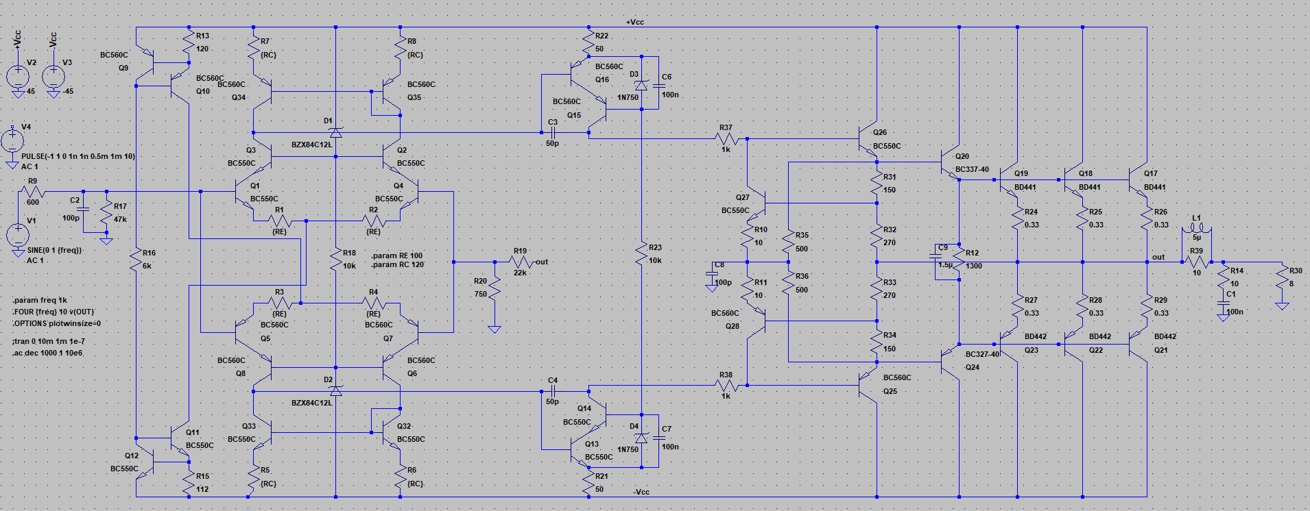

need the same fix for D2
mlloyd1
This is just embarrassing... and thanks 🙂
Well that is certainly a good point 😀 So I am back to the drawing board, either cutting away the symmetrical par of the amp, or designing another VAS.

Going right away into details, which is the wrong way to go in early design.....:
The Zobel circuit is on the wrong side of the inductor.

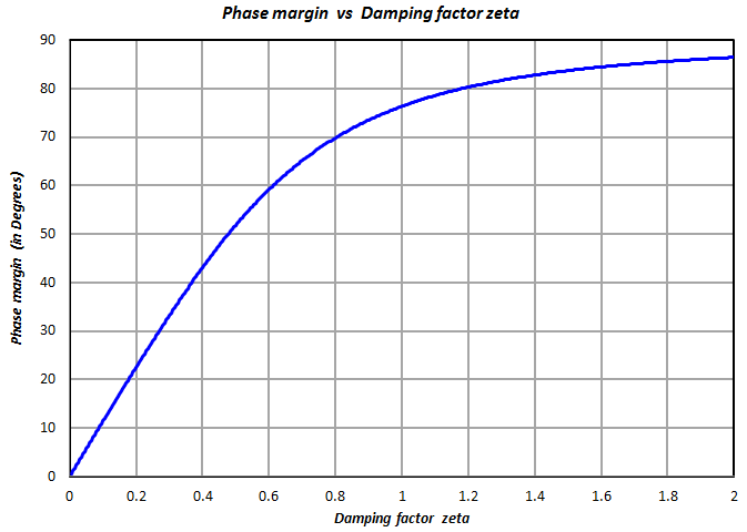

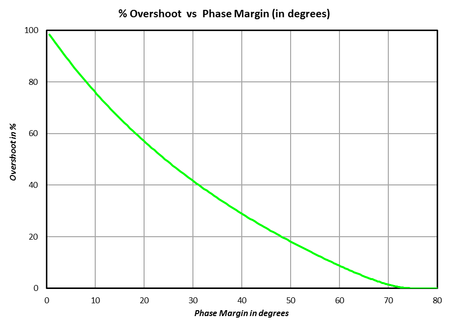

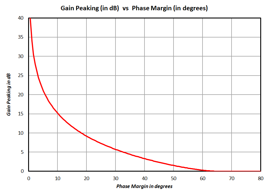

I've attached a pdf below, which discusses phase margin and other characteristics of second order linear systems (which are good approximations of power amplifiers & voltage regulators).I would aim at Phase margin 30° and gain margin 20dB.
My own personal preference to design circuits with phase margin of 65 degrees or more. This reduces overshoot to an acceptably low level, and keeps gain peaking modest.
