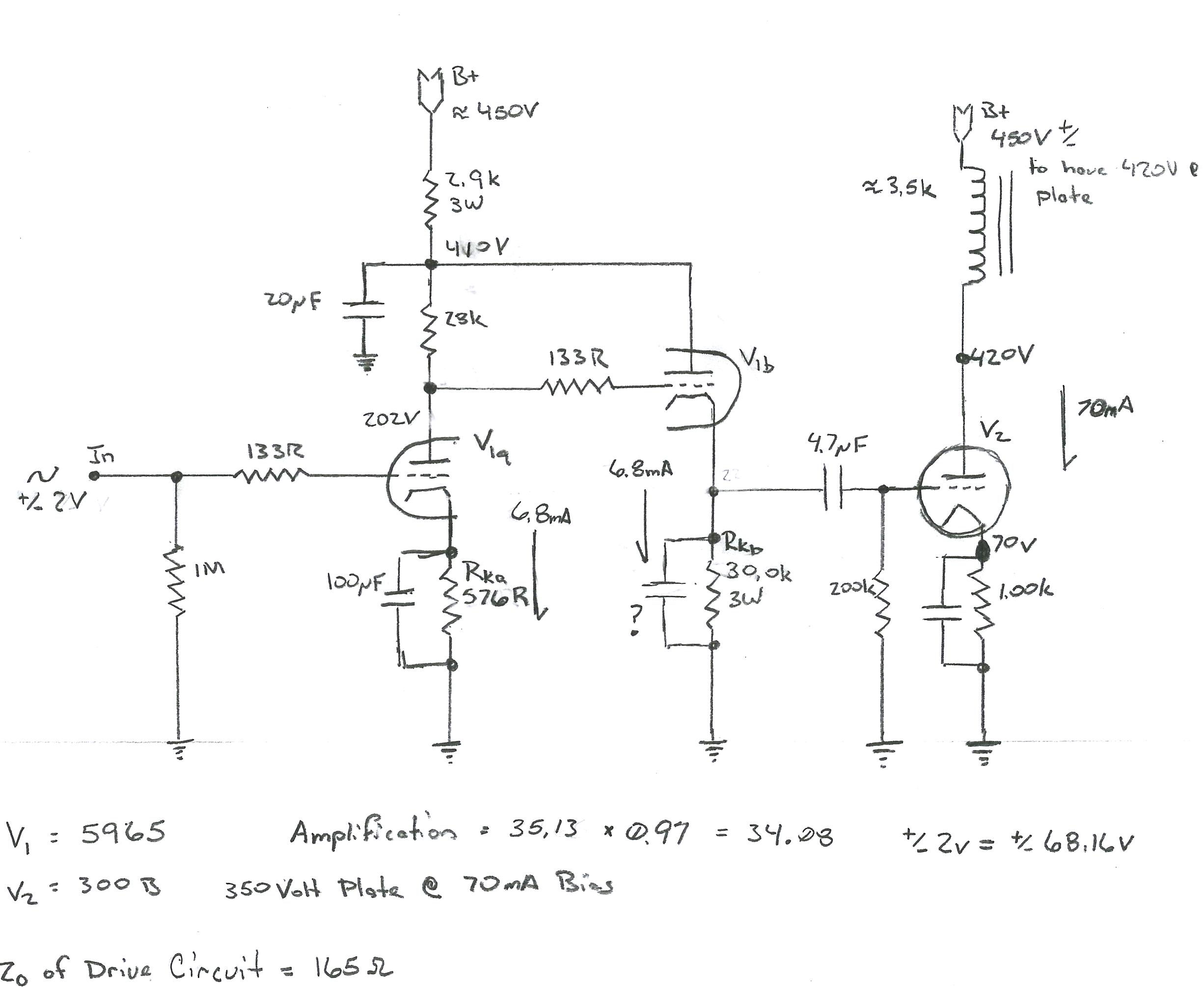

I have wanted a 300b SET for a long time. After considering many different driver ideas, I came up with the following KISS design. I am a newbie at tubes and I won't take claim for any creativity or being too original. I enjoyed the sound of the 12b4 preamp so much I figured if I could get a grounded cathode driver to swing close to 70V with a 2V input I should try it. I thought about using a CCS for the cathode resistor but held back for the first effort. Maybe try it later.
For this circuit B+ is 500V using a 3k primary with the bias set to 80mA on the 300b. The driver is a 5965 with the triode paralleled. This is decoupled from the output stage by a dropping resistor of 3k bypassed to ground with a 20uF GQ cap. The resulting voltage across the drive circuit is 450V. Ra = 14k resulting in a plate voltage of 222V at idle. With a 2V input it will swing 68V at an Zo of 3k. The bias of the driver is 16mA across the plates using a bypassed 270R resistor. Any thoughts or comments for an improvement in this design. Better yet will it work????
P.S. Filaments are regulated DC. Forgive the hand drawn schematic, I don't have any fancy software to do it yet.

Redeign using CF
Although I have not put this in PSpice, I thought it worthwhile, based on comments, to redesgn the driver with a CF using the 5965 tube. In this case I split the triode, one for gain and one for buffer. This drops the Zo of the driver to 165ohm. Total gain of the amplifier is 34.08 which is still within my goal. I am not opposed to other tubes or using two tubes for the circuit. I just have a few of the 5965 laying around.
I also dropped 300b current to 70mA at 350V plate. This reduced bias voltage to 70v. At full input now the driver has to get closer to 0 volts on the 300b grid. At that point I am not sure if there is enough current flowing through the CF to drive the 300b properly. At this time I still want to avoid A2 operation.
The other question I have with a CF do you or do you not want to bypass the cathode (Rkb) resistor?
If you want to stay within Class A1 why don't you use the recommended operating conditions by WE?
For example: 400V/60mA, bias -87V. If you choose a 5Kohm : 8ohm transformer you will get 8.3W (a little less in practice because of the transformer loss) with 3% 2nd harmonic, 0.5% 3rd harmonic and much less for higher harmonics. That's 3.05% THD approx.
If the load of your speaker drops to 5.6 ohm the primary load will be 3.5K and you will get for the same input (174 V peak-to-peak) 10.5 W with 5% 2nd harmonic, 1.2% 3rd harmonic etc. (approx. 5.2% THD).
Practically you could use any nominal 8 ohm speaker.
If the driver is a triode that can swing 61.5 Vrms with dominant 2nd harmonic you could get lower overall THD in a wide frequency band because of harmonic cancellation.
That resistor should not be bypassed. Your 20uF power supply cap presents a zero impedance to AC at the plate. If you installed the bypass capacitor, you would also have a zero impedance to AC at the cathode. Both plate and cathode are now shorted to circuit common. No more signal.
My sense is that putting a 300B in this sort of topology is a little like cramming a Porsche engine in a Pinto. There is a lot you can do to improve things -- CCS plate and cathode loads, LED bias, Power Drive, Ultra-Path cap, Shunt regulators, DRD, etc. -- and without some of that you won't reap the benefit of an expensive DHT. Might still sound better than a KT88 or whatnot, but it won't sound as good as it can.
Further, the filament supply and the power supply are probably more critical here than things like whether you use a cathode follower or not, and they should not be after thoughts.
Finally, 4.7u is a little large for the coupling cap. 0.22u, or even 0.1u, would be fine with the 200K resistor.

I can understand wanting to build an amplifier that is sand free. However if you are going to use a cathode follower you are basically back to the Tubelab SE topology. I would argue that the FET follower would do a better job than the tube. Additionally you could go back to your first schematic and use an active FET load and take the signal from the Mu output to get an equally low output impedance as the follower.
I am also wondering why you want to avoid A2 but don't use recommended points? At 350vp you should be around 50mA to 60mA @ -76 to -74 with that load. Of course this can vary per tube, but the recommended points are usually a good place to start.
Additionally you could try transformer coupled with fixed bias. It would cost a bit more, but it is an elegant solution to lose everything in the signal but a couple resistors, a couple transformers, and the tubes of course. You could also look to try a tube with lots of balls so that it can drive the output if/when it starts to pull grid current without the follower, something like the 6BQ5, D3a, or 12HG7. I posted an idea a-la Gary Pimm using the 6BQ5 CCS loaded, however you wouldn't need to CCS load it, simple resistors would also work. Take special note in Pimm's test of the 90V out @ .25% distortion figure. This type of circuit could, and would, drive the living snot out of the 300B at any of the 350vp operating points.
As mentioned above, DRD could be an excellent option for avoiding sand. With DRD you are back to two stage instead of three....two with a follower; and you would lose almost all of the junk in between.

I think it is important to understand what the aim is. This amp is to be my building block of understanding for the nuances of tube audio. Start with KISS (Keep It Simple Scott) and build complexity refinements in later once I understand what is going on. I will have two designs to immediatley compare it to. Tubelab Simple SE (not sure what tube yet) and a Tubelab SE which will be runnning 300b's as well. Hopefully at some point in the near future I can contribute to this community more than I suck away from it. Thank you very much for your help so far.
Thanks zigzagflux, I didn't think it should be bypassed but wasn't 100% sure. Your explination make perfect sense.
dsavitsk. Don't pick on Pinto's, they are cars of my era. (That and Disco). You are right, in its current design it won't be ultimate. Thats okay for today and will give me something to do tommorrow. Although not yet in good enough form to present yet, the P.S. and heater circuits will not be insignificant. I will probably use silicon in the heater circuits to obtain the goals. I'll post them shortly. And yes coupling cap is too large. For the present I will just put in 0.47uF until final output stage design is completed.
As far as the 300b operating point, my suggested operating points are based on being a newbie and using SE Cad. While I considered the recomended operating points by W.E. they were all less than 3.5k @ 350V plate to get any kind of power output.
Initially was trying to get power, then to balance power vs. THD. Maybe SECad isn't the tool I should use as it flags the 5.0k and 4.0k primaries as too high of an impedance. THD calculations do agree with above comments.

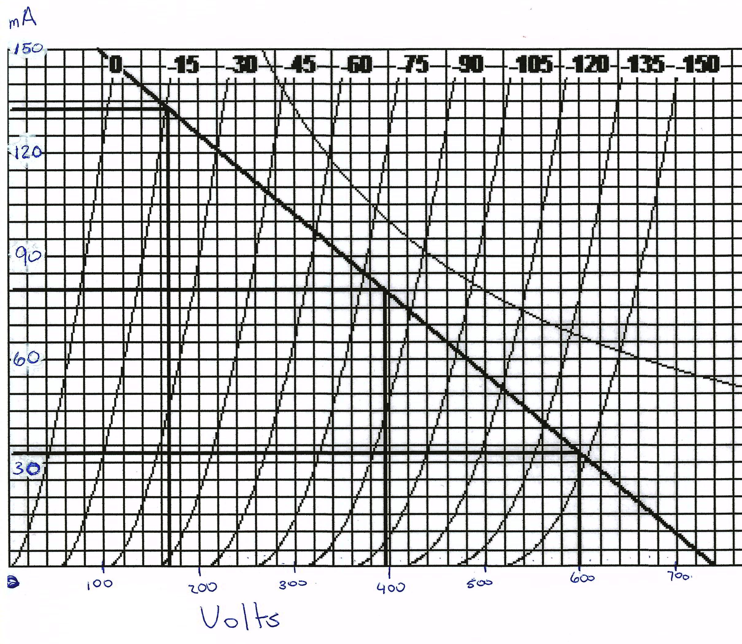

Attached is a load line curve were I bumped up Vplate to about 395v using a 4.0k primary. From my inexperienced perspective, this looks good. I am driving the tube to 80% of its max power, producing 10.1W with 2.5% 2nd and 0.3% 3rd order harmonics. Vin is +/-66 V. There is quite a bit of headroom before hitting A2. At the limit of A1 it is showing close to 15W with 3.3%2nd and .3%3rd. I know I must be missing something in this process so please help me. I probably will have the OPT made by Electraprint, so we can make it pretty much anything. This is an area where I want to get right so I am all ears.
From the picture, with +/-66V it looks like you get approx. 5.5W. Rather poor efficiency. You get 10W with +/- 82V input.
The original WE recommended loads for 350V/60mA are 4K, 3K, 2K. If you go for 4K you get 7W (THD is a bit more than 3%), if the load from your speaker drops at 6 or 4 ohms the primary impedances will be 3 and 2K respectively. The Pout for 2K is more than 10W. I don't think you can find more info for other tubes.

Thanks 45, Calculated by hand and your right 5.5W. I came up with 5.8W before transformer loss. Went back to SECad and found the I had not checked RMS out. I checked it and the results came back at 5.18W with the transformer I used.
Proves the danger of sims in that they are only as good as those who operate it. Unless you can determine what is reasonable, then something as simple as a check box will throw everything off.
I am now back to Standard operating points, designing for better A2 operation, and hand calculating.

P.S.
Don't worry about that 3% THD from the 45 it is practically 2nd harmonic only at 200V P-P into 4K!
The curves of the 45 and 300B are extremely similar in terms of linearity and very likely you get the best condition for perfect harmonic cancellation. That is, you get low overall THD from your amp if the input triode has very low distortion!
