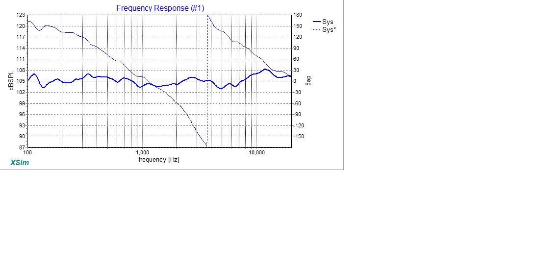

I've attached the frequency response which I'm fairly happy with, I don't particularly know how to read the impedence graph and what I should be looking for there, all I've done is try to keep the minimum above 4 Ohms so any pointers here would be great.

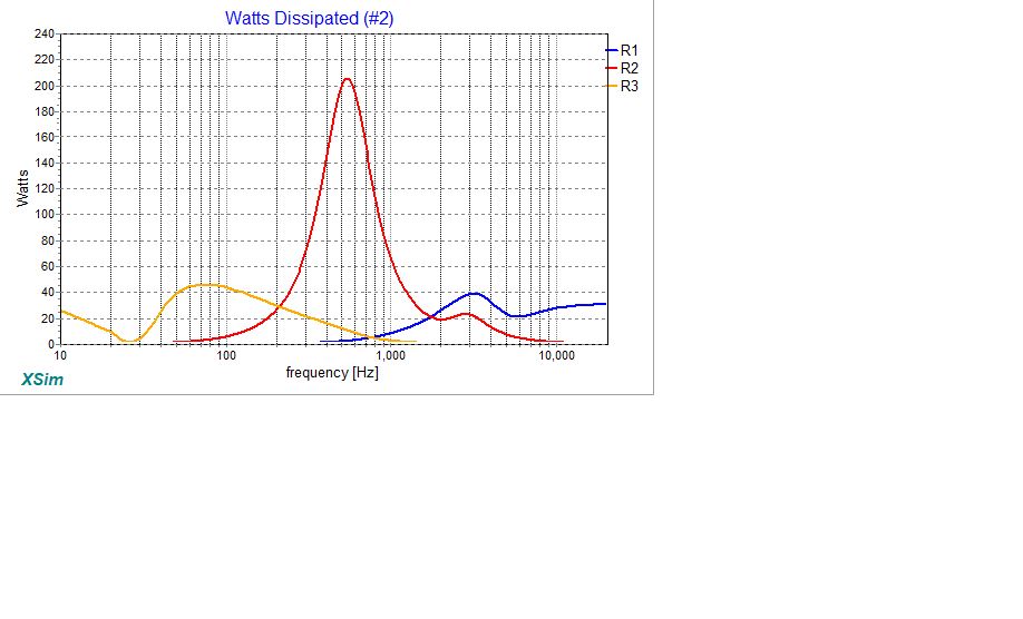

The main concern I have is the power dissipation graph which seems to indicate very high power through those resistors. Is there any way to resolve this?

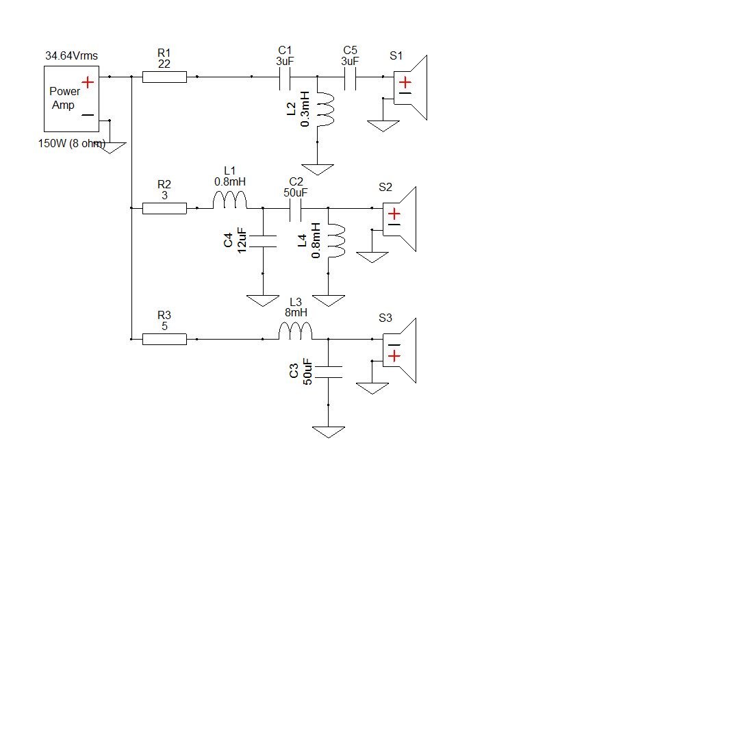

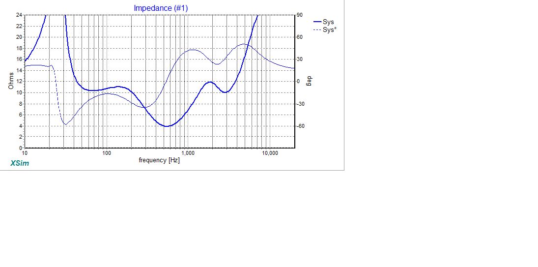

At a quick glance, I think L4 is a bit too small.
Why is there an R3? Is that something to simulate the amp output impedance?
I don't mess with ribbon tweeters, but I hear that you must be careful. In the sim, try a 6 ohm, and 6 ohm tweeter pad placed after the x-over. Adjust from there.
Reactions: Stanislav
R3 is complete non-sense. There has to be no resistor in series with the woofer. Remove it and start again.
I don't believe it's time to discourage you from a 3-way since there are so many other things to talk about first. I won't make a list, but as for what's in front of us...
You're not showing phase. Here's a thread on Xsim plot window setup.
Usually, but occasionally there can be. I'd remove it in this case though as all three have a resistor, and it is recommended to make one the base for sensitivity and adjust the other two.

What the others said:
1. remove R3
2. replace R1 & R2 with Lpads, after the xover, and before the driver
3. the reason to use Lpads instead of series resistors is the impedance that a particular section of the xover sees stays the same, with a series resistor you'll have to re-calculate the values of C's and L's
4. your woofer will define the overall sensitivity, use its sensitivity to calculate how many dBs to cut from the other drivers with the Lpads
5. as Allen above said, check phase, the normal practice is the woofer is connected with positive polarity, the other drivers can be either/or, the phase and freq. response will tell you which way to go. Your arrangement is also valid but needs to be verified.
6. cut the woofer at the Baffle Step, which means you need to know the size of your baffle.
and so on...

Regarding power dissipation, XSim probably considers a pure and constant sine wave with maximum power in each frequency.
The simulation is correct, but it's not what happens when you play music.
You can build your speaker to support this scenario, but it will be non sense and very expensive. No point at all.
You must consider some deratings:
1. Music doesn't have equal power in all frequencies. More power on low frequencies and less power on higher frequencies.
A 100W amp playing music will typically delivers let's say 80% to woofer, 15% to mid and 5% to tweeter - just an example - it varies a lot with music and how do you listen to it. As mentioned, some people use pink noise.
2. Music is dynamic, so you have to consider a kind of duty cycle proportion.
Example: 100W playing a single drum kick at maximum power, will have a duty cycle of let's say 20% (20% on and 80% off).
So the average power delivered to the woofer in this scenario will be just 20W. Same will apply to the resistors involved in the crossover.
That's why the tweeter, for example, is normally rated as "system power" and not exactly it's own average power.
A 5W tweeter (actual average power that can be dissapated) might be rated for a "system power" of 100W.
We can easily fry a tweeter if we apply a pure 10kHz tone with 100W to a loudspeaker rated for 100W.
But we can apply 100W in the woofer using let's say 80Hz and nothing happens.
This apply to all other components in the loudspeaker (speakers, resistors, inductors etc).

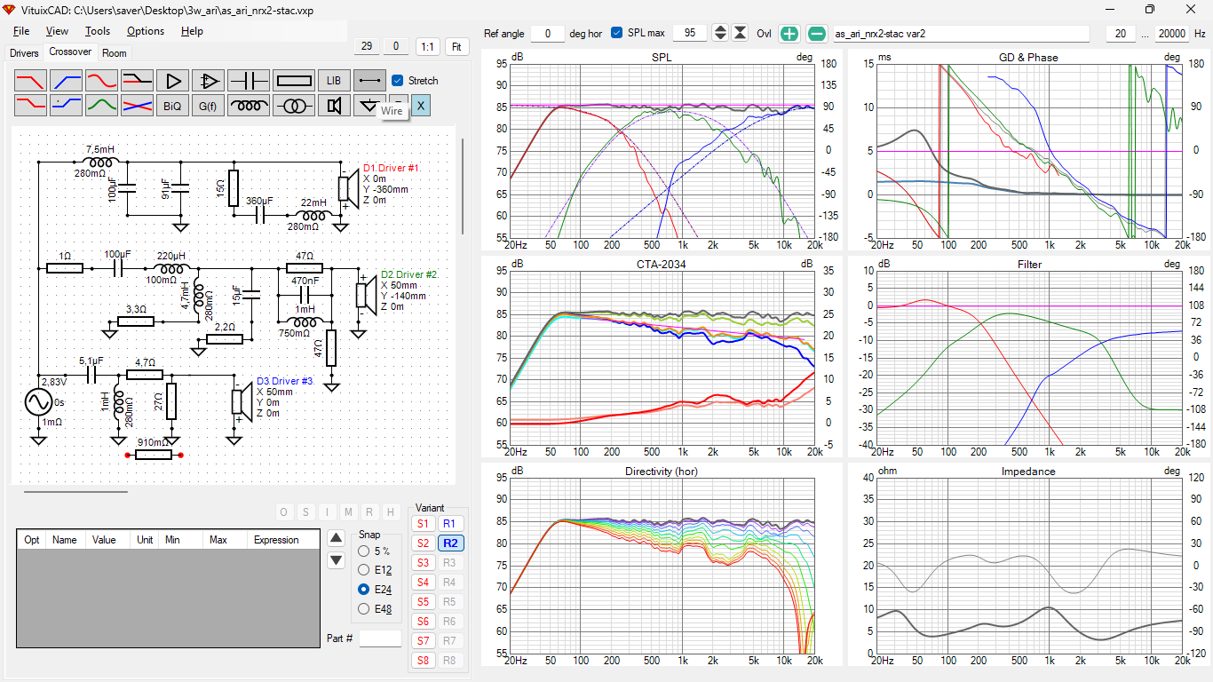

Coincidentally I was playing with the same woofer and midrange (tweeter is sb26stac). The baffle is 1100x300mm, woofer cabinet is 65L sealed full stuffed, mid cabinet is 4L full stuffed.

@shadowplay62 How did you get VituixCAD to display the three dashed target curves?
@ljettoo and @ByronInPortland The XO isn't that complicated, it is just laid out a little oddly. The woofer circuit is 2nd order with two caps to get the wanted value and a notch filter. The mid is also a 2nd order with a notch, and an LPAD split between the amplifier side and the driver side. The tweeter is very normal, a 2nd ordre and an LPad.
