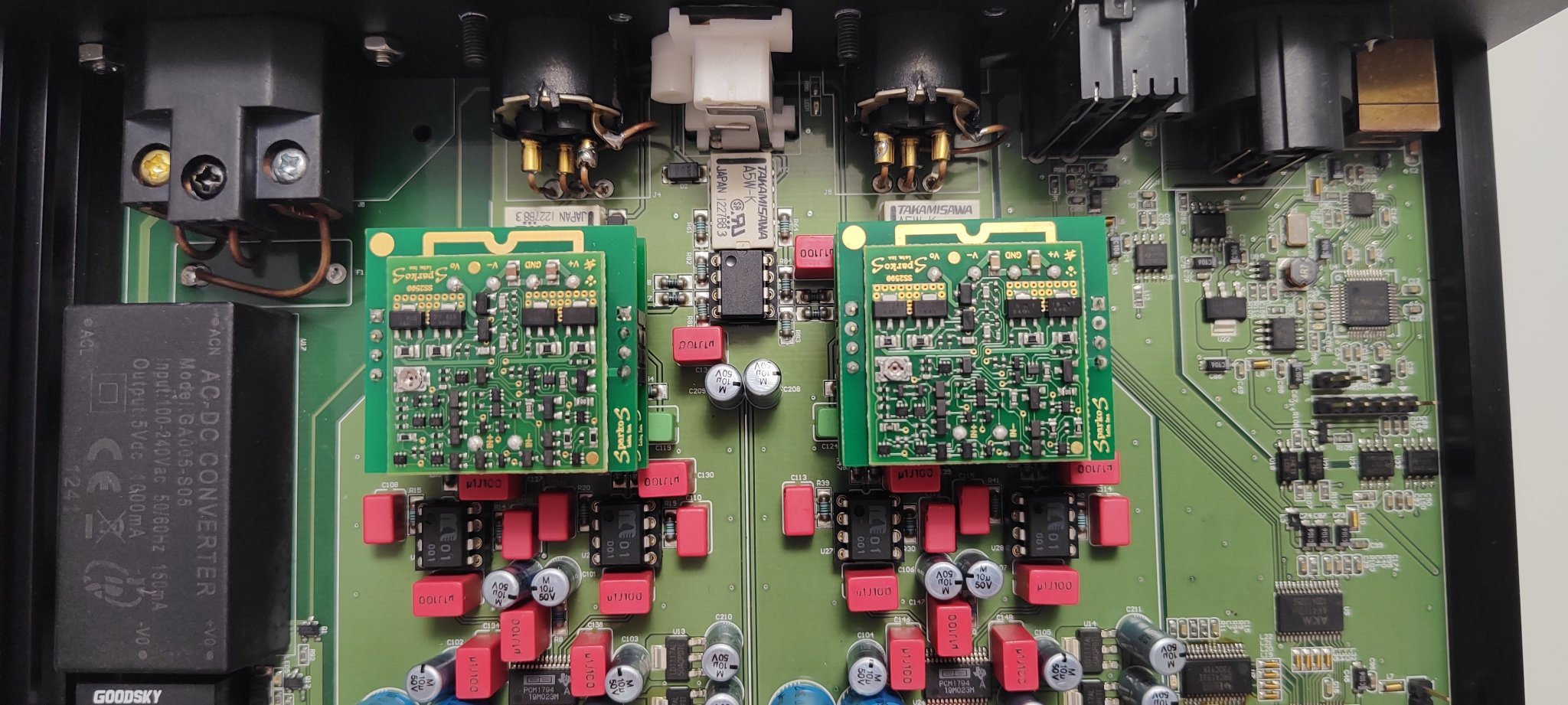

I'm a audiophile with very limited knowledge about electronics, but I want to improve this DAC further, it's my first DIYish project like this.
It started with me needing a DAC but not having thousands to spend after a system upgrade and other things.
Bought this thing, changed the standard opamps (all were opa2604) with opa1612 on LPF and Muses8920 on I/V and liked the sound, so I did more, every time was an improvement but now I've came to a stop, and I need help to go on. The purpose is to make a "better" (whatever that means for everyone) DAC (hopefully) than the Denafrips Pontus II with less sugar. Right now I'm at around 900E with it. I'm also curious how far can this DAC go, how good can it can be with mods.
I removed all the iron connectors, fuse delete, IEC (from VBS Audio) and XLR (Neutrik NC3MD-LX-B) replaced and also solid copper wire from VBS Audio where I could install it.
On the I/V stage I have Muses01 that's a bit muddy, although more audiophile sounding than the Muses8920 that's a bit cleaner but boring and has a smaller soundstage.
Those differences between the muses opas in the I/V were very easy to hear after installing Sparkos SS2590 on LPF, that I want to keep there. Sparkos made the scene holographic sounding and are very clean and revealing, with great separation and details. But sadly also a bit thin, a little flat and light in the bass region - would like to fix this.
The DAC uses 4x dual opamps for the I/V stage and 2 dual on LPF, also 1 for SE output but at least for now, I only care about the balanced output.
Other than trying other opamps like the opa1612 on the I/V stage (any other recommendations for a clean sound but also strong bass?) what more can I do to it? Change some caps? I also had a thought about making a external PSU for it, but I think it's very complicated and risky to make holes in the PCB to connect wires and such, so maybe improve the existing one somehow?

Maybe some photos with it will help.
You've taken out the OPA2604s which are JFET input opamps and substituted bipolar input discrete opamps. The loss of bass might be due to extra LF noise being introduced by this change. While Sparkos is open about the input stage voltage noise performance (1.5nV/rtHz) they're staying completely mum about the input stage current noise. The resistors around the LPF stage probably should be reduced to get better noise performance, they look to be MELF type and the values are likely 5k-10k which would be compatible with JFET opamps but less so with the BJT input stage of the Sparkos's.
From a look at the pics on the HeadFi thread, the relevant Rs on one channel look to be R42,R43,R51,R52. It shouldn't be too difficult to figure out those on the other channel as the components on the board are largely symmetrically placed. C116,C117 would also need increasing in value to preserve the filter time constants.

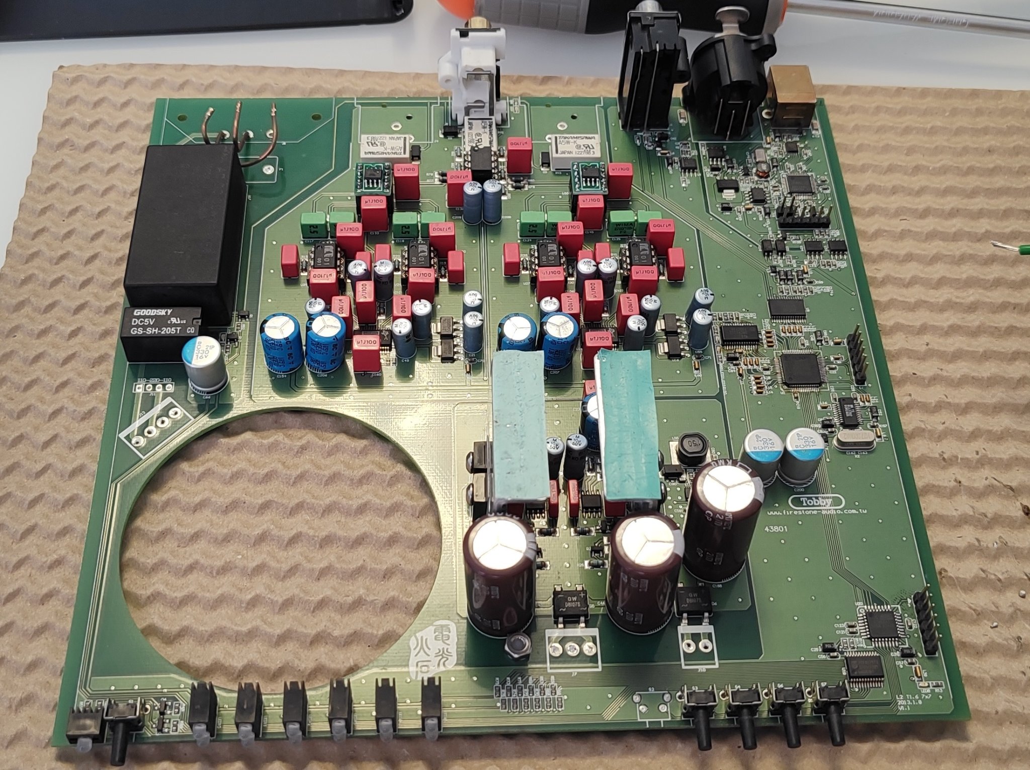

What would be a very good opamp in 2023 on the I/V stage for a PCM 1794? The opa1612 already has a few years. And do the modifications for Sparkos (on the LPF) should also be made on the I/V stage for let's say a opa1612 or recommended/similar?
Could the internal PSU be upgraded as well? Other capacitors, or something more complex?
At this point I'm asking for ideas (at least for inspiration) to show they guy I will go to with the DAC so he can modify it.
